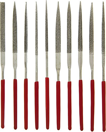

Great illustrations and writeup. I've done something similar to modify a knife with strong springs and half stops but I used a set of these small diamond files.
I have a set of 4 or 5 of those, they came with a set of 1/4 drives. They didn't fit right and I didn't want to put them to my grinder to make them fit. On the other hand I have a boat load of small files and stones so I used what I had on hand.
