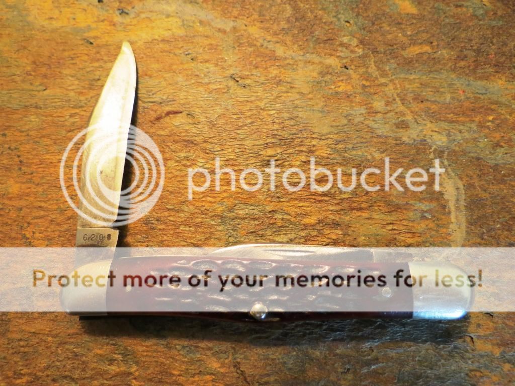

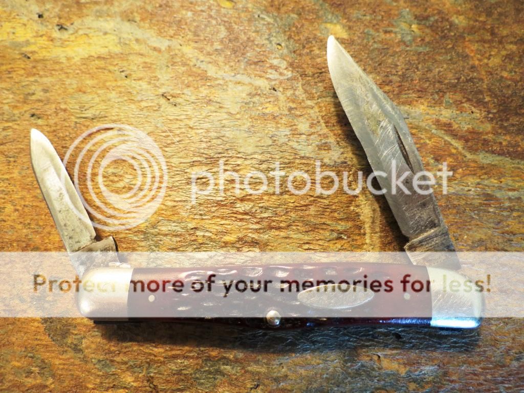

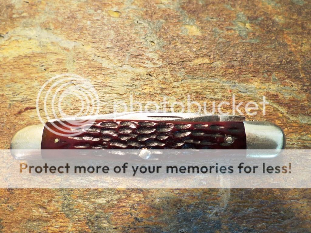

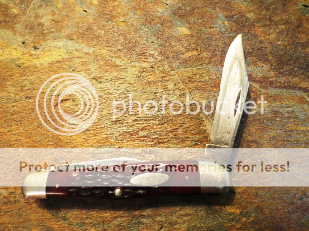

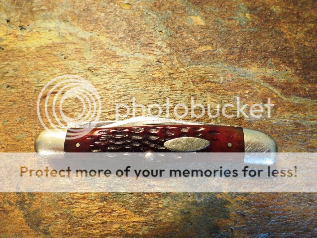

The one that really sticks out as my favorite is his old Case 5 dot 6208 Half Whittler. The knife has been sharpened many times and shows signs of years of pocket time.

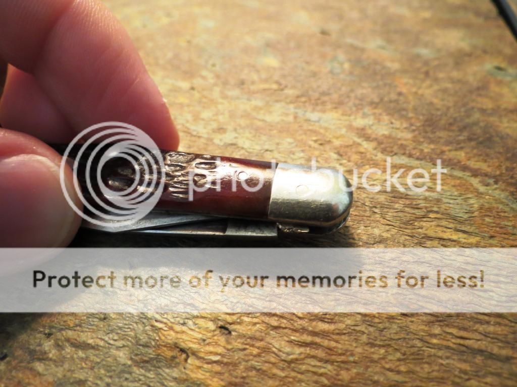

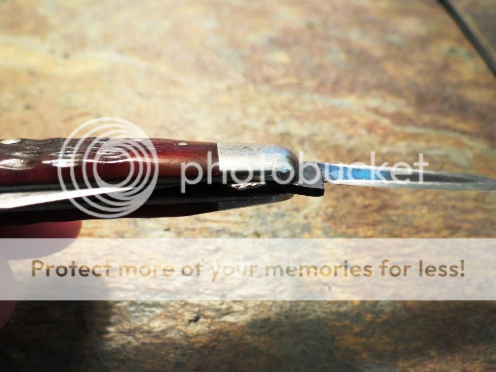

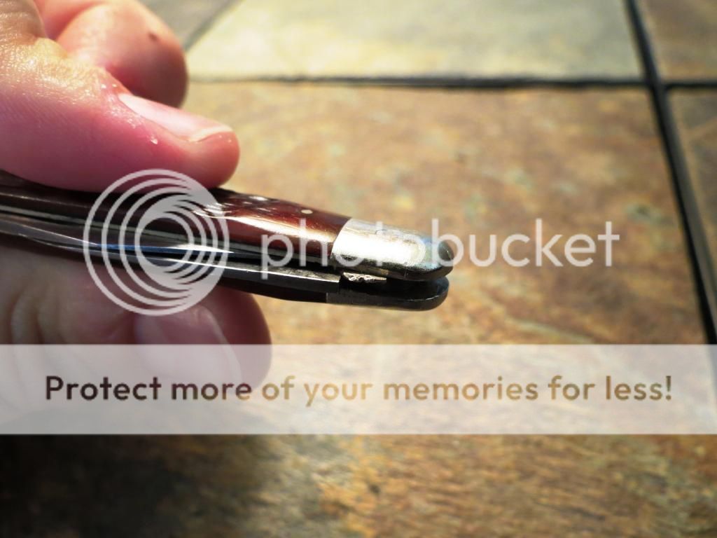

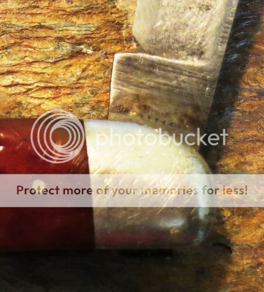

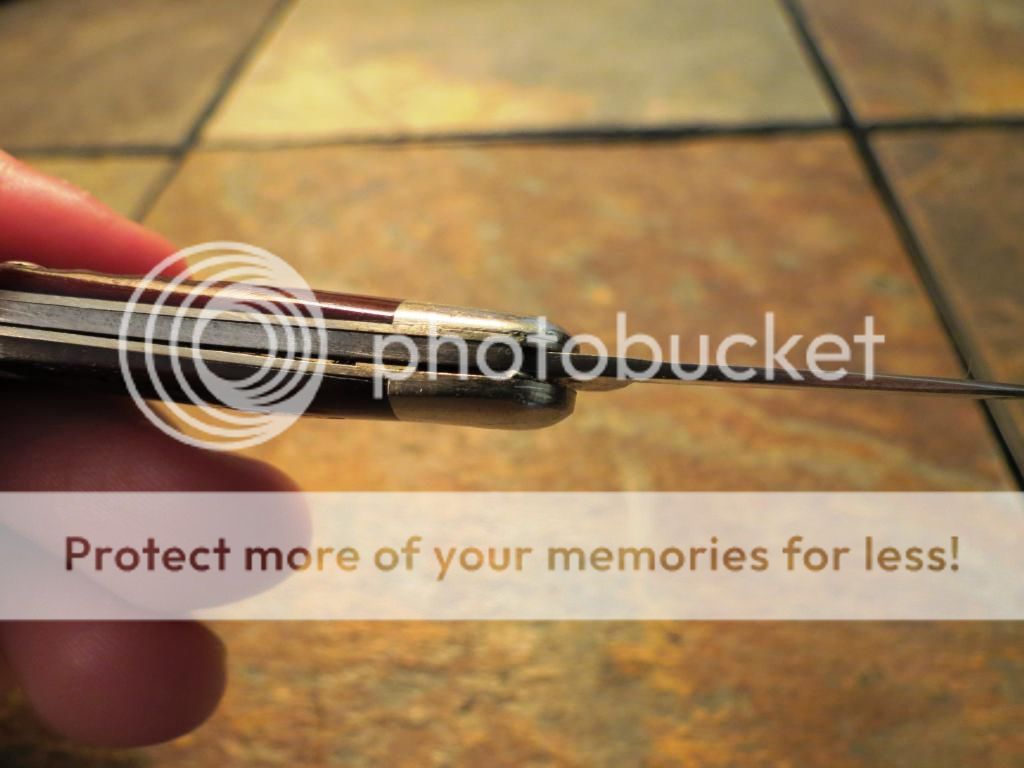

As you can see from the pictures, there is some type of metal wedged between the main blade and the liner. I cant quite tell if its part of the liner or an outside piece of metal that got wedged in there. Regardless, the knife opens and functions fairly well.
I'm torn whether I should send it off for repair or if I should just keep it as is. I do not carry the knife, but I do pull it out and play with it every once in a while.
Any insight or recommendations would be appreciated.

It looks like this was a full, 3 blade whittler at one time. On a full whittler there are 2 springs the main blade sits on, and the secondary blades each sit on a spring with a wedge-shaped liner in between. It looks like one blade and the liner was removed from this, leaving a single spring, which would make the main blade too wide for the spring. By adding the piece of metal (and it may be part of the original liner) it fills in the slot, allowing the blade to sit properly.
This was likely done to salvage the knife when one of the secondary blades broke. You could send it to Case and they might be able to repair it, or just leave it as is and have it remind you of your grandfather just as it is.
The 6208 is a two blade knife. It looks like someone put brass shims between the liner and blade to tighten the joint.

Interesting. If that is the case, then removing the shim and gently squeezing it in a vise (lined with some leather, or with plastic or wood jaws), followed by some gentle peening, should fix it. It looks like the pivot pin in sunken in, indicating that the joint is spreading. Seems like an easy fix.
That's a tough call. A knife that is in otherwise solid condition like that, I would not do much to. And this is coming from me, and I mod just about anything. It looks like the blades were a very tight fit, so a shim was inserted to give the blades room to nest.

Does anyone know if this knife is cv or ss? I'd like to get one just like it. I believe case used cv on this model through the 80s. So this being a 5 dot (1975... Correct) would make it cv. Looking at the blades I'd say it's ss...thoughts?

The knife has carbon steel blades.

I'm betting it's carbon steel, a.k.a. 'CV' before Case actually marked it as such (starting stamping 'CV' on blades in ~1990s or so). The blades look a lot like one of mine in Case's old carbon steel (~1965), and it doesn't seem to tarnish darkly like some others, but instead patinas to a nice even grey. You could test it by dabbing a tiny bit of white vinegar on the blade with a Q-tip; if it's carbon steel, it'll develop a darker spot within 5-10 minutes (can be cleaned up with a little metal polish; no worries). You'll see nothing change, if it's stainless.
The collecting guide* I refer to often doesn't even show the 6208 in stainless into the 1980s at least. All versions listed in the book (pre-1940 thru 1980s) are non-stainless. Also, since at least the 1970s, and possibly back into the '60s, I think all of Case's stainless knives were stamped as such, showing either 'SS' after the pattern name, or sometimes additionally stamped 'STAINLESS'.
