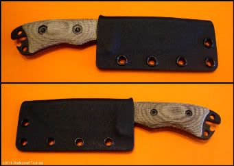

Fwiw: I make a Kydex sheath for a BK-11 that fit's into the LE ankle sheath that Ka-Bar sells for the TDI knives.
If you wanna go "deep" concealment. And I've also made alot of "simple" sheaths for guy's who just want Kydex covering the blade in their pockets.
Something like this:
It's shorter and thinner than what you typically see and the actual point where the center of balance isn't in-line with the tip of the BK-11. It's actually exactly where you see that eyelet in the picture for neck carry..... also, this will mount directly to a sm. Tek-Lok so you can even carry it "ranger" style under a shirt/jacket etc.
Eli
