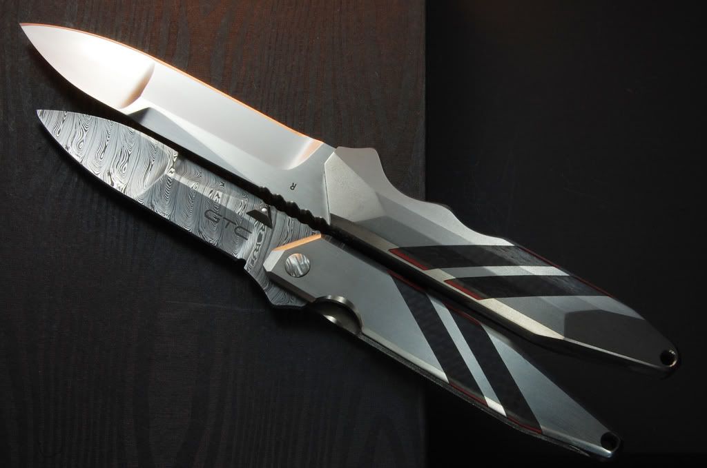

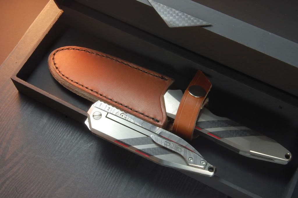

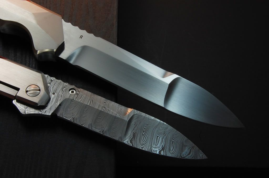

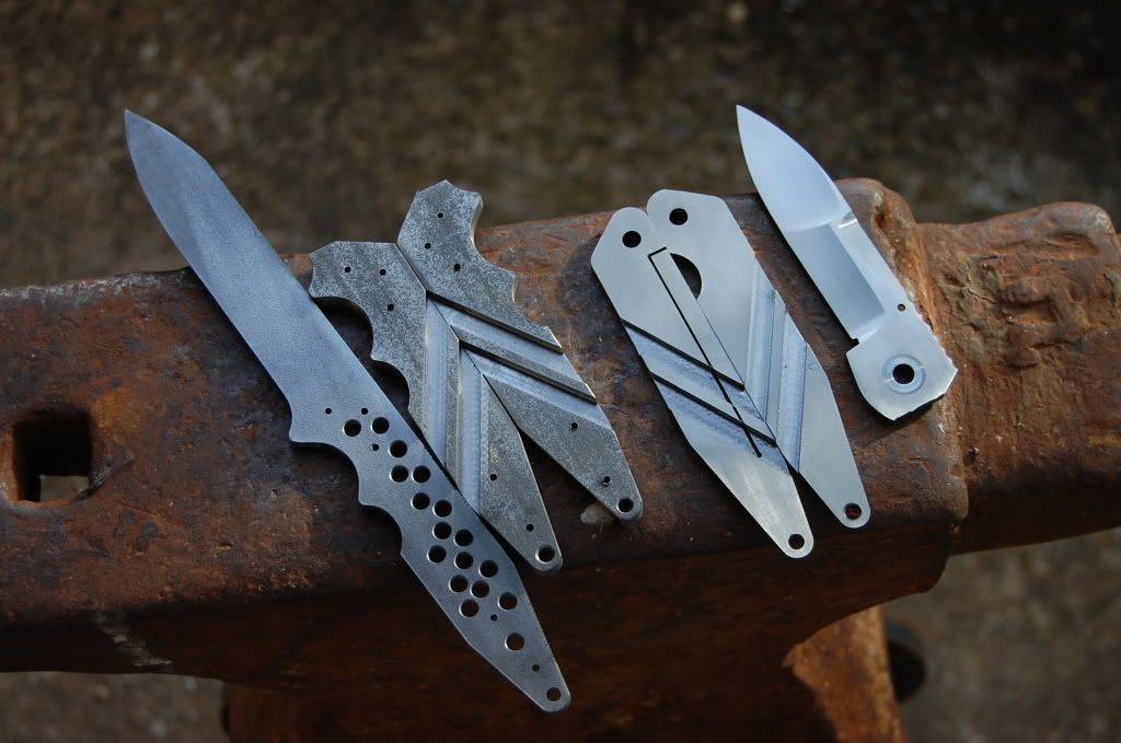

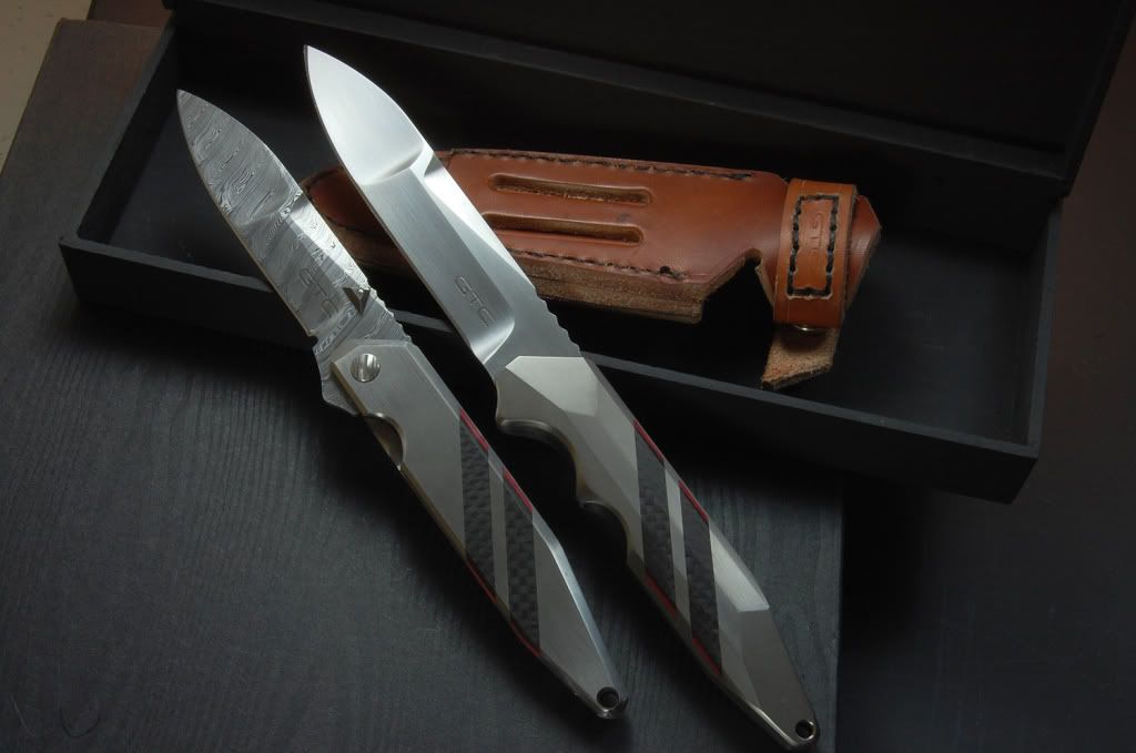

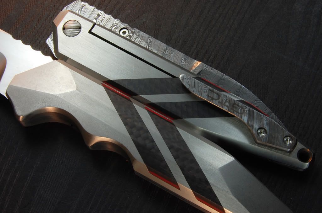

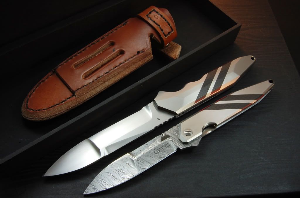

Finished this order today, a fixed/folder combo, Damasteel blade for the folder (Prisma), RWL34 for the fixed (1 inch bigger than the folder), Ti/CF for both handles. Hope you like them, Thanks for looking!

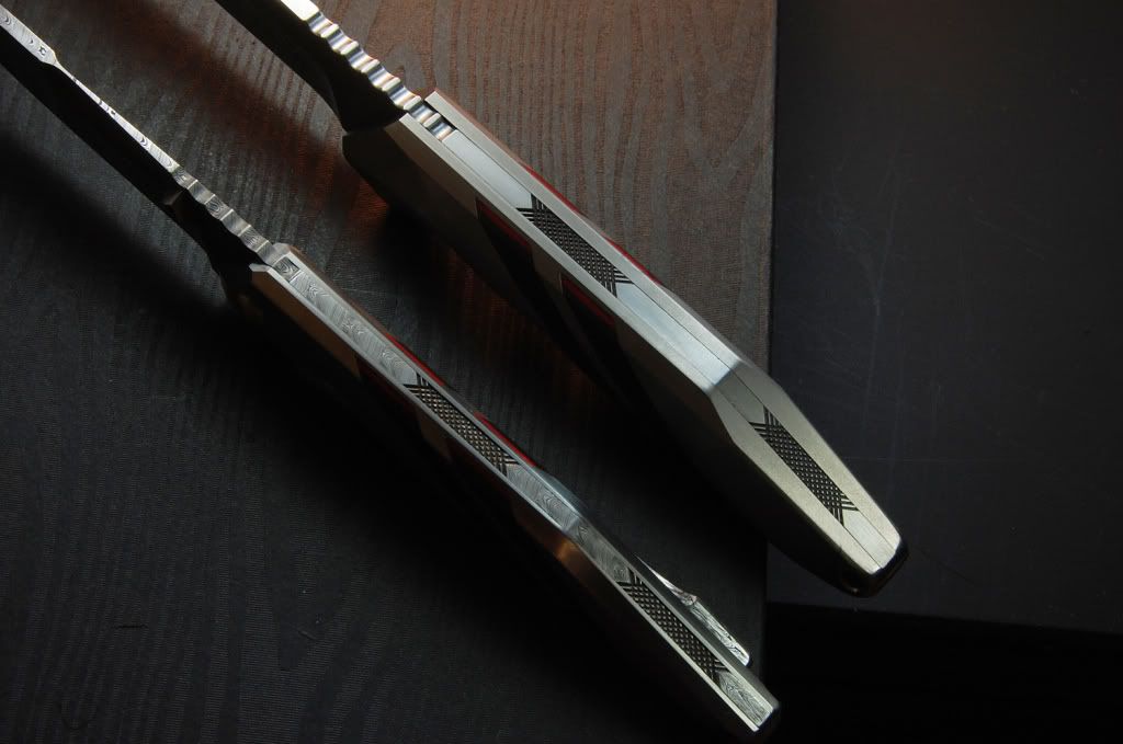

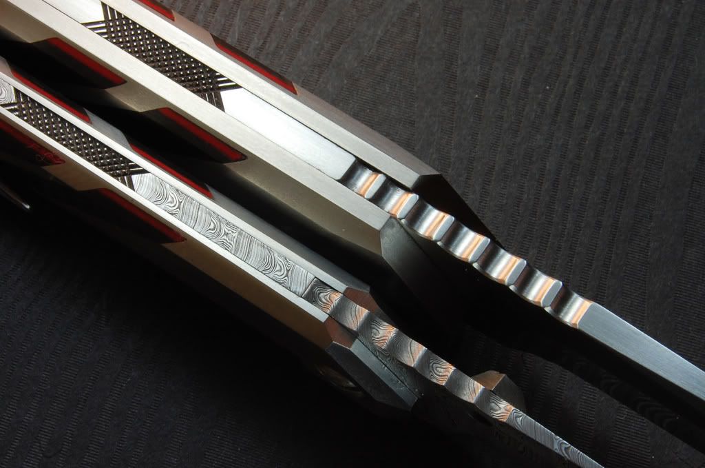

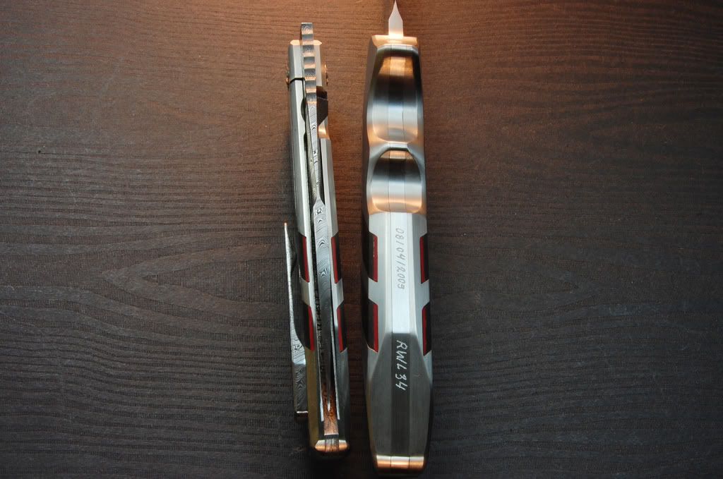

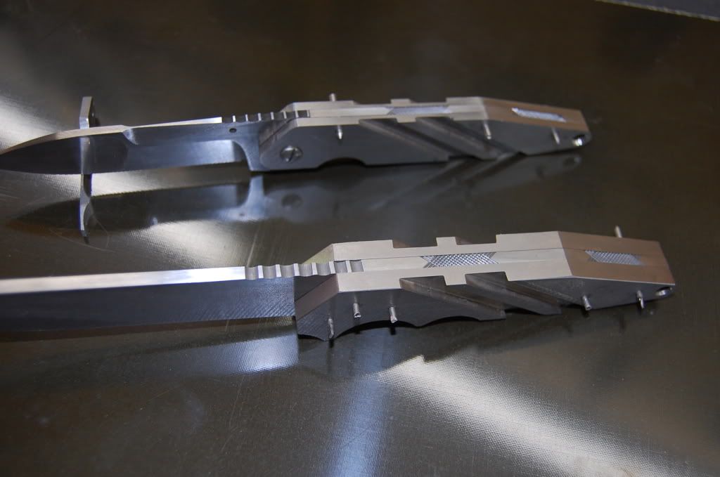

I've left 0.08mm between blade and frames, so this way it's hard to see which one is the fixed or folder:
