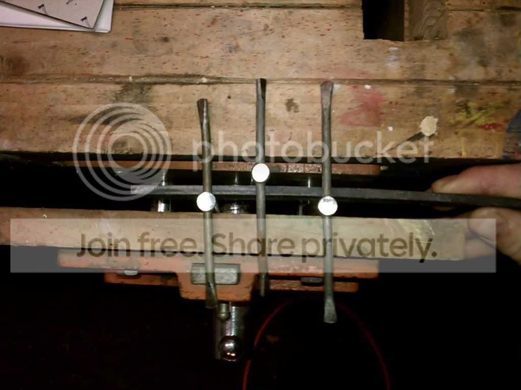

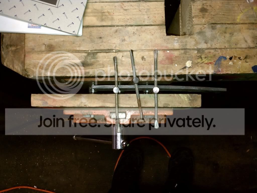

The first thing I would do is cut the bar to the length needed for the knife. Then I would use the 3 brass rod - vise fixture. Basically take 3 brass rods bent so they stay in the vise with it open. Place 2 rods on one jaw and one on the other. Put the single rod in the high spot and the 2 rods on either side on the opposite jaw. Close the vise and tighten. Repeat until the waves are gone. Works good on semi finished blades also.
I believe this is something to what AC Richards was referring too. If I'm not mistaken I got this idea from a friend to found it in a Wayne Goddard book.

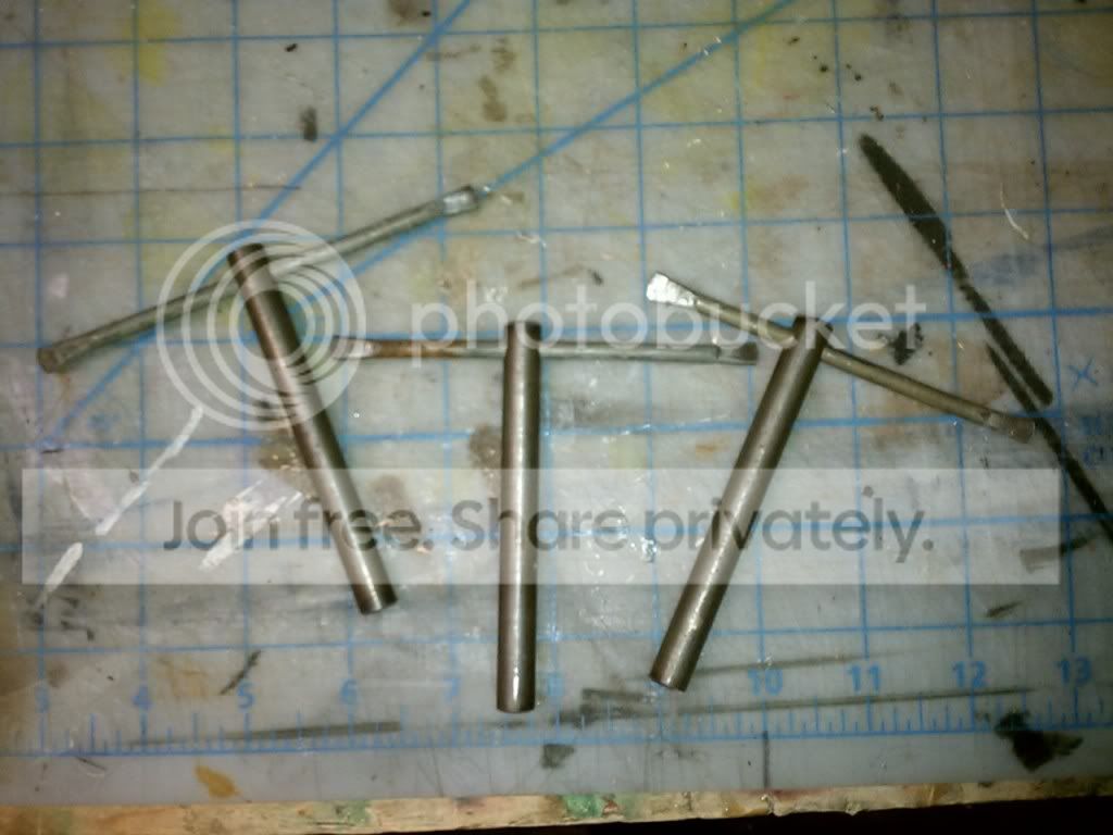

Cut bar stock into lengths, three or four inches (or whatever works best for you). drill a hole through each on one end, insert a small steel rod. It is best to hammer out the ends of the small rod so they don't end up coming out of the larger piece. Put this in your vise around the bend in the steel and apply pressure. Great for spot straightening.
I have almost the same thing. I keep it sitting in the vise when doing HT. If there is a warp that needs a tweak, I slip in the blade and give the vise handle a spin. Works superb.
