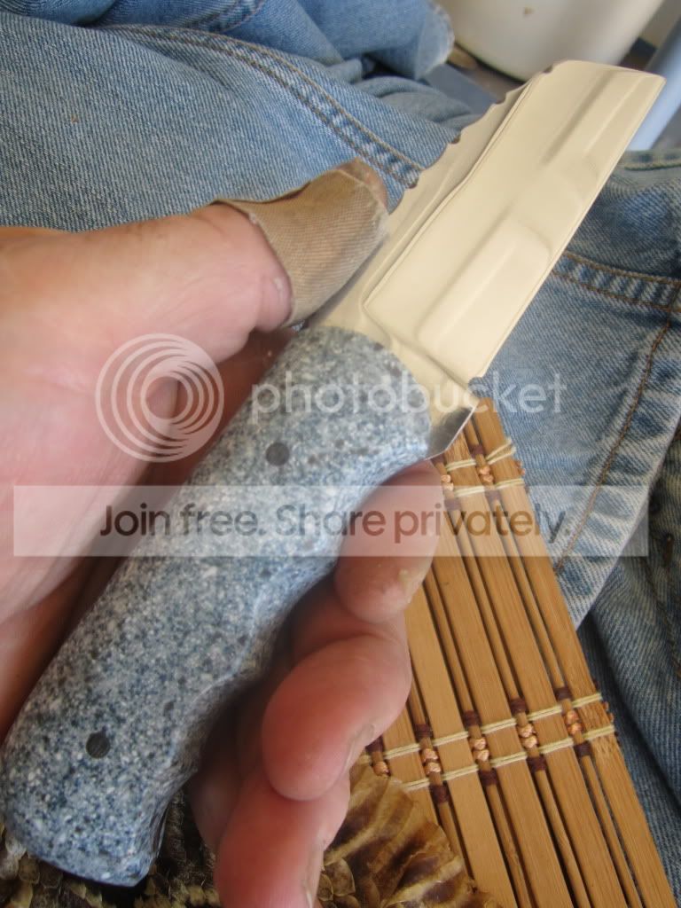

Head over and read glue wars. frankly, i don't think they will come off, depending on the handle material. shoot, richard J attached some stall mat scales with superglue, and they came off, after 17 years. I can replace scales every 17 years. If you have the ability, put pins on as well as epoxy. they are better together. I would suggest epoxy only as a last resort.
