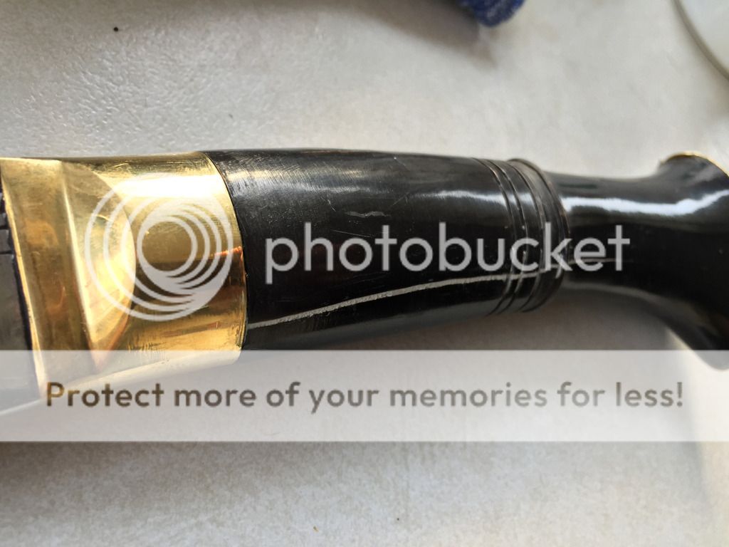

Anyway, onward, here is the crack as received

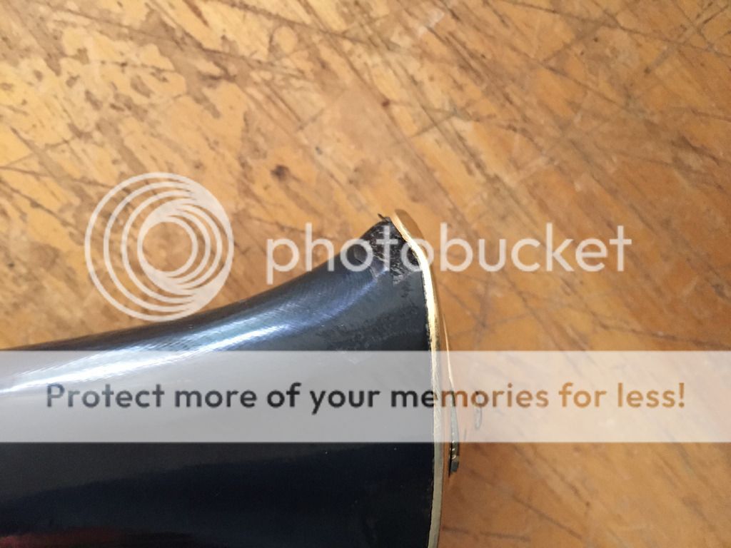

And another ding on the bottom of the handle. Hey, it all adds character!

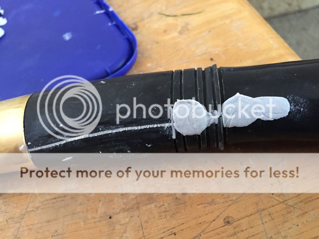

Anyway, i just mixed up my epoxy putty and forced it deeply into the crack..dont worry about using too much at this stage, Just clump it on there and use a small blade/toothpick or something similar to force it deeply into the crack;
Next, use a knife to shave off the excess epoxy (while its still soft)

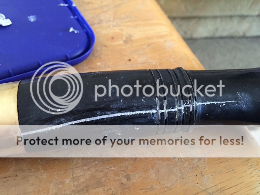

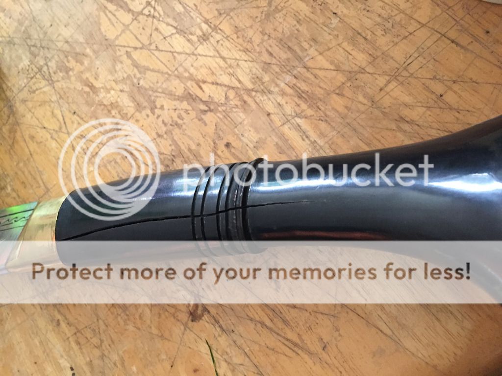

Then give it a bit of a wipe with a wet rag to wipe off the excess and set it aside to cure..this stuff cures to hard enough to sand, drill or file etc in about an hour
After this you can either repeat, and put another layer of epoxy on if you still hanv't filled it in properly, or you can sand it down smooth. If you didnt bother (like I did) to find an epoxy that somewhat matches in colour then you can paint the crack or colour it in with a marker or something if your so included..im not going to bother.
I also fixed the chip out of the bottom, but havnt really cleaned it up at all yet..
