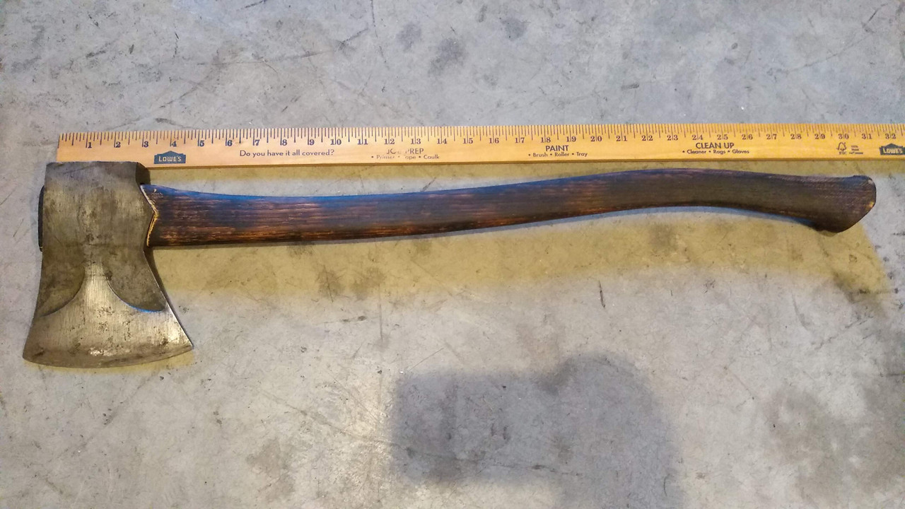

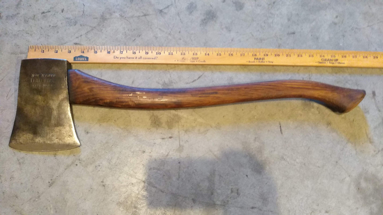

That's cool Grease I really like it. Would it be better/different if you sanded the varnish off first and then torched it? I wonder what the end results would be if not the same?
What kind of torch did you use to do this one?
We don't take kindly to flaming handles around here.
It's the first step of a shou sugi ban. If you were to flame the whole handle and wire brush it after you have a mild geographic finish. The early cambium burns off quicker than the late cambium. If you keep repeating the process of lightly charring and then wire brushing you can get a very very pronounced geographic finish. All the hard lines running the grain is the late wood and the recesses are the burned out early wood. Although it would probably be horrible for a tool handle.![]()
And Grease, it's nice to see you on the forum again. You haven't been as active lately as you used to be.
I was thinking about this the other day, traditional SSB is rubbed down with tung oil (or similar) afterward, if you reseal the handle over top of the Shou Sugi Ban finish without compromising the deep/complex patterning you'd be laughing. It'd have to be heavy durable enough to handle the workload, clear epoxy maybe?It's the first step of a shou sugi ban. If you were to flame the whole handle and wire brush it after you have a mild geographic finish. The early cambium burns off quicker than the late cambium. If you keep repeating the process of lightly charring and then wire brushing you can get a very very pronounced geographic finish. All the hard lines running the grain is the late wood and the recesses are the burned out early wood. Although it would probably be horrible for a tool handle.![]()
