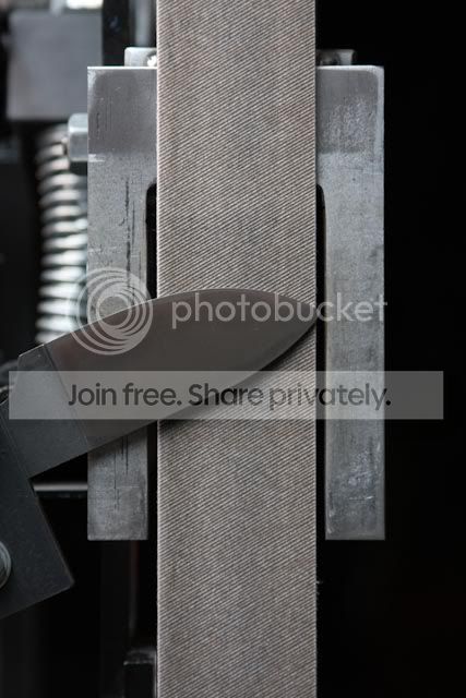

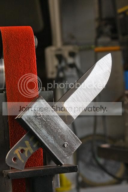

Anyway, I'm working on my 3rd grind. My first two were OK for a novice, but I wanted to do better. I know the tenant - practice, practice, practice, but frankly, I don't want to throw away any steel. My bevel grinds sucked - so I made a jig.
Here's my second try at a flat grind pre-jig.
Those pictures are actually better than it went.

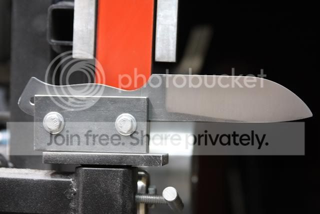

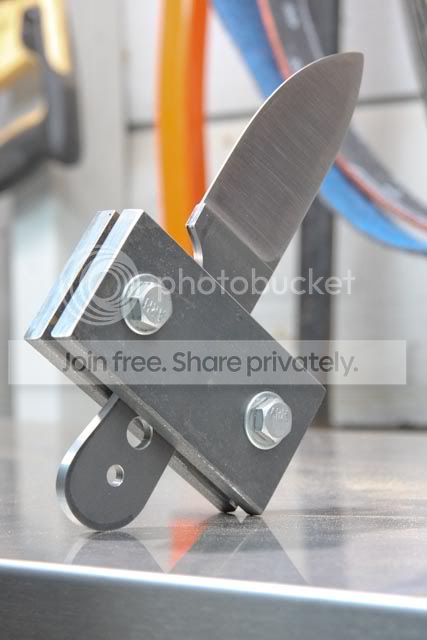

I researched this site for jig solutions and got some great ideas and saw some better results than I could achieve. I took their ideas and made this.
The bubble jig is awesome, the sled jigs are awesome and they probably get better results - I really don' know. I just want to inspire thought and share my limited experience. I am very happy with my plunge lines, however.

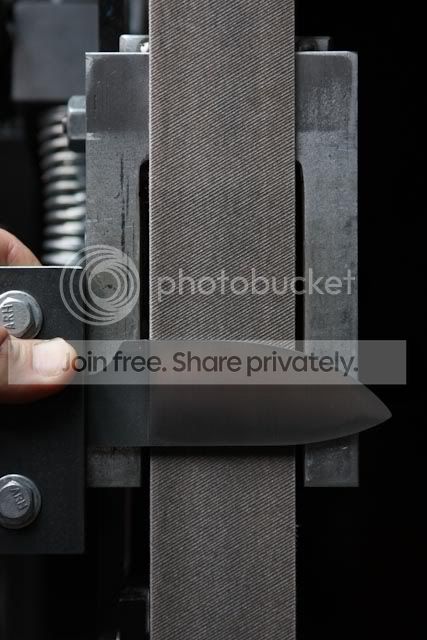

Here is my third knife using the jig but before the ceramic platen. I'm looking forward to using the glass platen on #4. I see the flaws, but it sucks less than #2!

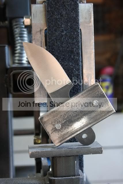

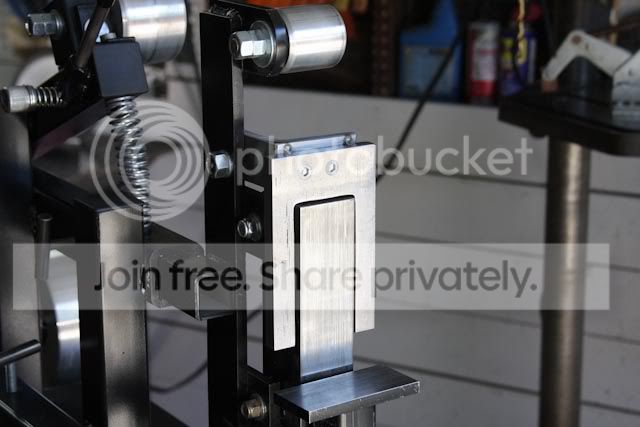

Here's my baby, courtesy of Tracy's inspiration.

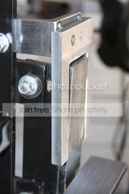

How stable/sturdy is the one bolt holding the guide? That looks to be the only weak spot of it. I'd think that a little pressure on the bottom of the guide would turn it. Did you consider a second support, or a bigger support with two bolts?
Thanks everyone for looking. I have a lot of fun with this grinder.

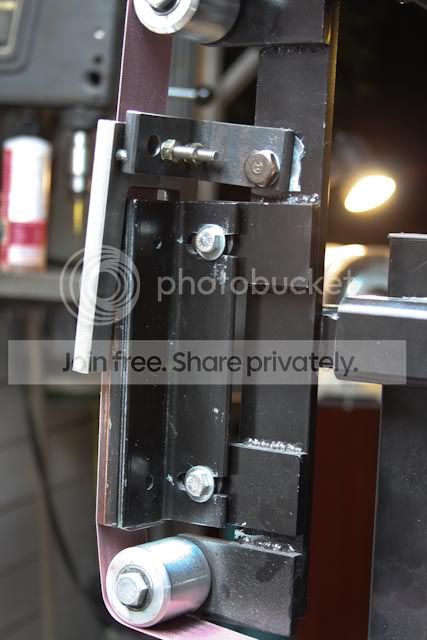

Zaph1 - That's a 1/2" bolt and I used 1/2" plate. When I tighten it down it is very sturdy, very hard to move.
For anyone trying this, there are a couple of considerations. You really want to get the jig level and plum with the platen. I used welding magnets attached to the metal platen to hold it in place, clamped the jig arm really good, marked the bolt holes, tack welded in place, and then drilled the holes to ensure proper alignment.
The pivot or bolt(s) location is critical. Too high and the jig will just lift away from the platen with no useable intersecting area with the belt. Mine pivots just about as high as useable, and I do adjust the top of my platen outward slightly before fine tuning the jig to get the right angle. If the jig was flush with the platen, and the pivot point was about 1/3 of the way down the platen, you could probably adjust the jig from 0 to whatever degrees without moving the platen at all.

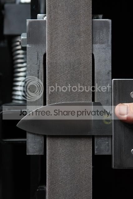

I have learned quite a bit playing with this jig, so I thought I would share my findings.
1. It has two great advantages. It helps you start your bevel at the right, or at least consistent angle, depending on how you set it up.
2. It helps you nail the plunge line, actually almost guarantees it if you remember to adjust your belt tracking properly (and if you built, aligned, and attached the jig properly).
Now for what I'm guessing the experienced makers have been thinking.
3. At some point, you will have free hand if you want to flat grind past about 1/2 the height of the blade. (I've learned to use the angle aspect of the jig to get the bevel going, then work higher on the belt in full contact with the platen so I can apply pressure where necessary and feather the point) True.
4. At some point you will have see what you are grinding as you grind and have the freedom to adjust accordingly on the fly. True.
5. If you want a full flat grind, you still need the hand control to put the blade to the platen once the bevel becomes big enough. True.

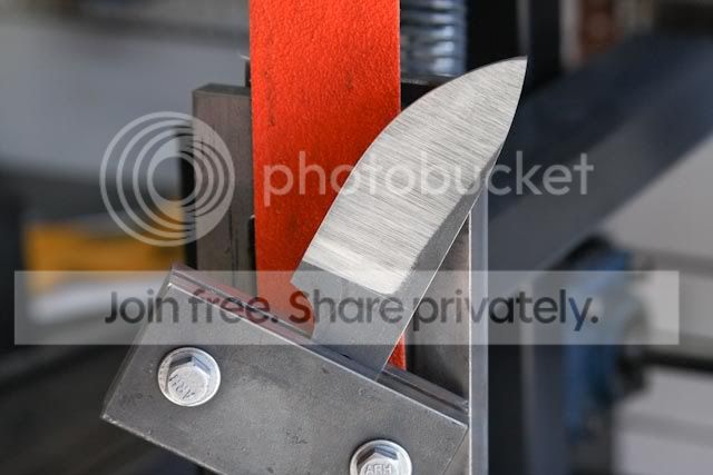

Here are some issues that remain.
6. It is not easy to build or attach. I designed my own platen set up and made it as tall as I could and still fit a 72" belt. That was lucky for me, because it gave me enough room to fit this thing and I was certainly not thinking about that when I built my grinder.
7. Every home made grinder is different, if you do this, you will need to figure out how to execute the attachment. If you can't attach it to the platen arm, think about attaching it to the table. You will need to be very precise. When I attached my ceramic platen after building the jig, I had a change in geometry and angles.
8. If you have a commercial grinder, it's a whole other ball of wax. There is always a way, you will have to find it.
I think I am most happy that it helps me with a good start to my grinds. Spending the time to think about how to make it work and practicing really has helped my relative understanding about what it takes to grind a nice blade. Even with this aid, I have a long way to go. I still need a ton of practice, experience, and learning. A nice aside is that I now know what they are talking about when it comes to "feel." I use this to start right, and then I move up the platen and work freehand (except for the clamp on my knife, but hey lots of people use those, right?);)

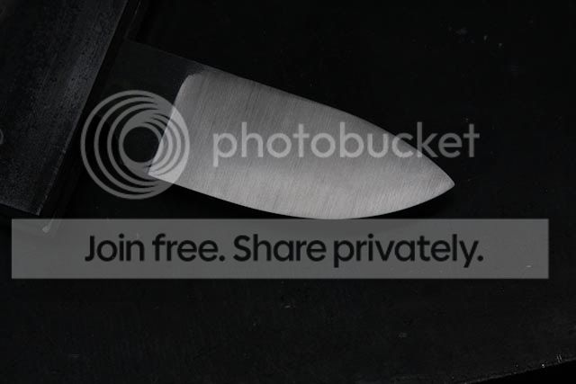

Here are two I ground today in between taking the kids back and forth from school among other things (#4 and #5).
