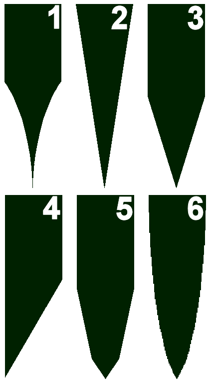

For slicing things like potatoes, squash, apples and wood (like cutting back branches or cutting shavings for kindling), my experience is that convex (6) blows away hollow grind (1). The theory, as I understand it, is that in material that won't easily self separate, the convex blade forces it apart at the outset of the cut, minimizing friction after that. With the hollow grind, the material hangs up on the shoulder of the grind where the hollow meets the spine.
Flat is not quite as good as convex in this regard but is close. On things like meat or rope, that self separate when cut, hollow grinds make a lot of sense.
If you want to try a cheap experiment, get an Opinel N9 and a Buck 110. Give them both good edges and cut a bunch of branches, make some shavings or cut potatoes. I find the difference to be very dramatic.
