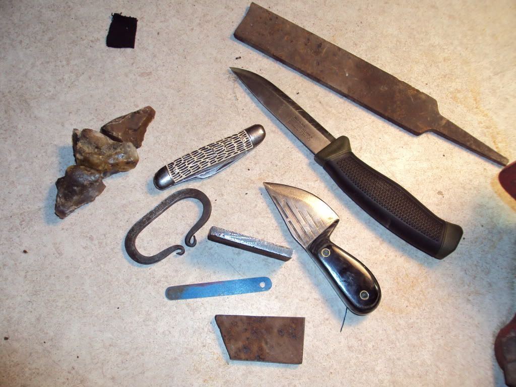

Just a quick video on flint and steel strikers, that you might already have. And how to make one from a file.
There are other things that work, but this is all I had handy!

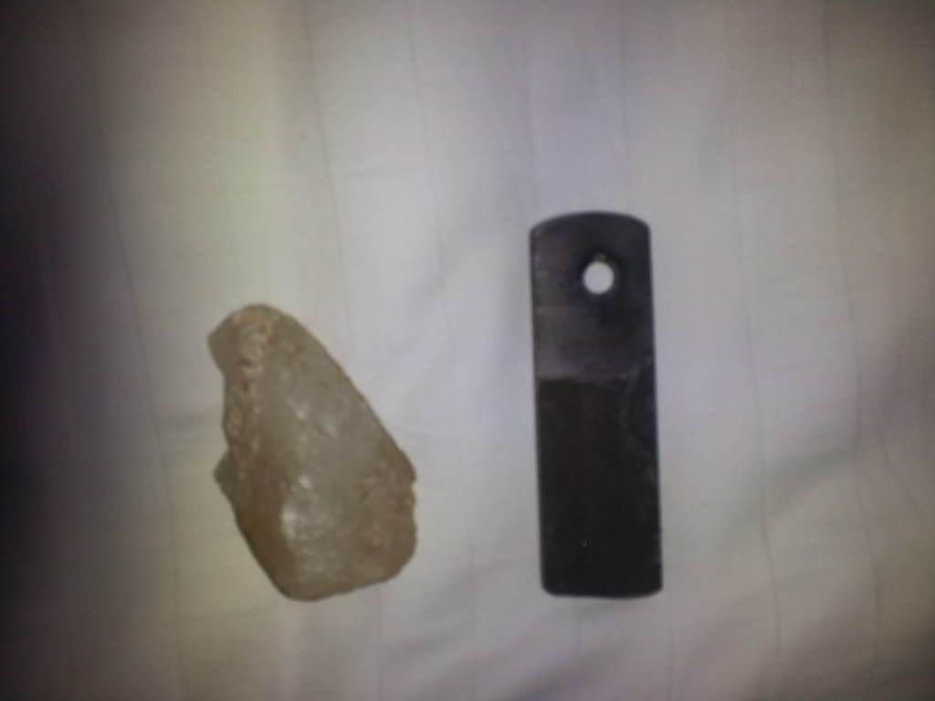

thanks for the video. You inspired me to go out and make one. The flint is a rock I found up by the barn that sparks pretty well and the striker is an old file. I broke it in the vice, used an angle grinder to smooth the striking edge and round all the corners. I then used the drill press to make a lanyard hole.
I am gonna try to make a fire with it tomorrow. I will let you now how it goes.

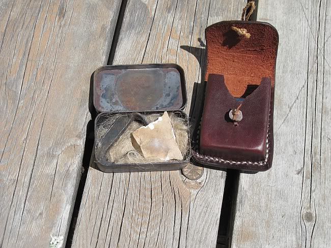

I love flint and steel,this is my kit,the tin fits into the leather case that I carry on my belt
And this striker I got from a friend this past weekend,it throws a lot of sparks
