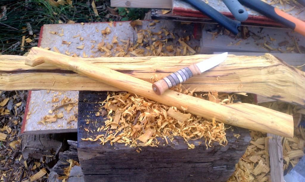

Resurrected an old flint edge double bit with some TLC, Osage Orange, and Red Oak. Hope you enjoy the build log and video.
http://www.datamungeblog.com/2013/11/axe-handle.html

That haft is really nice. I like the flat sides on it. It should perform like an octagonal haft. I've never thought of using other woods to make up for Osage orange's shortcomings. It's a great,wood but difficult to find pieces long and straight enough for full size axes. You did an excellent job on this one.
Very nice woodworking skills and beautiful haft. I hand carved an osage handle for my boys axe. Tough stuff.
That's a great handle. I'm looking forward to my osage projects turning a darker orange with age. I even thought about setting this one in a window to speed up the process.
