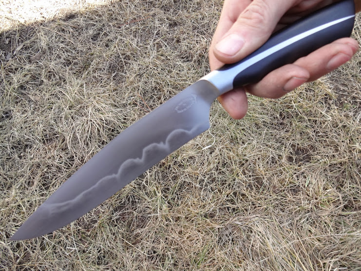

I sold this in fixed blades a couple weeks ago, then realized I'd never shown it here. (I don't intend to post everything I make here, just the stuff that I'm more excited about.) Of course this has been done very nicely and similarly before by other makers, once I saw it I had to try though. Here's my version, with a hamon thrown in.
This here is FlipSide, so called because the tang is 90 degrees from normal for an integral tapered tang knife. As you can see, I decided to make a curved handle and thus curve the tang too. First one of these I’ve tried!
The steel is W2 with a goodly hamon, mostly gunome but the clay blew off a little early toward the tip… the bolster, tang and African blackwood of the handle are all at 1000 grit and the blackwood has a deep teak oil finish. The blade is full flat ground with just a little re-curve. Vertical stainless pins are installed through the handle.
Specs:
11-1/8” overall length.
6-1/8” blade length, tip to heel.
1-1/4” blade width at heel.
.190” blade thickness, spine at bolster.
6-3/4 oz. total weight.
Handle max thickness of 5/8” at butt.
Balances at middle of bolster front transition.
Here’s some terrible pics, and a vid! Boy, my voice sure doesn’t sound like that in my head…

Beautiful work Salem. I never realized until now, that is the way to forge the tang on a full tang integral. :thumbup: gotta try that one of these days.
I'm with everyone else. VERY engaging piece. Years ago I picked up one of Tai's 'Topsy Turvy' versions and it's still one of my faves, because of how different it is. Like this. :)

I disagree with your video statement on showing the hamon: "It's amazing what bright sunlight can do to show it..." Notice it showed well ONLY when you reflected off of a dark surface. That there was enough sunlight to show that darkness from the side lighting is key. How well I know!

Thanks for the kind words, y'all. Now I just have to work on a little ornamentation for that bolster and tang surface...
Coop, Tai was the first one I saw do this. It was very striking to me at the time!
