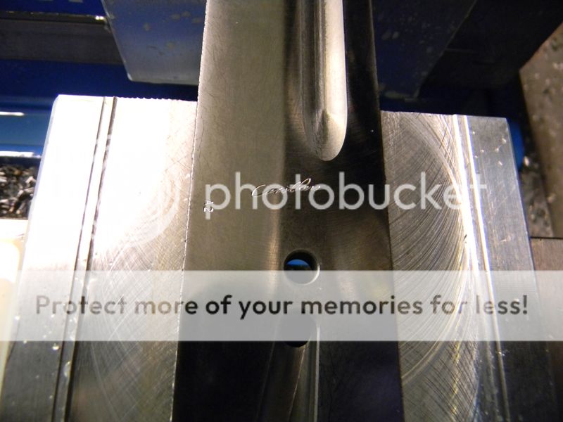

Hello,
Can I use Fly-Cutter with carbide inserts instead of Surface grinder ?
Don't have space to place grinder in workshop
Now I have ZX7045 milling maschine and thinking to buy for this a 300m x 150mm magnetic chuck with 140Nm force.
To work max with 290mm blades, 2,5-5mm thick.
0,05mm / 0,2mm cutting deph.
Fly cutter with 11* angle, S12M-SCLCL09 Boring bar + CCMT09T304-HF YBC252 carbide inserts.
If I can use this for surface milling, this can make my work on folders faster
Just finished, but shank need to be turned from 25mm to 20mm to get this in the ER32 collet.
Best Regards,
Konrad
