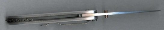

My other hobby is horses. I raise and show quarter horses in reining, and go to horseshows almost every weekend from about march through september. I also did a little work breaking young stuff to saddle for people and have gotten to know quite a few horse trainers.
One handed folders are really popular with horse people, you see a lot of spyderco's clip it lineup, some of benchmade's stuff, and sadly quite a few knockoffs. You also see them all being used as screwdrivers A LOT! Bridles and tack are held together with chicago screws and people are always having them come loose at the most inconvenient time, or are trying to switch bits at the last minute.

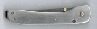

So I decided to make a one handed knife that you could use for chicago screws. I didn't want to change the size or weight any more than necessary though, so what I came up with was a wedge coming off of the rear spacer thats ground down like a flat blade screwdriver.Its just stub, sticks out about 1/8" and you don't notice it in your pocket or when your using it as a knife.
Here's some pics:
attachment.php
attachment.php
attachment.php
Blade is 3" long, .125" 440C triple quenched and tempered.
Its about 4 1/4" closed. Scales are some el cheapo aluminum I found at the hardware store for about $2 for a 6ft bar (still not worth it :rolleyes: ) had some voids show up when I was finishing it :(
The backspacer/screwdriver is also 440C, single quenched and tempered for 2 hours at 475 degrees, wasn't sure how hot it should be. It got fairly dark in color, I don't think it will break if dropped. Liners are .040" 410 SS, both hardened.
I know folks around here don't like serrations, especially combo edge, but they're about as good as it gets for cutting a double layered nylon halter (about 3X as heavy as a seatbelt) or lead ropes and stuff. Horses are kind of accident prone.
What do you think?

Way Cool! I love working knives! I personaly don't like serations, but know a lot of people who do, depends on the use.
Pretty inovative, should work great.:cool:
I particularly like the edge curve to the tip. It has a rather fast turn that looks functional; not to say a slower curve is not. It stood out to me in a positive way. I also like the deep edge (running far up the blade), perhaps it is only an unintended photo exhageration.
This should be a good pocket knife for who ever is the lucky owner. The stainless, I suppose it is, scales should ride well against loose coins, keys and such.
In all I like it and wish that I had gotten to the point of making folders so that I could appreciate it more than I even do now.
EDIT: I thought of this later because it was in my memory but failed on my post to bring it up: Your fine distal stood out to me. It looks very well done and I like the definitive tip of the straight and complimentary distal.
Roger

I like this, seems very functional and well thought out. Only been riding a few times, but can see where this knife would be VERY useful, and I thinkt he screwdriver is very well executed. Can see that sitting in my pocket and never realize it's there. And it seems to flow well from the filework.
A very nice piece of work!
How about a pic of the clip side?

I'll try to come up with a clip side pic for you, nothing real special going on over there, just a standard clip from TKS and everything else pretty much matches the other side.

Matt I've been thinking about this cool knife for several days now and came back to see if I could tell how you ground the blade for the screwdriver. And in fact it does look like you convex ground it to the edge, which was what I was going to suggest. (For some reason the mental image that stuck with me was of a wedge or flat ground cross section.) I think this is a great knife and one of those ideas that we'll start seeing on CRKTs here in about 9 months or so. :D You watch, this is going to get copied soon.
I too really like the blunt tip on your blade. Very functional and sturdy, and would let you reach deep into something to cut. There are just some things a point is no good for!
This is one of the best working knives I've ever seen. I hope if someone decides to copy it you get an opportunity to license it rather than get ripped off, which saddly happens a lot to folks here.

Thanks for the kind words. I'll be happy just to see my idea put to use, but I'll be really happy if I get credit for it.
The screwdriver is kind of a convex grind, I cut the bevels for the most part on the edge of the platen on my 4X36, then squared the end on my bench grinder.

Edit: forgot to add, sorry but I can't get another picture. Don't know why I didn't think of it, but I gave the knife away saturday. Friend of mine just graduated from high school and is going on to findlay university to major in equine training and business management. Thought he should have something better than the knockoff of a spyderco delica he had been using. It seemed to be quite a surprise when he opened it, the look on his face was definitely worth it :)
