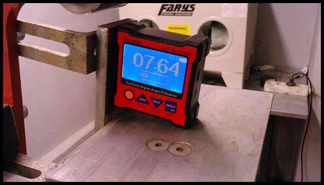

I have been putting together plans and parts to make a liner lock folder. I have now come to figuring out how to get the 8 degree angle on the tang and then the 2-3 angle on the lock face. I have seen some WIP and some videos that show jigs and explain some things but it just makes me more confused.
I understand the 8 degrees on the face of the tang that meets the lock, it can be flat or you can use a 4" diameter wheel to cut it in. But I am missing how to get the 8 degrees transferred to the tang face.
I am also confused on the angle of the lock face. I have seen talk stating that the lockup should be near the bottom of the lock face and have open space at the top, but then I saw some videos talking about it being in the other direction across the width of the lock face.
I was hoping you guys could clarify for me and then maybe show me your jigs that help with getting those angles with and explanation associated with the picture?
I have a KMG and a tool rest so what would I have to make to get it done correctly and have good lock up?
I should add that I have read the Terzuola book about the tactical folding knife. From what he says is you have the 8 degree radius tang face and then the lock face is ground to match the tang face. From there he just buffs the top par of the lock so that the bottom part ( 0.09" - .125" ) makes contact with the tang face. If I did that It just leave me with trying to figure out how to make the 8 degree angles on the tang face and then matching it to the lock face?

Okay, Brian, here is a "jig" system I use on every liner lock to do the tang angle at that 8 degrees with a a flat cut, using a platen and table. I place a 120 belt stiff belt on the grinder, measure 7/8" from the belt ( I use a piece of metal cut to use for size ) and lay a 1/8"X 1" piece of mild steel length wise on the table. I use two wraps of masking tape to hold this down, remove the measuring spacer, and do the cut to the depth I want, remembering to leave room for the washer width. The 120 grit grind is what I want for a finish, so no further belt change is necessary. Frank
I use an Empire protractor/angle finder ($5) and set the platen angle 8.5 degrees to the work rest. Maybe it's too simple but it works for me.
Mark
Frank, I don't follow how you get 8 degrees that way. From what I think you are saying you have a flat platen with a 1/8" x 1" piece of mild steel 7/8" away from the belt and then you cut? Wouldn't that just give you a square face if the table was perpendicular to the platen/belt?
Rest the blade on the spacer and you have a triangle w/ 7/8" base, 1/8" height. Inverse tangent yields an angle of 8.13 degrees

Even if you do that and have the shim 7/8" away and it is 1/8" high, if it is flat and you put it to a flat platen and the flat platen is perpendicular to the tool rest ( 90 degree angle) you can't get an 8 degree angle off of it if you do what it shows in the picture, you get a square edge if the ricasso/tang is flat and parallel.
I ask because that is what I take away from what Frank Niro is saying.
More than one way to skin a cat. Your drawing is correct for doing it Frank's way. You simply have to angle the leading edge of the tang down until it hits the work rest. Right under where the "N" is in your drawing would be the fulcrum.
