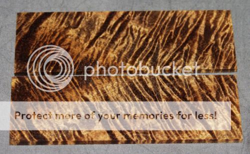

Javier Vogt is the winner of the stabilized Koa Scales

As a thank you I will give away this set of koa scales to one of you who was willing to help me to become less ignorant.
I will use a random number generator on Friday June 10th to select the winner. Your post number will be your entry.

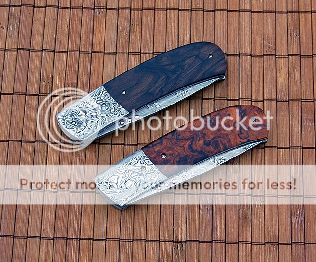

I think one reson is that wood can shrink and may cause problem for a folder with tight tolerances. One other reson may be that you will need extremly tight figured wood for a small folder.I think that normal figured wood usully don't look to good on a folder.
However I used wood for my two first folders, the ones below and haven't had any problem with them.
Best regards Jakob

Those are both beautiful folders. I really like the ironwood burl, but the ziricote has a classier more formal look to me.
Javier,
I would sure like to see more photos of your knives.
