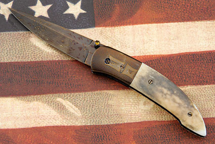

I'm quite unexperienced in the knife industry, and would like to know which knife type of a knife is long-lasting and effective with less needs of repair; mainly in rainy, dew climates. Folder or Non-folder? I'm talking about A-class knives, such as the Buffalo Skull or the Hamon Stag Bowie.
http://bladegallery.com/pics/87460_1_n.jpg
http://bladegallery.com/pics/88297_1_n.jpg
If it is possible, I would like to know as well what type of knife/handle is needed for wet environments ( blade type / handle type / approx. length / etc.) I would appreciate it greatly.

First, may I complement on you your taste, because those are two beautiful knives. I'm not sure they're very practical for your intended use, though.
Folders and fixed blades have their own advantages and disadvantages, but if you are in the field in a difficult climate in a somewhat remote area, you are probably best off with a fixed blade. Fixed blades are less prone to failure , easier to repair and are more versatile. They are actually easier to access too because you don't have to fish around for it on a pocket, you can lash it to a pack, tie it down on your leg, use it as a spear for fishing or for height extension if you really have to etc etc. Where moisture is a problem you don't have to take it apart to clean it and so forth. ( not as often anyway depending on the scales and the tang).
Having said that, a folder ( or a good neck knife) is very useful to carry as a backup or secondary, if you can afford two blades. But if I could choose one, it would be a fixed blade.
As far as what steel to use in a wet environment, that's one of the questions we debate here quite often. Until recently I used to travel to remote places to whitewater canoe and ocean kayak in fairly nasty conditions. where the usual precautions of cleaning your blade regularly and coating it regularly either isn't possible or that effective( what to coat it with is another debated topic here). Much as i love high carbon steels like 52100 or high performance modern steels like CPM 3V, they don't take well to corrosion ( although coated blades like Fehrman and some others like Busse in Infi steel aren't too bad), a stainless blade, out of S30V or even 440C, for example, may be a better choice. There are materials that are virtually rust proof, like talonite, stellite and titanium, but the first two aren't suitable for chopping and the last is too soft and won't hold an edge that well.
My personal carries for hard use in moist environment were Busses ( usually a steelheart II ( Infi)) or a Fehrman ( a custom Hood Hunter ( coated 3V ). Solid, solid knives you can bet your life on. They retired my Carbon V trailmaster that rusted and pitted in the blink of an eye ( so it seemed) on the nahanni river in the Northwest Territories that also had a terrible handle for hard chopping anyway. My preference in drier conditions is a custom Wally Hayes camp knife forged out of 52100. A better knife but it requires constant care. Still, I always carry at least one secondary on me at all ( almost) all times, usually a neck knife or folder. I also find having a smaller knife convenient for light duty and kitchen if the main knife has to be big enough for chopping.
