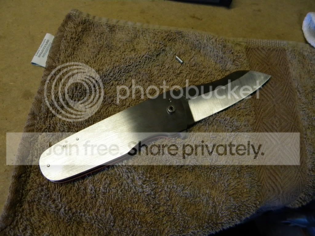

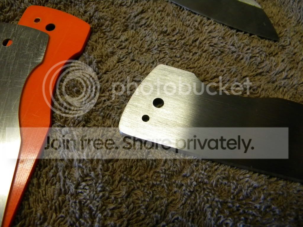

Here is an update on my current folder project, which was going pretty well until this morning when I accidentally started to drill for my 1/8" stop pin on the wrong side of the ti slab!! I ended up drilling straight through after I realized there was no going back, so now instead of having a nested 1/8" stop pin I'm going to need a shouldered stop pin with 1/8" ends and something a little thicker in the middle. The center piece needs to be right around .185" to accommodate my blade and washers. I've found a couple, but nothing with 1/8" tips.
Does anybody know where I can get something to make this work? This project has come a long way to start over now.
