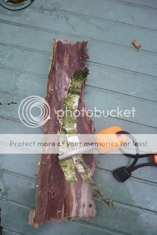

It rains a lot more than it snows so it is always good to practise lighting a fire when the weather is wet .... if it is wet you need to pick your tinder carefully .... where I live the best you can get from the trees around is Birch Bark ....
Easy to cut off with a small folder .... if you want to use this as tinder and do the "bushcraft" thing with the firesteel .... you need to cut it into small strips and scrub the bark into a fine gathering of dust/shavings so it would take from a spark ....
The handy thing with the use of bark is that if you cut a section deep enough then you can use that as the "hearth" to light the tinder on even if the front is soaking wet with rain .... definately to work with a firesteel you have to have everything pretty dry that your using or it is a total waste of time ....

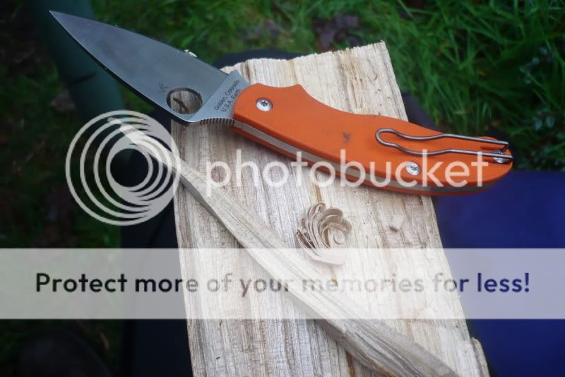

You can use the folder to make some basic small tinder but getting the right sized branches so they are dry on the inside but able to be split with the small blade needs a little searching for ....
In my case for the pic above I used some wood I had sawn up earlier but with the right application you can break up wood the right size .....
Making the tinder using the knife is easy enough and sharpening a dry stick to a pencil shape to use with the pencil sharpener is a really useful tip if you want to get a fire going with the fire steel ....

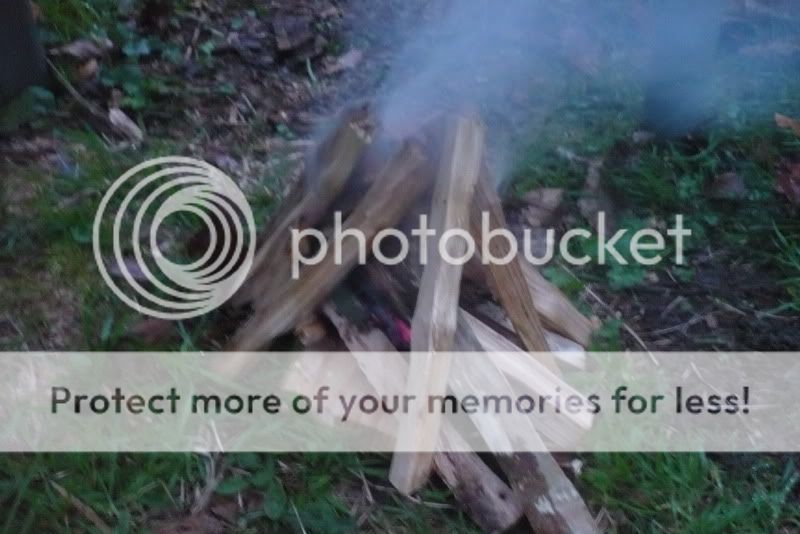

If you prepare well enough it is possible to get the fire going like that ....
Then transfering the hearth to the ground and building up the fire carefully so that the flames will catch is the hard part .... especially if it is raining .... this is when the fire can go out and that is a real PITA .... but with a bit of careful structuring it can be done ....
It just takes a while for the wet firewood to "take" and start burning although once done the sense of achievement is pretty good .... it takes an age to prepare a fire though this way .... probably the best part of 40 minutes to an hour ....

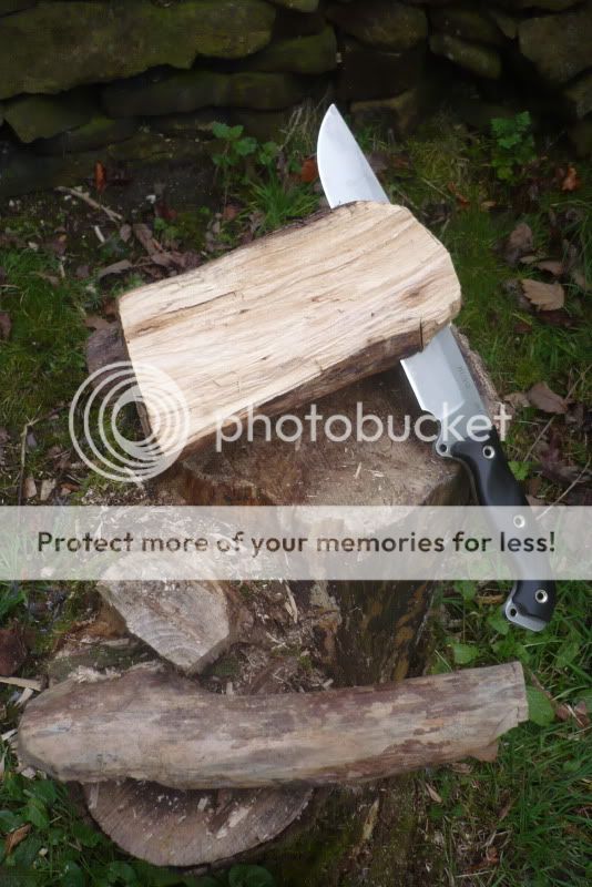

The alternative is that you put a Busse in your rucksack with your waterproofs and some sandwiches or whatever and then when you need to make a fire the knife comes into it's own by being able to prepare the wood in next to no time in comparison .... my usual favourite for this sort of job is my BWM LE .... it is light and comfortable but has great chopping ability ....

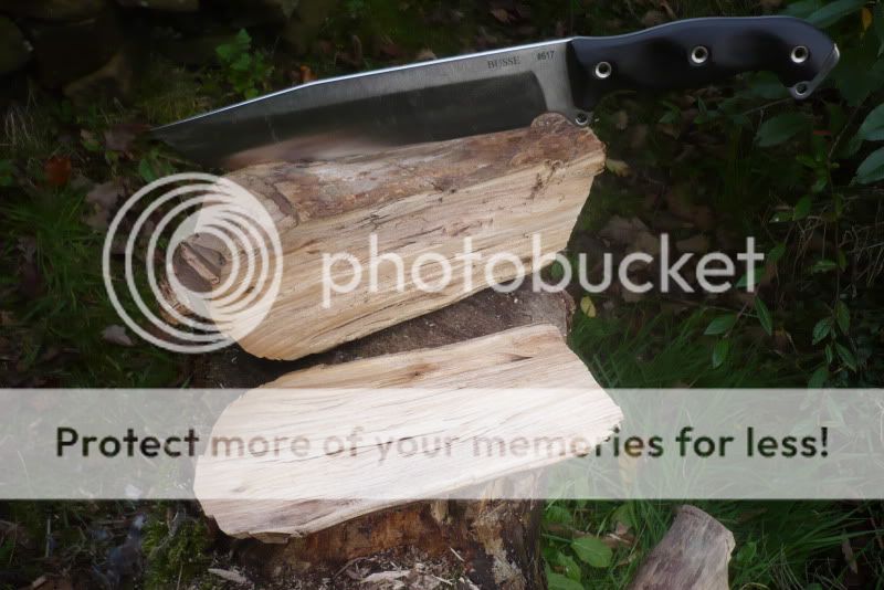

I particularly like the ability to use a long blade to give you good bread board sized "hearths" to prepare a fire on ....
Infact getting the fire going with the benefit of this sort of insulation from the wet ground and the ability to sort out some much larger sticks to get the fire started means that by the time you have prepared everything with a folder you can actually have a proper camp fire going with the use of your Busse ....
Plus you can carry a few more creature comforts such as a kettle to get a brew on and resting up to wait for any help if you have injured yourself becomes a much more pleasant prospect ....
I timed the above actions allowing 45 mins for each and by the time I had a fire going with the folder I had a fire done with the Busse, carved a pot hanger and cut branches for the rests and had a cup of tea and was warming a tin of soup .... so for me the larger knife and rucksack option is a much better way to play it safe ....:thumbup:
