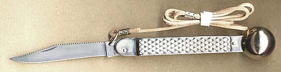

A "priest" is a thing you knock a fish in the head with to keep them from squirming around I think. I would recommend the Puma fish knife. It has a nice round weight on the end and you can also weigh your fish with the knife. I have one and I love it. I never use it, but its very cool. I don't know if they make them anymore, but you could try ebay or the wanted forums on BF. Hope you find a good fishing knife!

How about this knife. It can also be used to smash the head of the fish.

I agree, those Pumas are neat. Thanks to Thomas for posting a picture of one. I had one for years. The only thing is they're NOT a very good fishing knife. They have that "neat" factor though like a large Spyderco Diver's Probe does. They are available all over E-bay but the prices are WAY too high. If anybody's interested, you can get one for the bargain price of $69.00 at www.pumaknives.com, (George and Susan Held's website).
