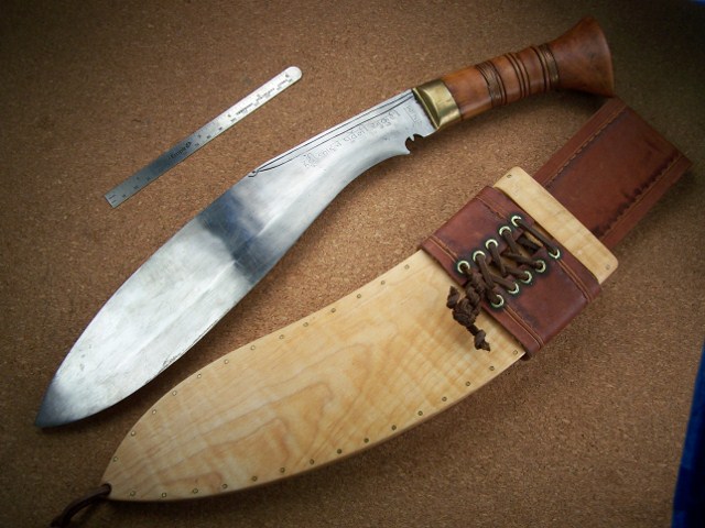

Few years ago i saw a sales thread on BF again and this picture stuck on my mind for the longest time:
(picture from Fiddleback)

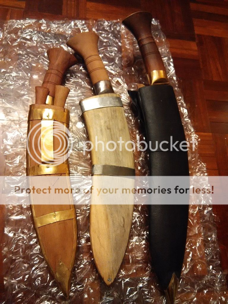

I guess Praj was patient enough to deal with my madness and we finally settled with 3 different sizes with 3 different looks:

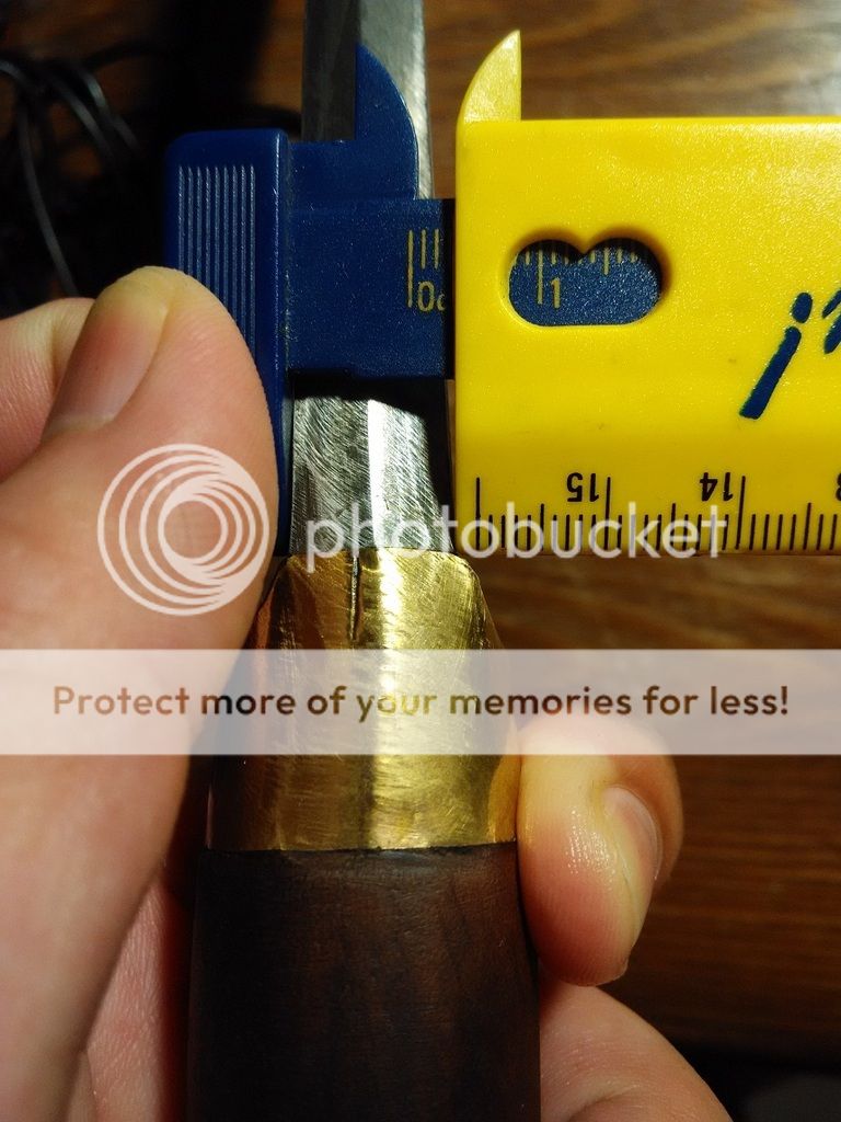

1.Overall length 14 inch
Blade length 9.4 inch.
Overall weight is 24.3 oz (with the fancy sheath)
Blade weight 16.3 oz.
The belly width is 2 inch.
Spine thickness at max is a hair less than 0.4".
Bevel height is 0.55" (14mm)
2.Overall length is 16 inch
Blade length is 11 inch
Overall weight 26.7 oz (with pine wood sheath)
Blade weight 21.7 oz
No karda and chakmak on this one.
Spine thickness at max is 0.43 ".
Bevel height is 0.67" (17mm)
3.Overall length is 17.5 inch
Blade length is 13.5 inch
Overall weight 38.3 oz (with wooden sheath, covered with buffalo hide)
Blade weight is 30.7 oz
Spine thickness is 0.41"
Bevel height at max is 0.83" or 21mm (similar to that of HI Khadka 18")

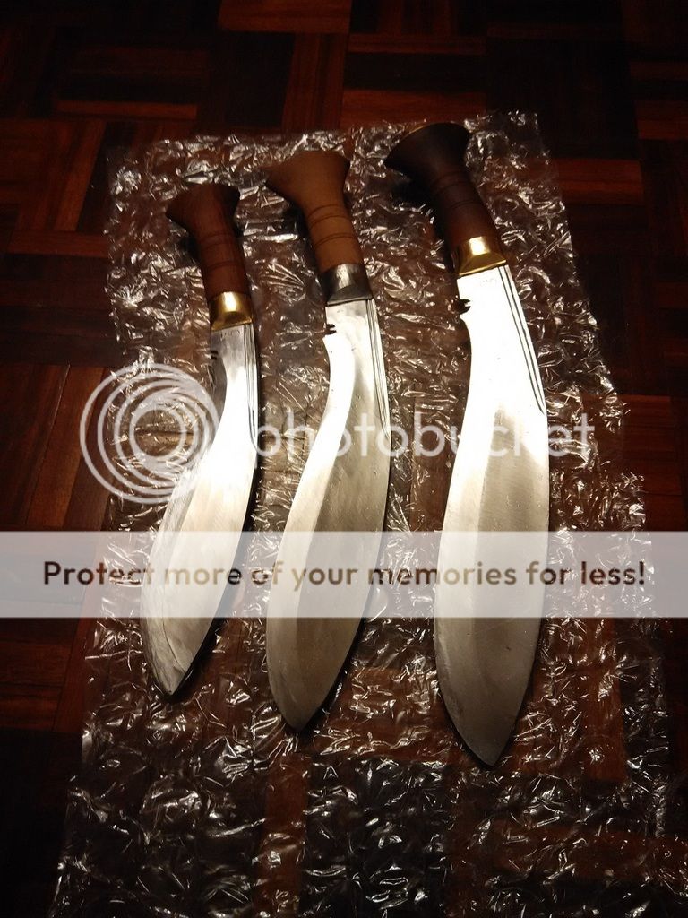

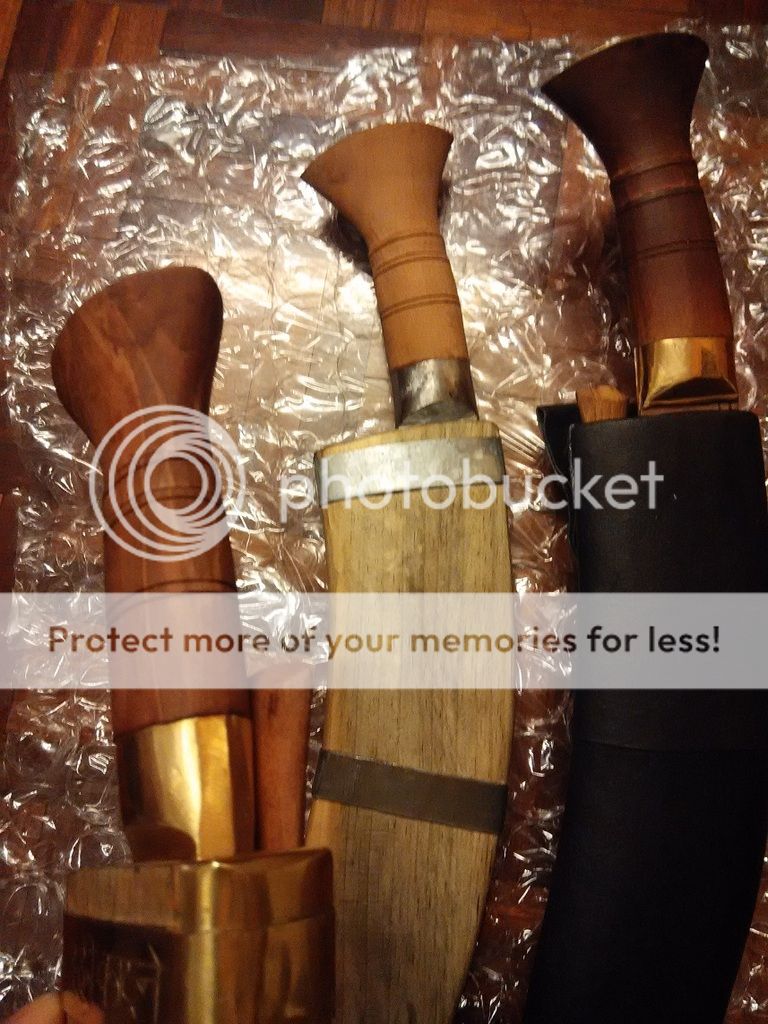

Here are the teasers:

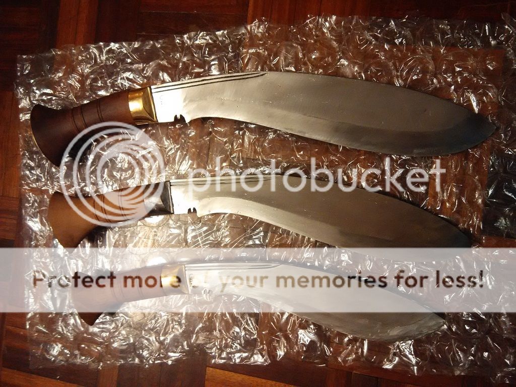

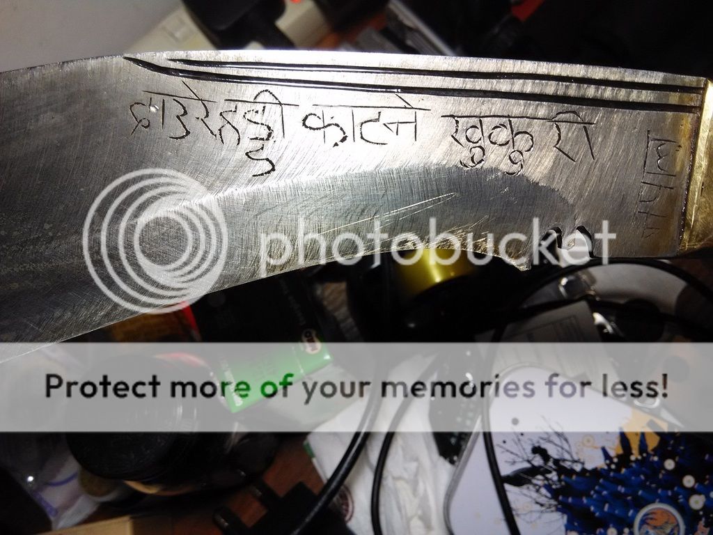

The blades:

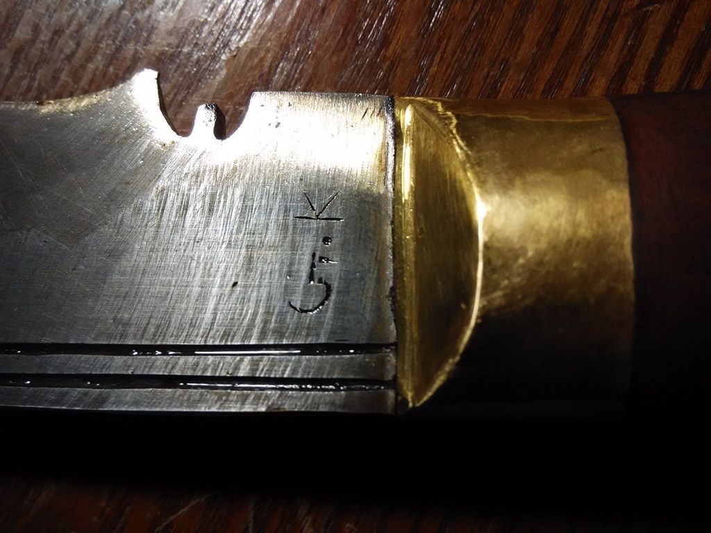

On the right side of the blade, near to the non-habaki bolster, a signature of G.K itself with which the G looks like 5.
On the left side there are engravings that read " Bone Cutting Eastern Khukuri " with the perpendicular "Nepal", all in Devanagari.
If you noticed,the 16" version is the one without the brass bolster as well as the engraving. A true Villager of its kind. i'm already in love.:thumbup:

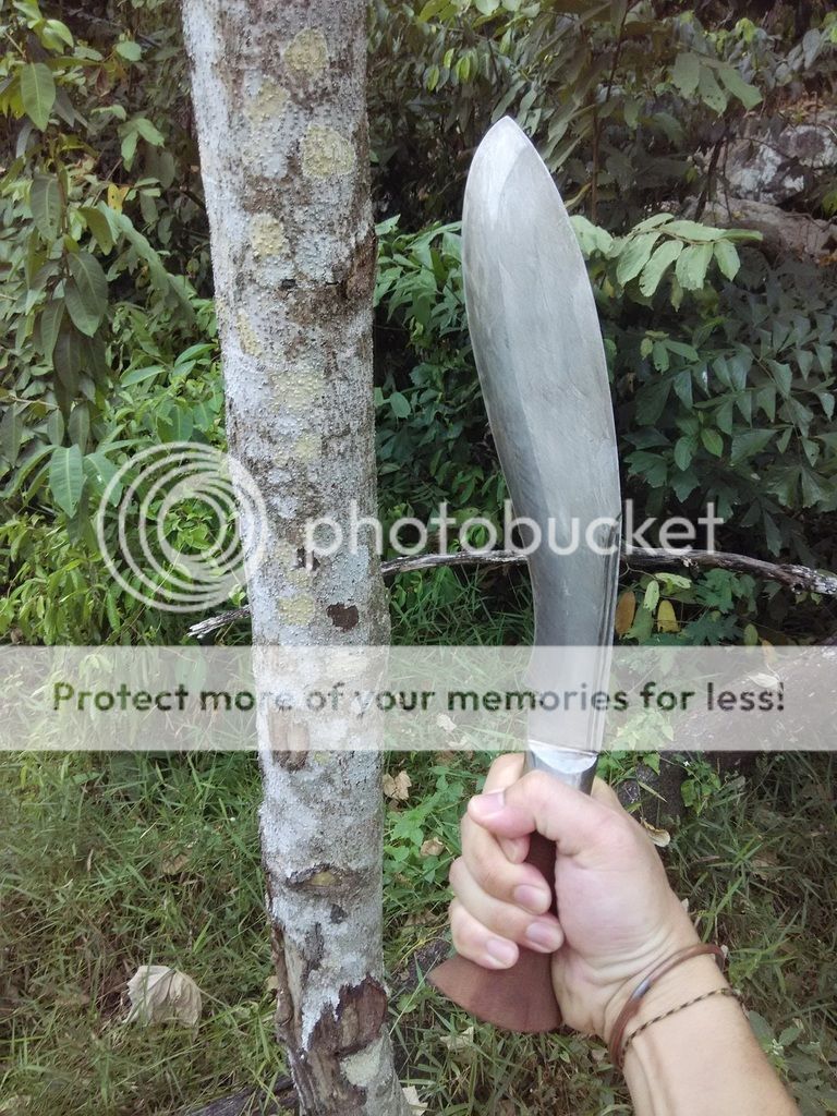

Found a live tree (Pardon me, tree huggers but you really don't belong here) with the khuk on hand for scale:

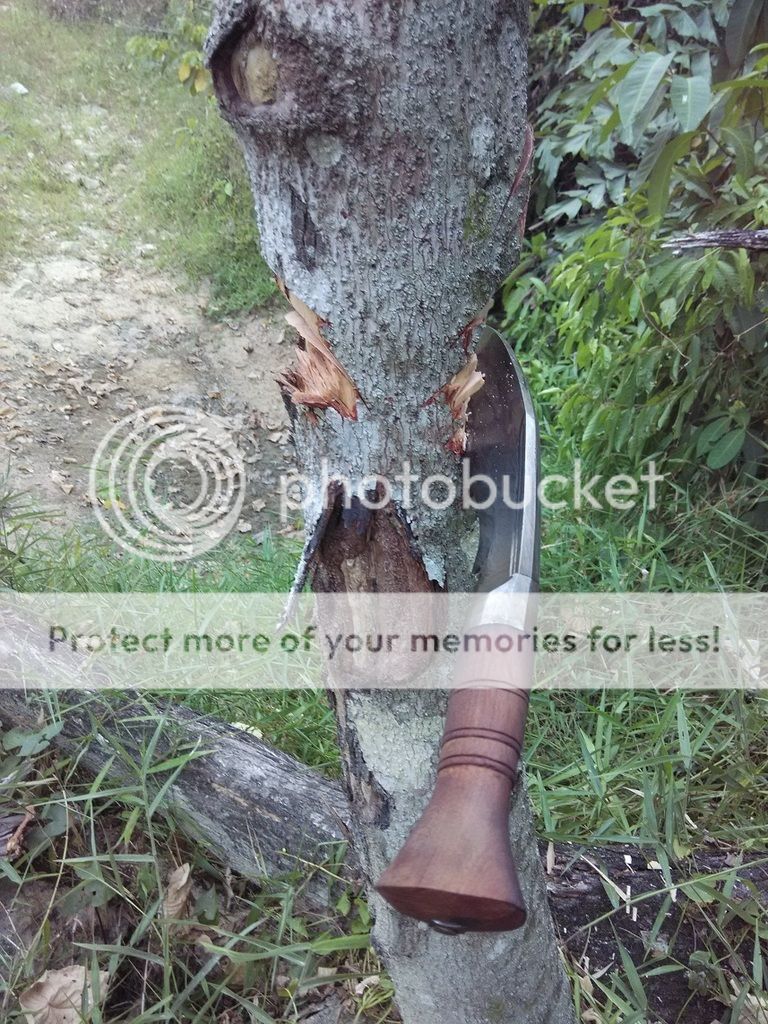

A flick of wrist sank the bevel waist deep into the tree.
http://s873.photobucket.com/user/Ja...ick of wrist_zpstzcrzok3.jpg.html?sort=3&o=18

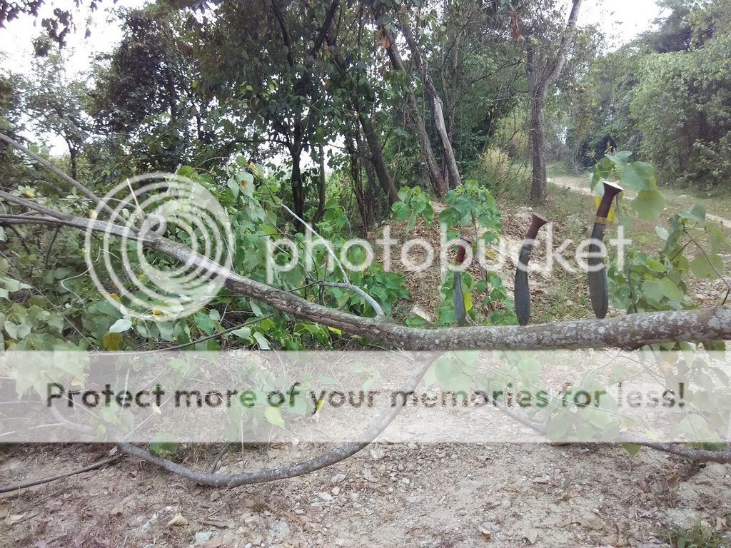

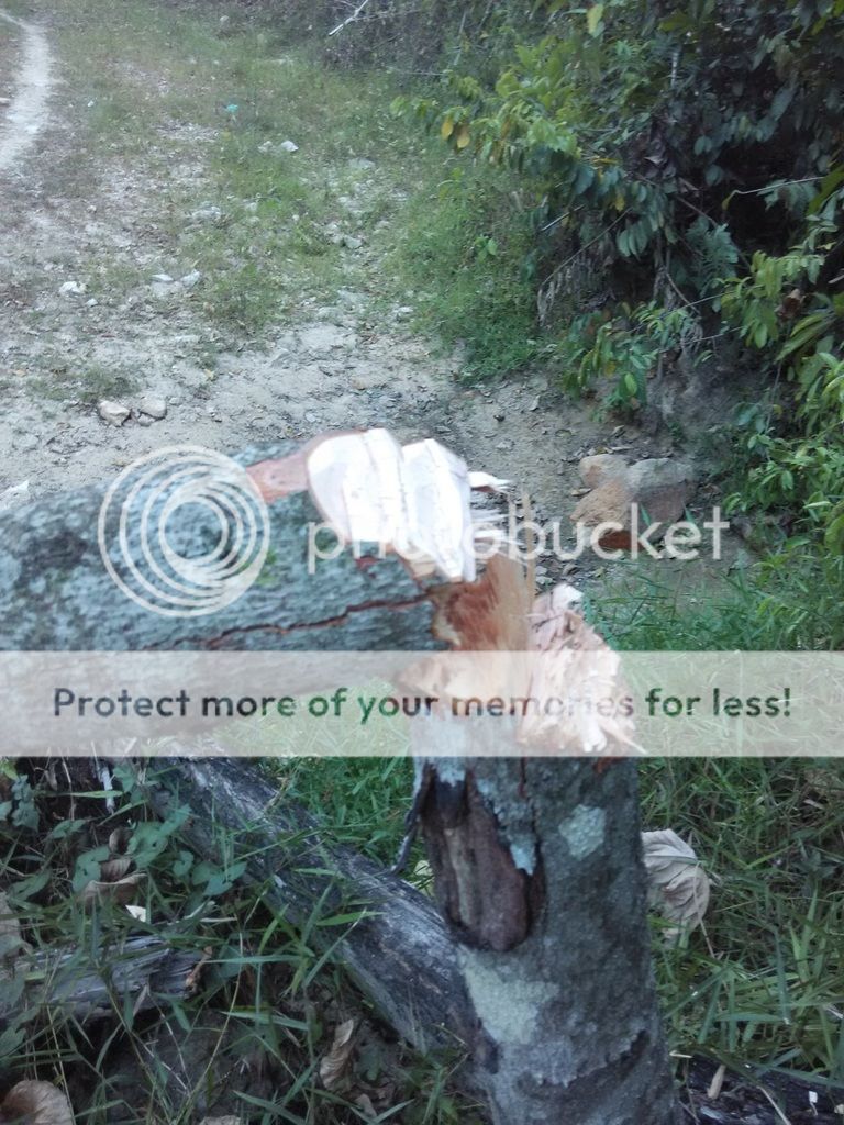

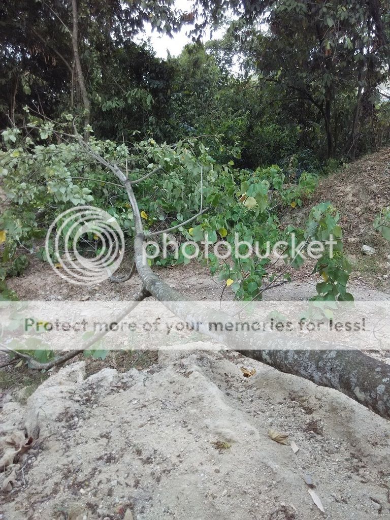

It was really surprising to know that after a few flicks on the right @ ~ 45 deg and then 30 deg on the other side, i heard the EKKKKKK noise and boom:
So what do we do now? blocking up the trail is up to no good!

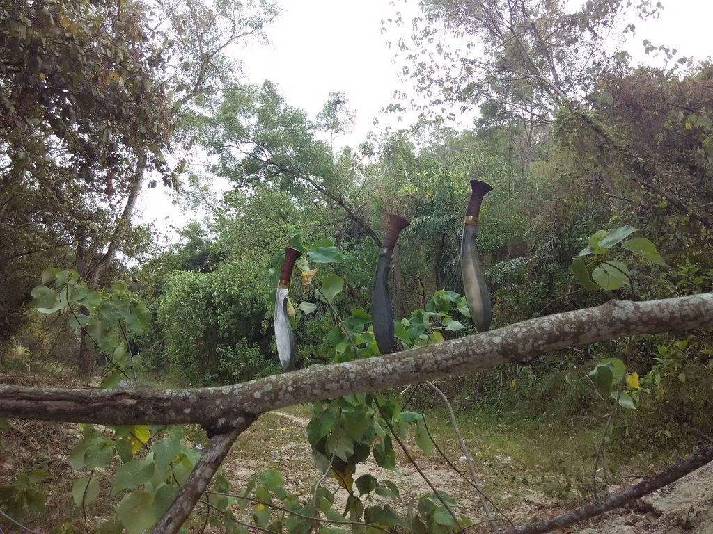

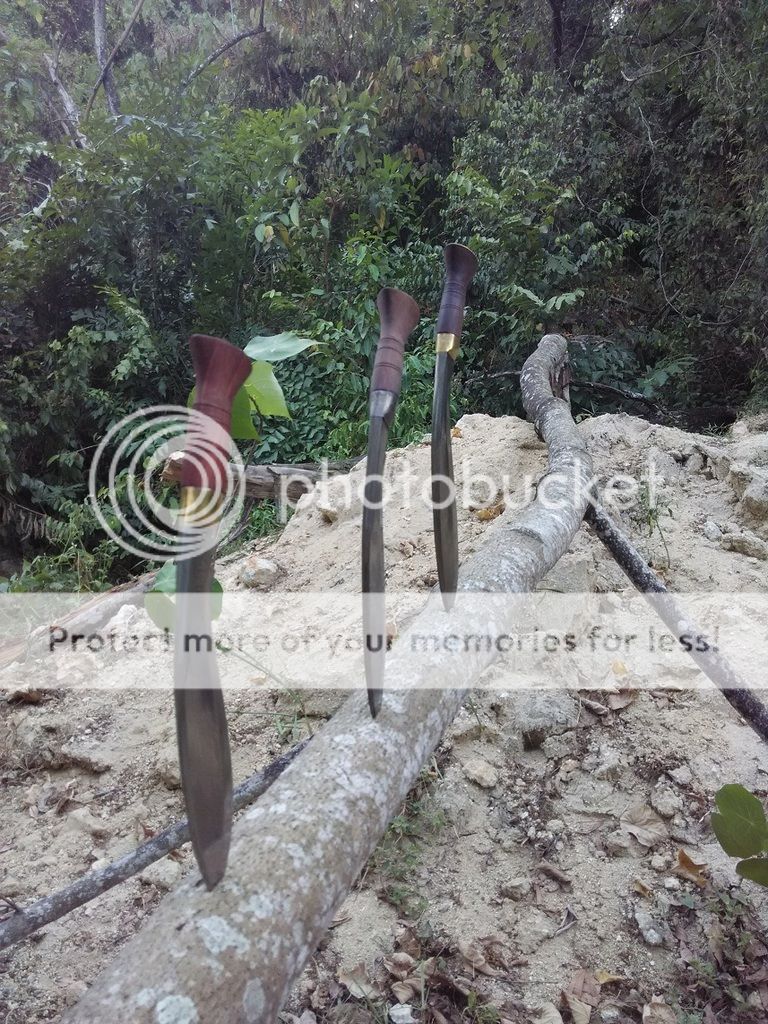

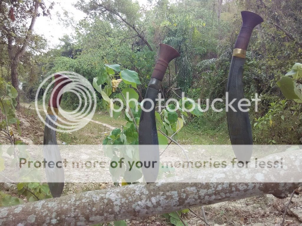

So i summoned the help of the 3 Musketeers of Nepal for these tedious jobs:
(If you have been observing, the other two on the right have been patina'ed. The 17.5" has a superb reflection of the hollow forged surface)
The $$$ shot:

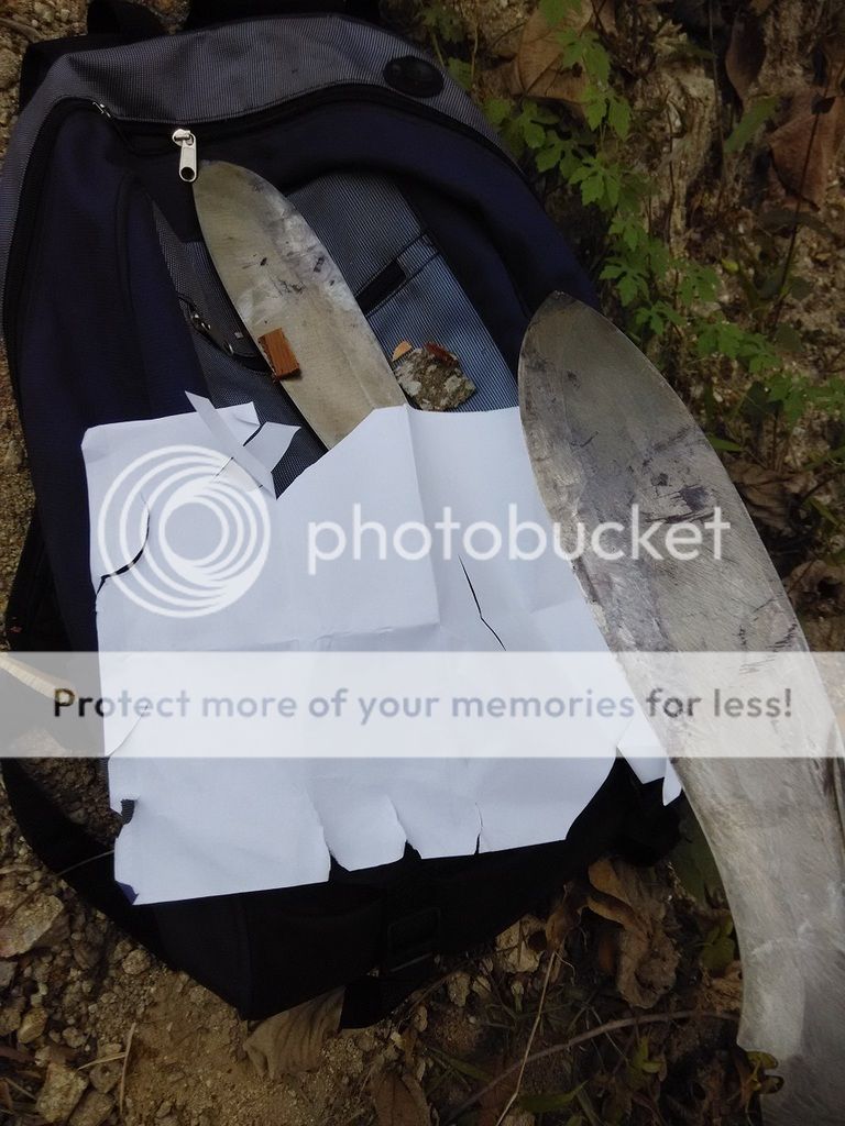

After sending chips flying, the edge stability is awesome and still shaves paper:

Still retain the sharpness after the hardwood:

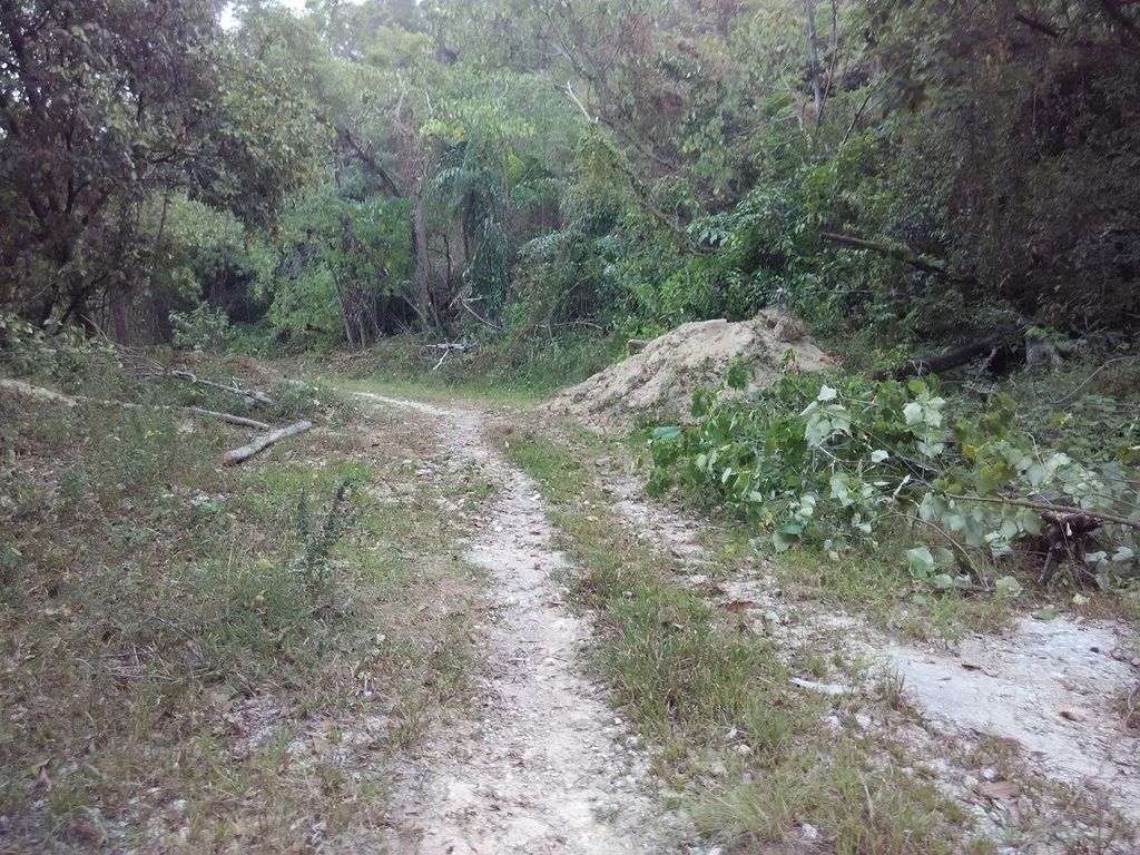

There's nothing like a clear trail, isn't it?;)
