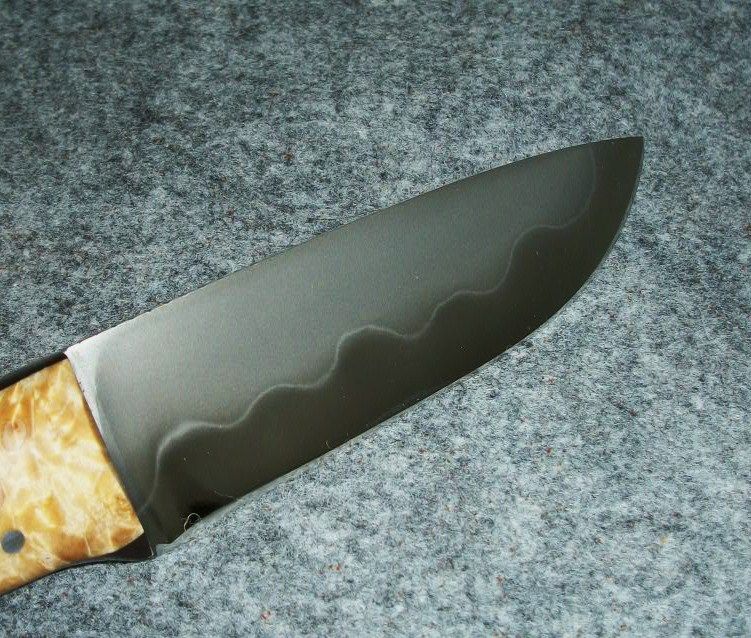

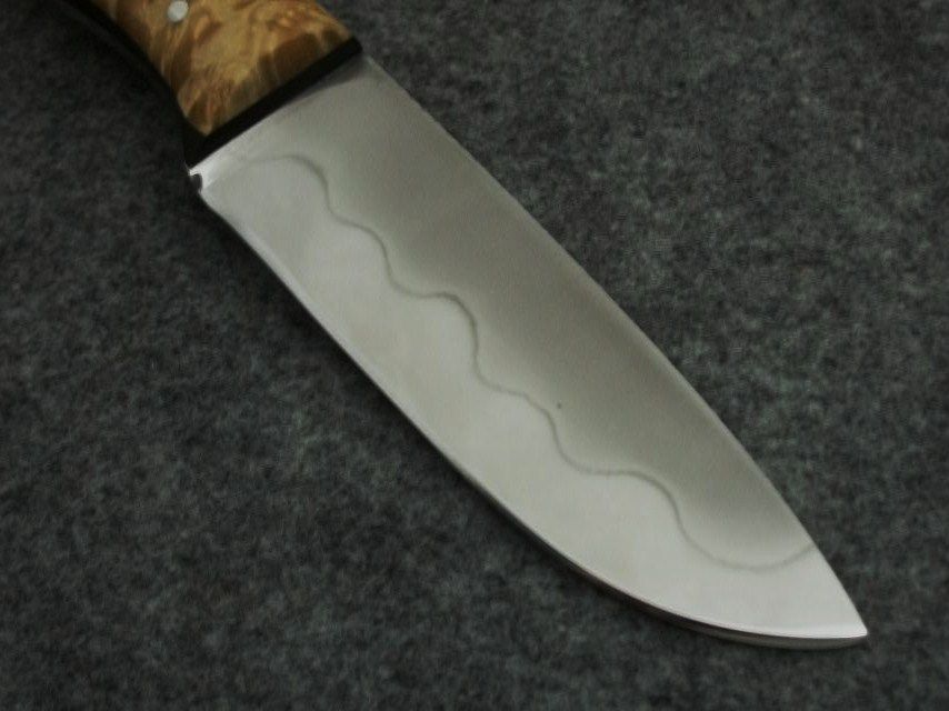

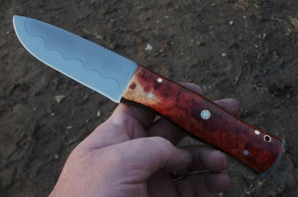

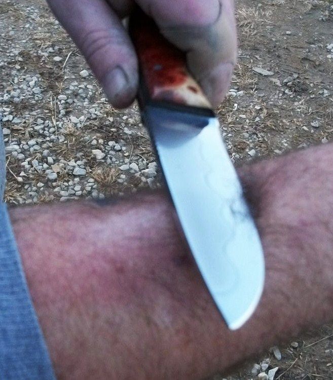

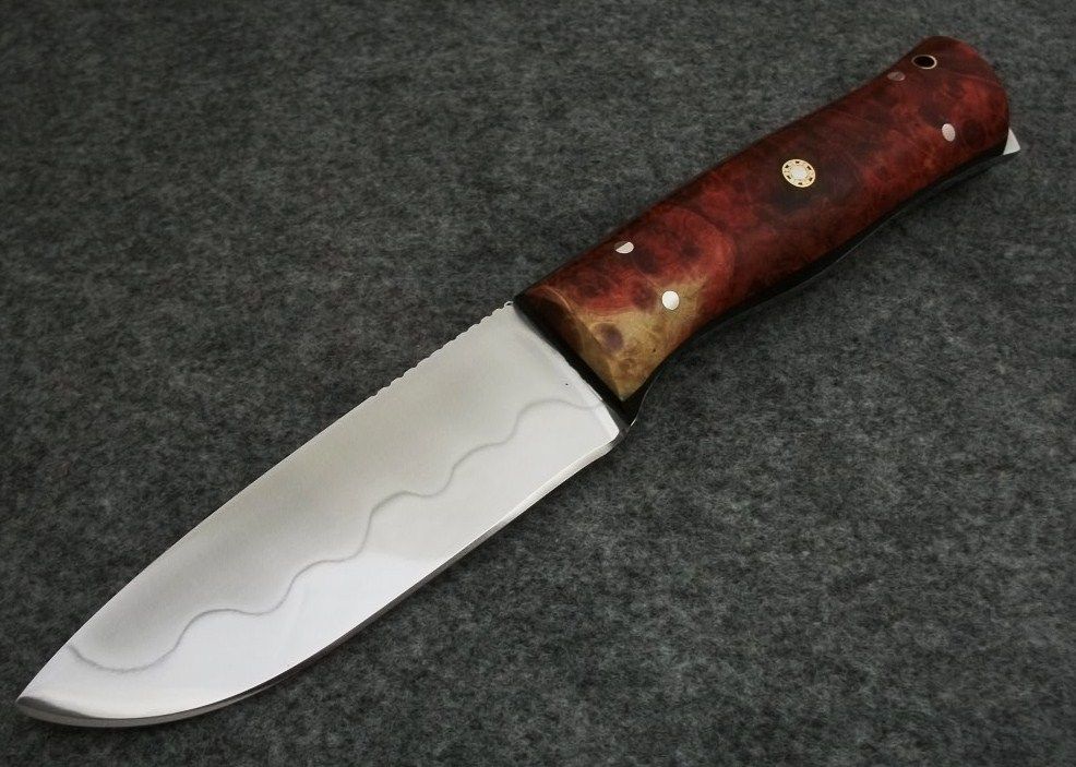

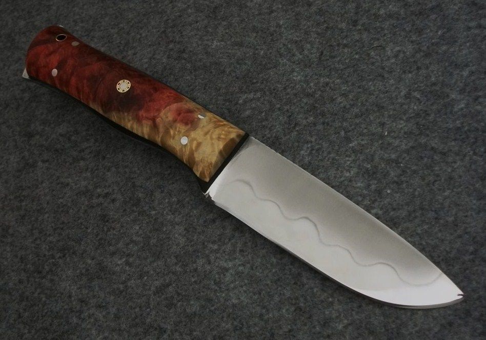

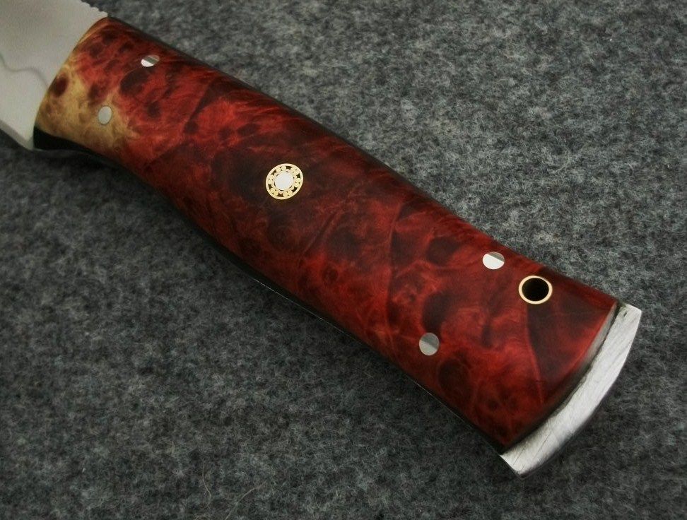

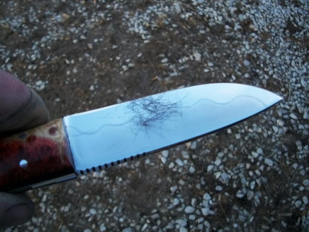

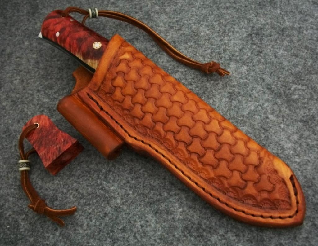

NOW WERE READY FOR THE FINAL STEPS BUFFING,PUTTING AN EDGE ON THE BLADE,AND LEATHER HONING IT TO MY KINDA SHARPNESS,AND TAKING THE FINAL PICS OF THE KNIFE IN THE FINNISHED STATE

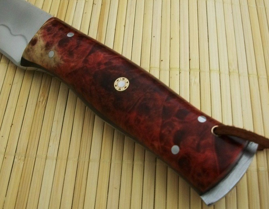

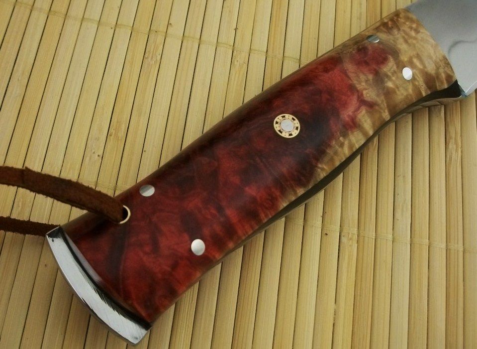

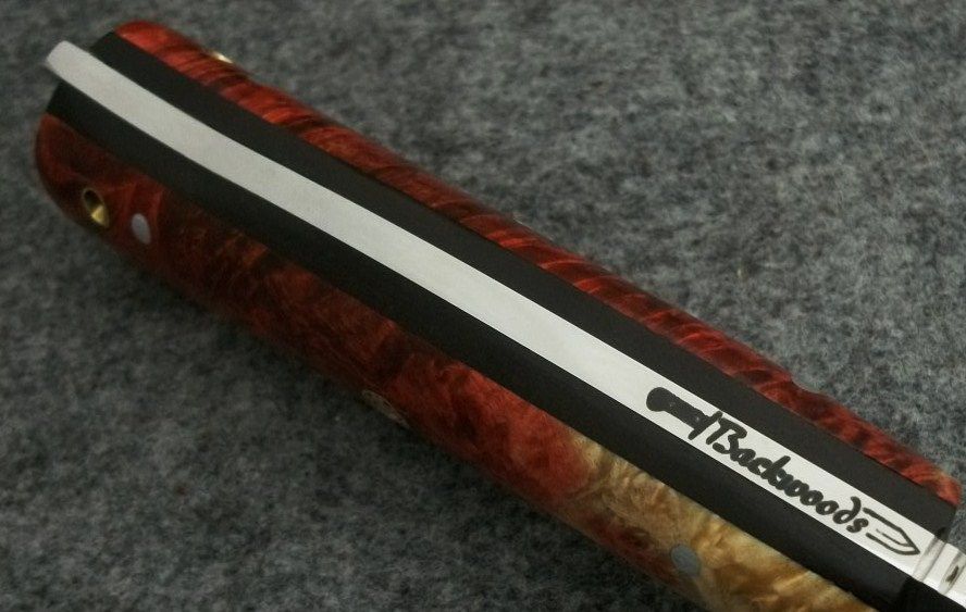

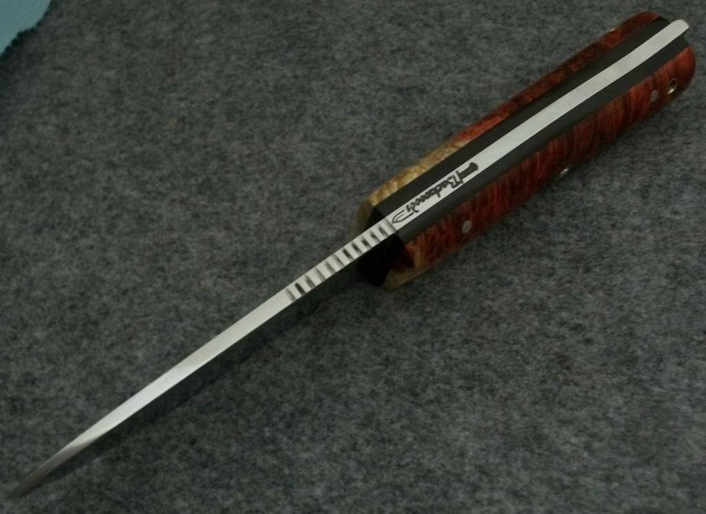

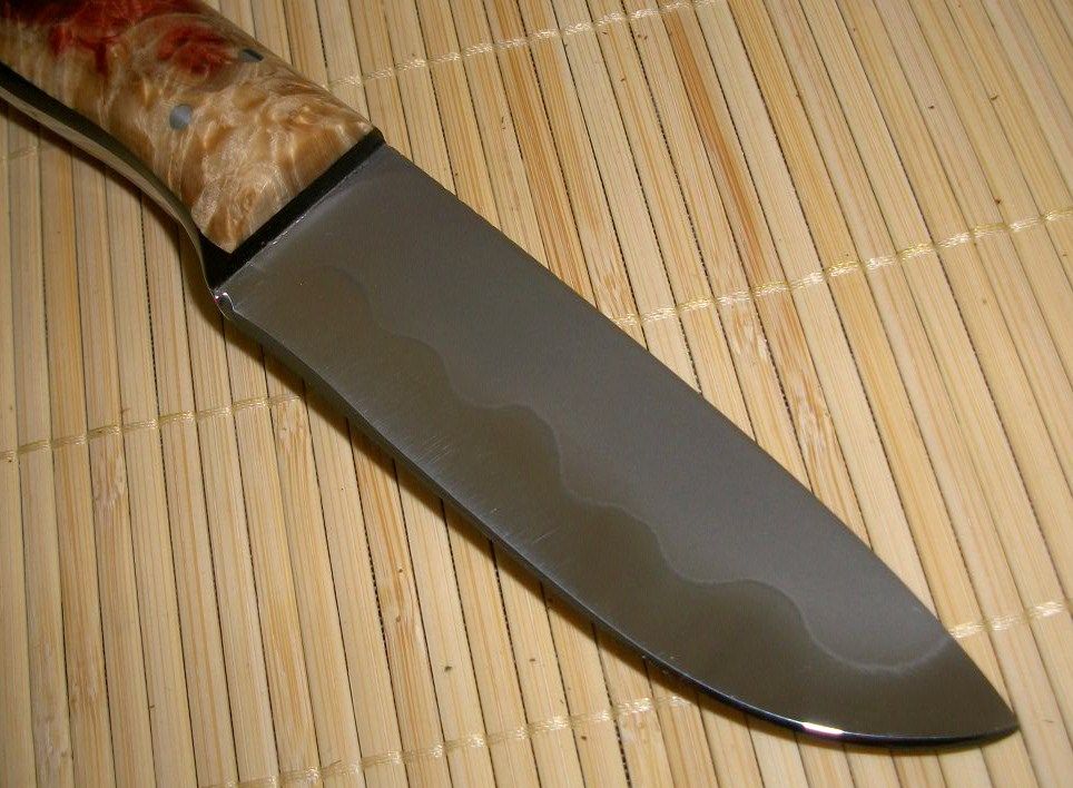

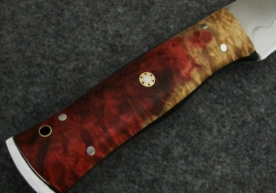

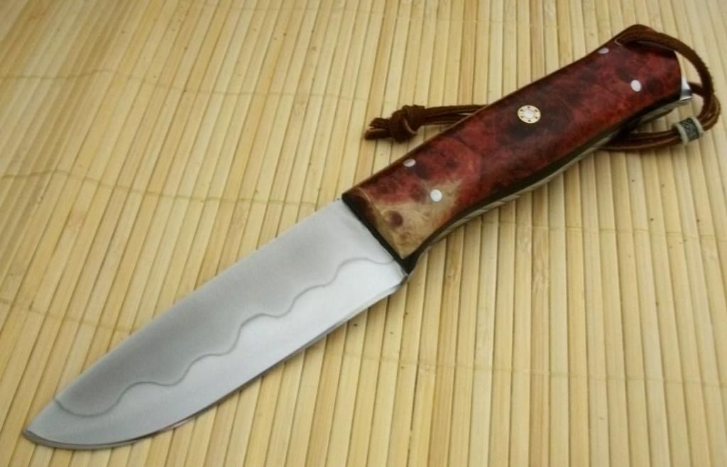

NOW THE KNIFE IS FINNISHED ITS AWAITING LEATHER, I HAD ALOT OF FUN WITH THIS NEW STYLE KNIFE,IT BEING THE FIRST I EVER DONE,HOPE YOU ALL ENJOYED IT ASWELL,WELL CHRIS ITS ALL YOURS MAN,HOPE YOU LIKE IT, THE OVERALL SPECS ON THIS KNIFE ARE
(ALDO BRUNOS) - 1095 STEEL
GRIND- FULL FLAT
CLAY COATED FAST QUENCH FOR THE HAMON , EDGE HARDENED
HANDLES- STABILIZED BOX ELDER BURL WITH BLACK EBONY LINERS
PINS- NICKLE/ MOSAIC AND LANYARD TUBE
THUMB NOTCHING
MEASURES - 9" OVERALL 4.5" CUTTING EDGE
THANKS EVERYONE FOR FOLLOWING THIS THREAD PLEASE ENJOY!
