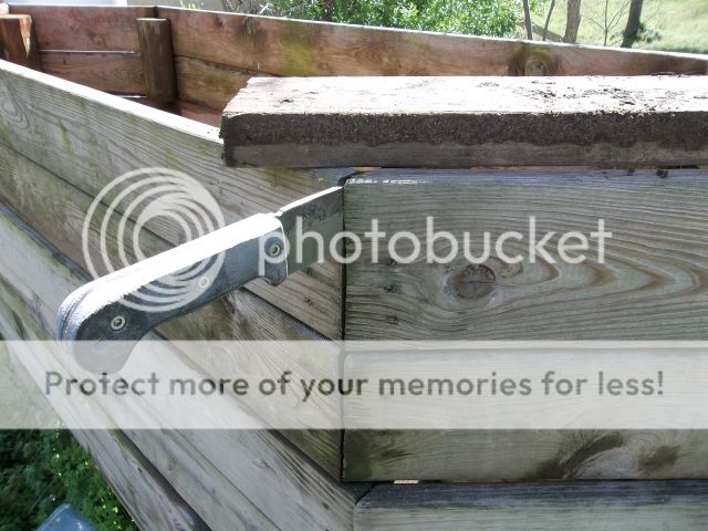

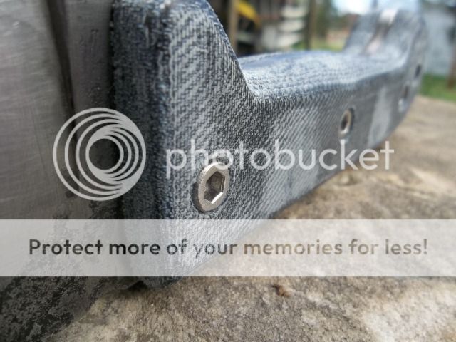

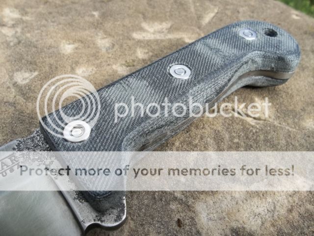

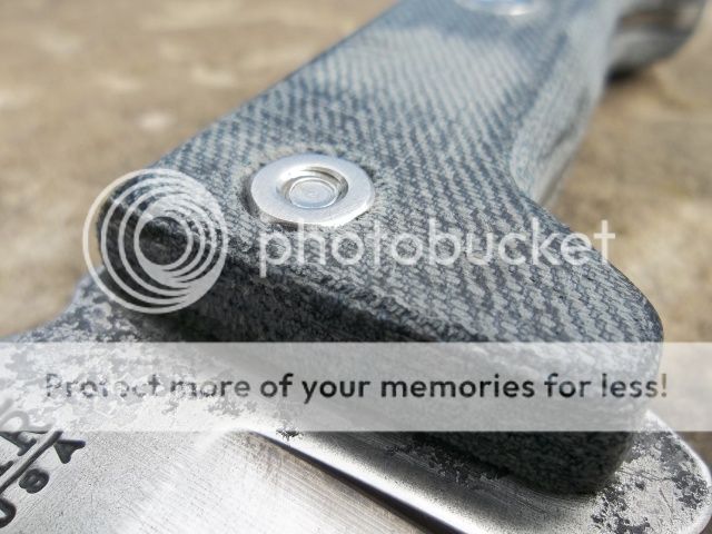

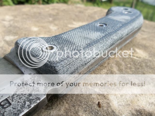

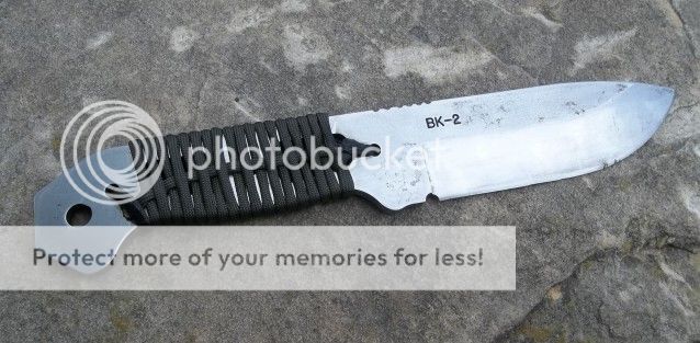

...Not being finished, I Finally gottaroundtuit!
Final contouring/sanding/polishing
used real course grit (50? 80? lower?) to shape, then 100, 150, 220, 3M extra fine sanding sponge, then polished with 000 steel wool.
Hillbilly ''sanding clamp''

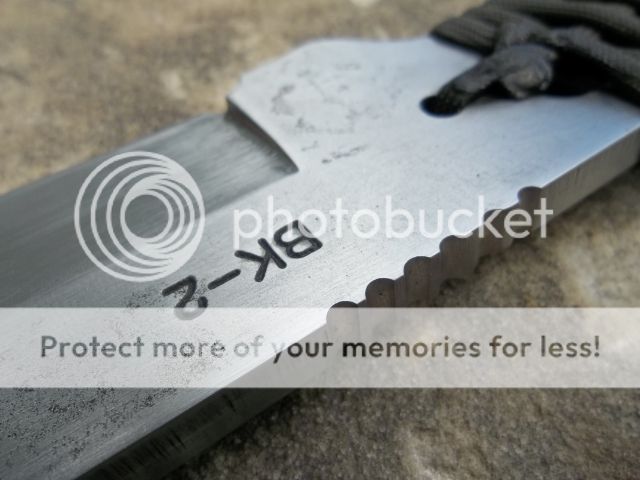

OD 550-Wrapped my 2 last night as well, also lil better shot of the jimping
I know I post a lot of threads...I'm just trying to give Clich a run for his money as ''BK&T post/pic whore'' LMAO

They look great man.
I like the tightly fitted hardware and which side your bolt heads are on. I always planned to put the bolt heads on the right if I ever make any handles.
someone finally noticed! I thought I was the only one who was driven crazy by the fact that the factory grips have the ''ugly'' side of the hardware facing out when carried right-handed! I have no idea why the heck that is so, makes more sense to me to have it other way 'round. Course, I guess the BH-lefties out there Like the factory hardware position.

Looking good. You did an excellent job jimping the 2. Did you use a jeweler's file?
nah, just some file i picked up at a local ma&pa store, they are kinda like harbor freight, cheap junk LOL
was 1.30$ so I cant complain
Hey, whatever works. Did you use a smaller file to get the initial groove, then move to a bigger file, or just use the same one the whole time?
same one, it bites good into that 1095, just use a short firm hard-pressure stroke the first time...get a lil notch to work the file in on subsequent passes. Lot easier to file then SS...i tried it on a cheap winchester knife...damn thing barely shows a mark lol
