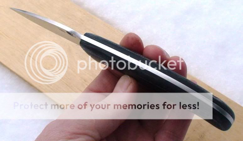

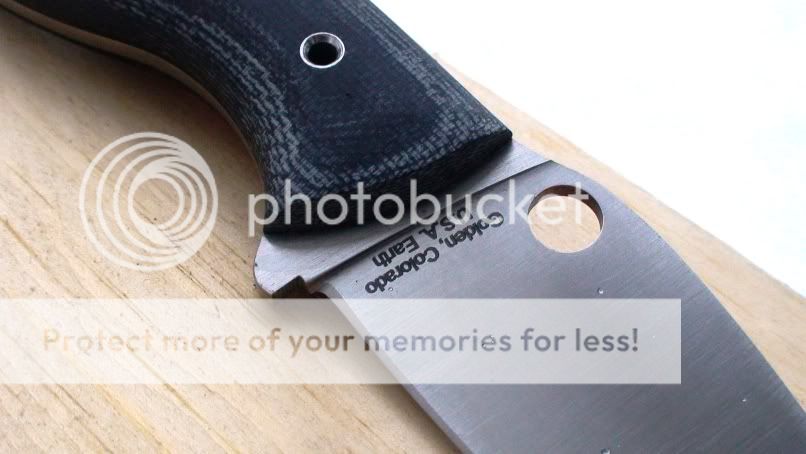

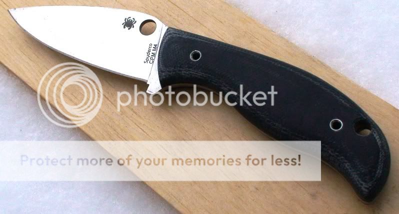

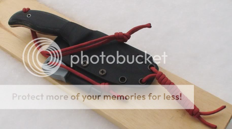

OK...just for Supmonkeyface :D
1/4" black G10, stainless steel tubes. Kydex with firesteel.
