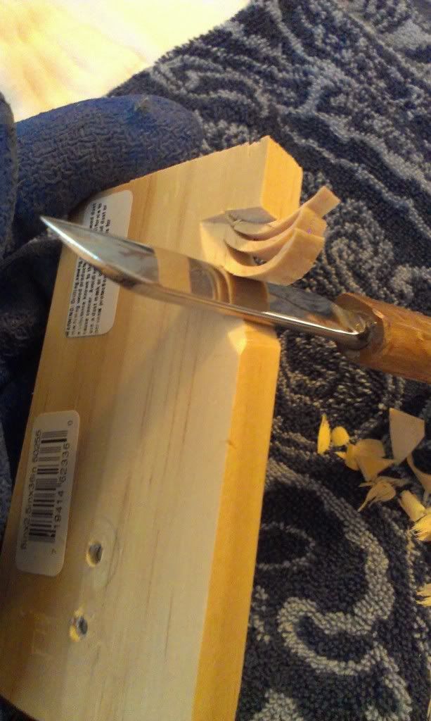

Here's a pic of an Osborne sloyd.
The owner of the pic said that the spine is about 1/16" thick. I think he modified the blade some as well, but the knife does have a 2.5" blade length.

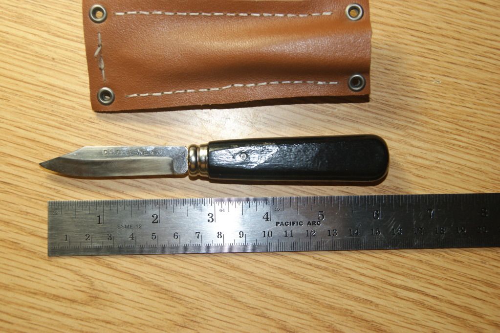

Ah! I have one of those with the two blades! Let me drag them out and do some measuring. The blades I have are shorter than that one pictured. But the handle is basically the same.
Dwayne - that would be awesome. Yes - I have seen those blades where the "handle" portion is much smaller - but with the same hole.

Taking pics very soon but here is what I have so far. I cant find the straight blade that came with my knife, but I do have the curved one. Very high carbon evidently because it rusted badly in the few weeks I've left it alone in my drawer.
Depth of the tang, where I kept it for use is: 1 1/8" but my knife is capable of taking a longer tang.
total length of the blade: 2 3/8" on the dot
width: 11/16ths
EDIT to add: thickness is .03 according to my old caliper.
I'll get more info as I get them together. I wonder what happened to my straight blade!?
