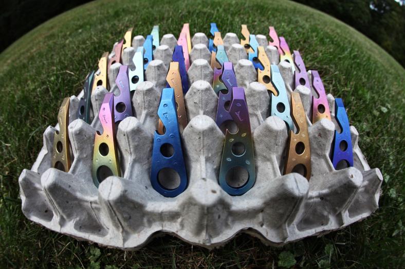

In the kind of project you are describing, my first thought is Peter Atwood.
http://www.atwoodknives.com/
He is using 3/16 154-CM for most of them.
It seems that he is also using Titanium for some
I see no specs, but it looks pretty thick & considering the limited run nature of his products, it's possible that they are all being collected and not used.
You could contact him and ask some specifics.
