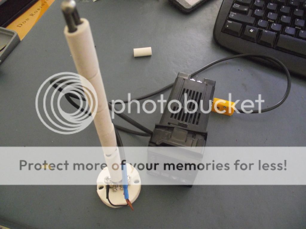

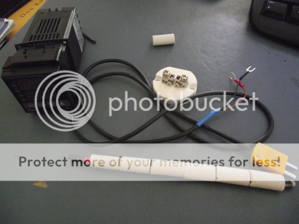

One more thing: I have a PID and Thermocouple which I will be using for monitoring temps. I have these pieces:
I think it goes together like this:
Is this correct?
Also, it requires an AC power supply. Will any old normal power cord work, or do I have to have a specific cord?

Make sure the TC is hooked up with everything by polarity.
I'd slip the end piece/connector off and re-install so your wires are shielded by the ceramic plate.
Other than that the polarity is it. I used an old pigtail off of a garbage disposal for my power. It draws very little power so no need for heavy power supply cords.
I will probably go for a simple power cord. Now, 2 things. 1, is red positive or negative? 2, how would you suggest arranging the wires differently?
You have the TC inserted from the wrong side of the mounting block. The TC goes on the plain side, and the wires go on the side with the screws.
Here is a good mounting method:
Leave about 2" of the TC uncovered by the insulator/spacers. Bend the TC ends at 90° there. Mount the block to the tips.
Drill a hole in the top rear wall of the forge from the back end. The hole should be the size of your ceramic TC sheath ( a ceramic test tube looking protector for the TC). Cement the sheath in the hole with satanite. The tip of the TC sheath should be in the upper part and near the center of the chamber. Close is OK.
Place the TC in the sheath tube all the way. Pack the tube with scraps of K-wool to seal the back. The block with the wires should be out of the way of any flames that come out the back. Use some satanite to seal it up good, locking the TC block in place out of the way. Connect the wires from the TC to the PID. If there is an issue with the back flames of the forge melting the insulation on the TC wires, cover them with a short wrap of k-wool and wrap that in aluminum foil ( make sure not to short the leads). There is high temp TC wire available, too.
