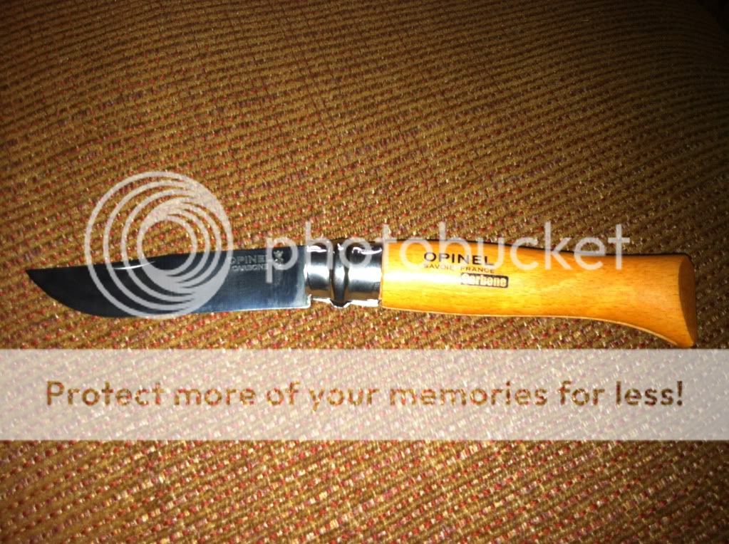

I fold a piece of paper towel over the spine and then wet the paper towel with apple cider vinegar. I then just let this dry completely.
Turns out like this
