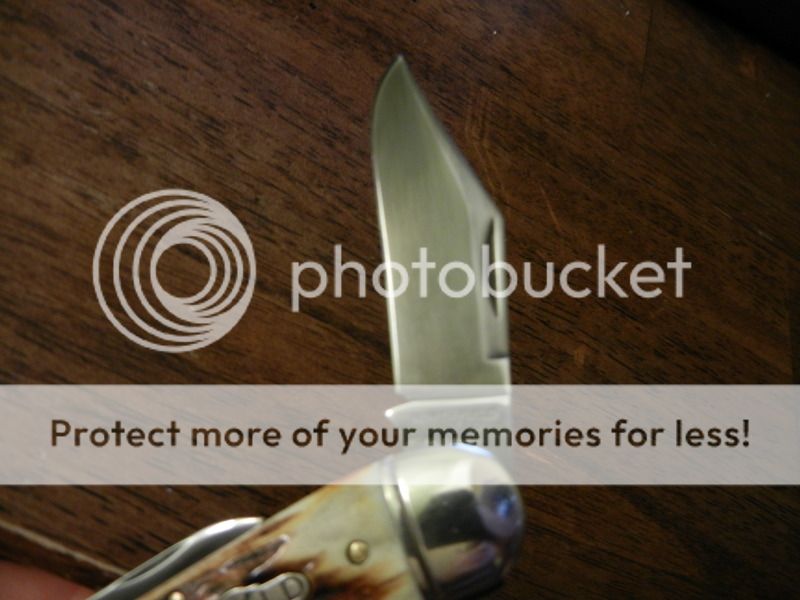

Here's the result after step 5:

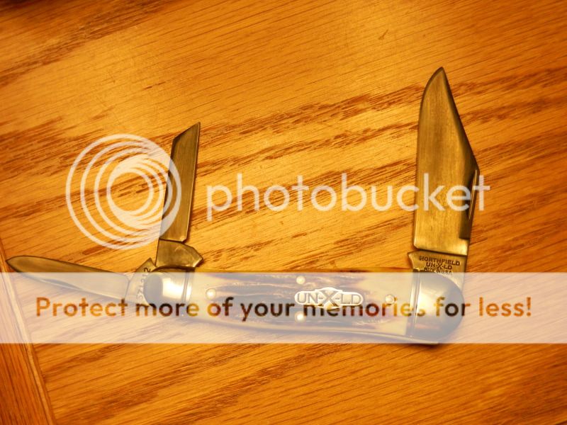

And after step 7:
As you can see it's a lightly polished satin finish similar to a light gun bluing that offers that base protection without being too dark and still allowing for the blades to take-on additional character with normal use.
And after step 7:
