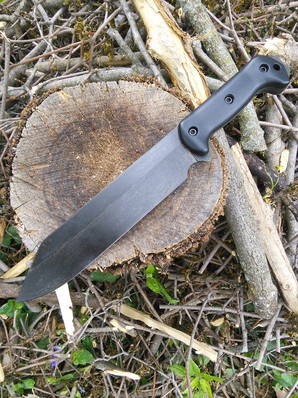

1095 with do more than just take a patina....
Wrap the blade with one layer of vinegar soaked paper towels and let dry. Amount of layers doesn't seem to matter, letting them dry completely on there seems the key.
