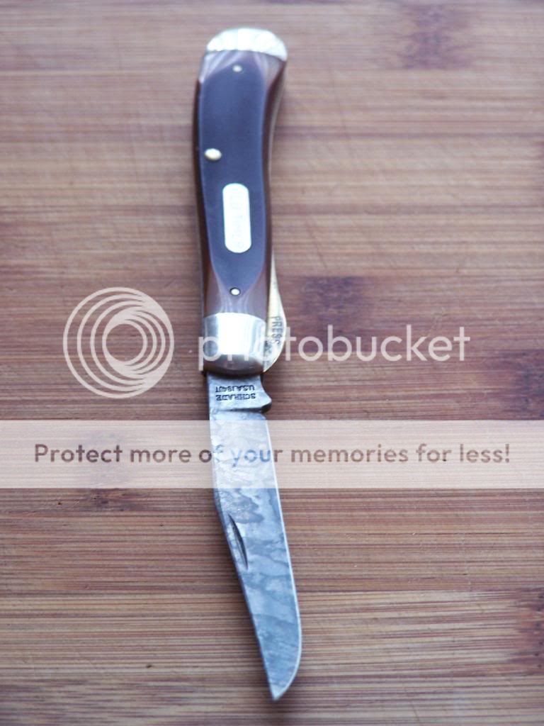

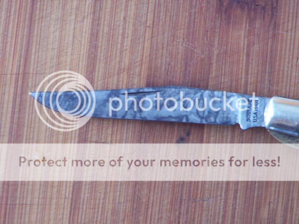

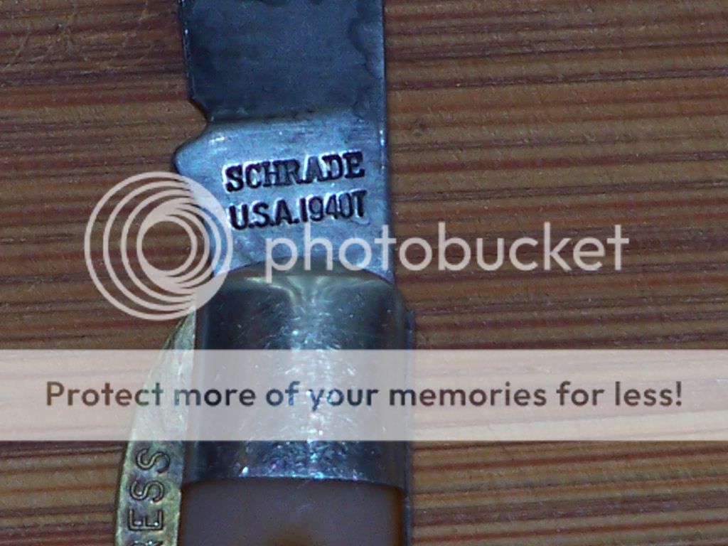

Having noticed my "new" favorite knive, a Schrade 1940T, was getting a patina on the blade, and knowing this is inevitable outcome for a carbon blade, I figured I would take control and give it my own patina....I started with slicing into an apple, with ok results, but not the striking colors I wanted...so I tried a potato but got hungry and ate the potatoes before I could get a good color...then I remembered cutting a pineapple with my 1971 vintage Craftsman Boy Scout's knife and my "horror" when the blade wasn't shiny anymore...so I pulled a can of cut pineapple from the pantry and skewered four pieces of pineapple onto the blade of my 1940T for three hours and got this "Tiger Stripe" pattern.....VIOLA!!!! got the colors and pattern I was looking for..
let me know what you think....
Looks great! I did an earned patina on one Case CV knife by using it fairly frequently for fruit slicing (strawberries give a lovely rainbow patina), and a forced patina using hot apple cider vinegar on a different knife. The vinegar was uniformly dark and even, the fruit slicer had a more varied and interesting pattern, though it seemed like each new apple would overwrite the previous patterns with its own.
