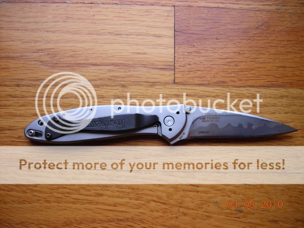

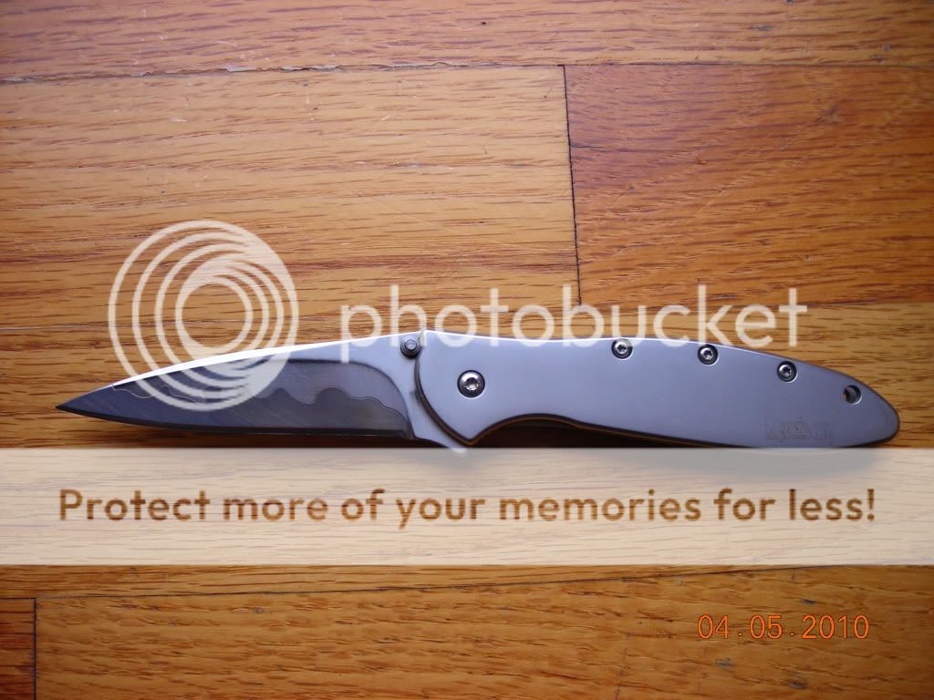

I just darkened the patina on my Leek. I was cleaning the coffee pot with vinegar and just set the clean blade in the filter and ran 6 cups of vinegar though. All done in 5 mins, the hot acidic steam really sped the process up. I did turn the blade over about 1/2 way though the brew cycle.
This the same knife from my post above and the D-2 part of the blade was very light colored. The pictures were take before the blade was oiled. The color is more even after the oil.
I wonder if Kershaw could have switched from D2 to CPM D2. The CPM process effects how the chromium is bonded in the steel and I guess leaves a lot more free chromium to act as a rust inhibitor. CPM D2 is supposed to be much more rust resistant than regular D2, which doesn't rust all that easily to begin with. CPM D2 is more along the lines of stainless steel when it comes to rust.
Since a patina relies on a layer of oxidation if it doesn't want to stain then there is not going to be much of an effect on the color. Also, if the steel was finished to a higher polish there would be less imperfections on the surface where oxidation has a place to 'attach' and start the oxidation process.
