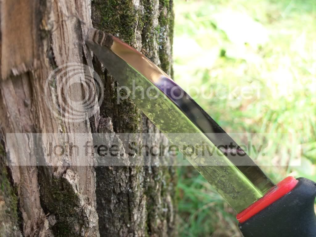

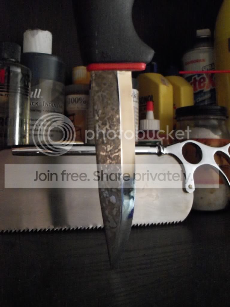

Last week I decided to try out some forced patinas. I did my Mora and an Opinel no.7. I think they came out pretty well for a first try so I wanted to share with you guys. Forgot to oil them for the pics, but the oil really brings out the shapes and color. Tell me what you think?

Very cool patina dude and nice mirror edge on that mora. What did you use?

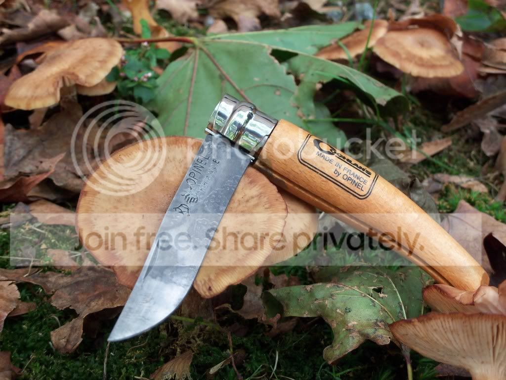

This is a #10, mostly mustard, and the occasional apple. Where did you get a Coghlans Opinel? Canadian tire (a DIY/box store) used to carry them years ago, does anyone carry them now? is the price comparable to regular Opinels? I know they arent special but I thought if they got them on a big contract they might be cheaper.

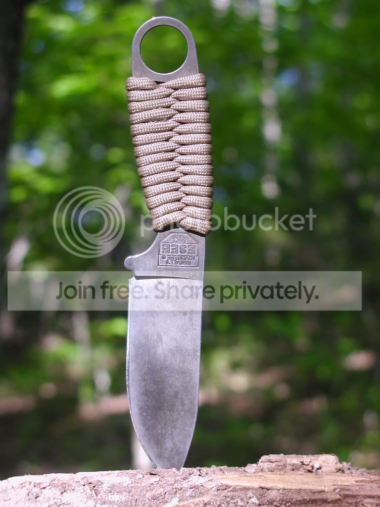

That mora is nice. Here's a couple I no longer have. The light kind of washed it out a bit but you get the idea. The top one is forced, the bottom one is natural.

I used a 1 x30 grinder all the way up to .25 micron then leather. I did do a bit of cutting with it before the pics so there are some scratches here and there.
As far as where I got the opinel...I don't remember....Sorry! I got it online somewhere and honestly I didnt know there was more than one kind haha.

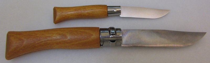

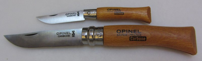

Opinel No. 7 w/ patina. Opinel No. 4 w/o patina for comparison.
Took about half an hour cutting grapes. I set the knife on towel with the blade edge facing up. Had a bunch of grapes in a bowl, and I'd cut each in half before eating (did this while watching an half-hour sitcom). This was the result.
This did significantly eat the edge of the knife though. Towards the end of the show, the knife edge wasn't even able to pierce through the grape skin without a little bit of a push. Easily remedied with a few passes over a sharpening steel...
[edit]Updated pics - finished making the patina on that last 1/4" near the tang[/edit]
