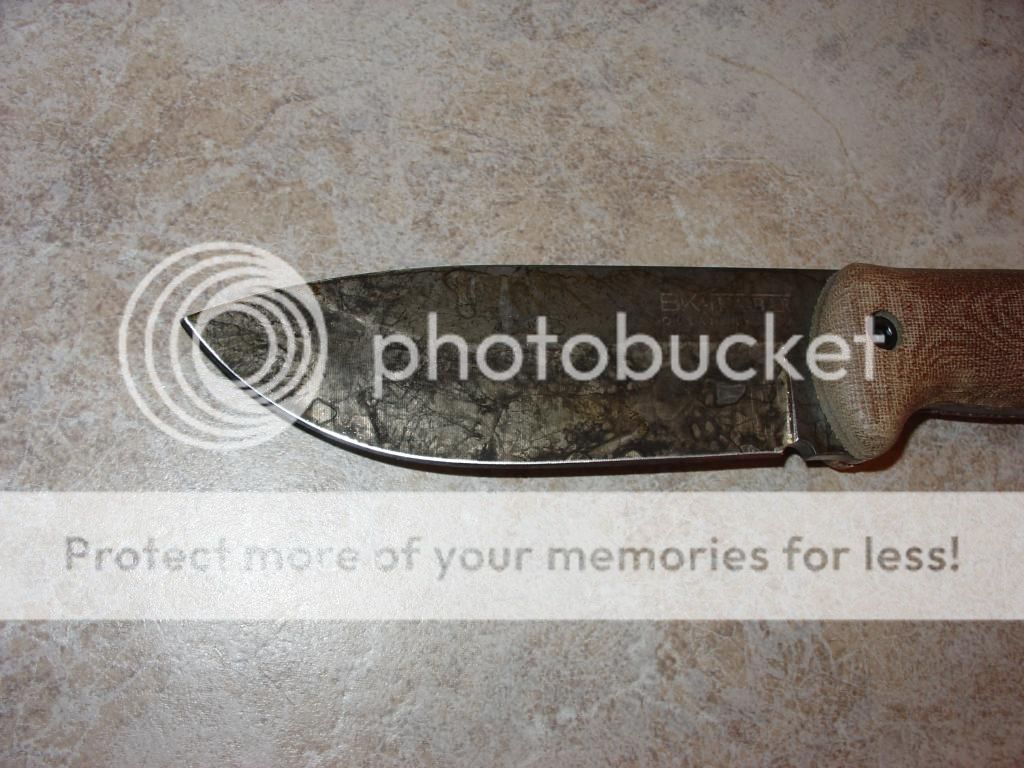

Grapefruit is also a good thing to use. This isn't my knife, but the patina looks about the same as mine.
All you have to do is soak he blade in vinegar and boom patina iv even seen some people use hot vinegar to speed up the Process.

Almost any food acid will do it. I've done it with grapes, pickle juice or vinegar, mostly on a 1095 blade (Schrade 8OT). The results of the pickle juice patina are seen in pics below. I soaked a piece of paper towel in the juice, then wrapped it around the blade. Left it in place for a couple hours, which was longer than really necessary; it produced some significant rust on the blade, which I scrubbed away with baking soda. No deep pitting or other real harm done, but the surface rust produced was a bit of a surprise. :eek: Moral of the story: it doesn't take long, and keep an eye on it.
I've also tinkered with what I call my 'coffee pot patina', using a heated mix of 1 part vinegar to 2 parts water, at about 180°F. I did this spur-of-the-moment, on a whim, after running the vinegar/water mix through the coffee maker to de-calcify it. Just 'dipped' the blade into the pot of hot liquid, held for maybe 30 seconds or so, and repeated 2 or 3 additional times. Blade turned nearly black in doing this. Rinsed the blade in cool water, then scrubbed with baking soda to stop the acidic reaction and remove any red rust that might be created in the process. The baking soda cleanup will remove a lot of the really dark/black oxide, leaving a nice grey behind. Then rinse it thoroughly again. This is a pretty good way to make the patina more even, and the color is very similar to the pics above, but with less spotting/patterning on the blade.
