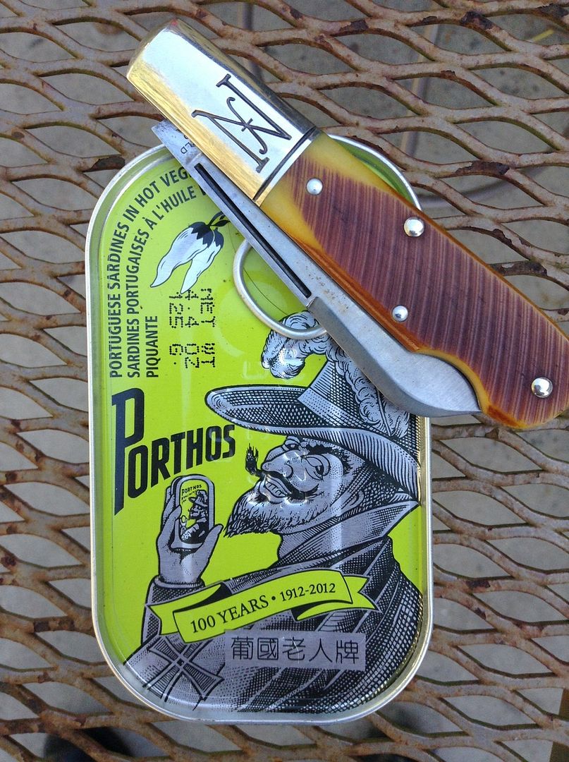

I need help what product do you recommend to force a patina on this blade and does anyone have a guide so I don't overdo it.
Here a pic of the knife want to earn it but I am to afraid of rust so I think it's time

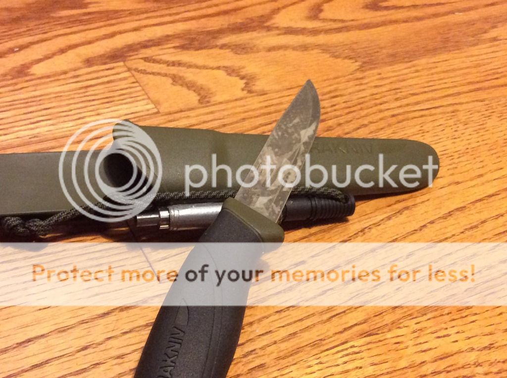

Here is a 6 stage patina using vinegar onion lemon all twice and Seperatly looks great
