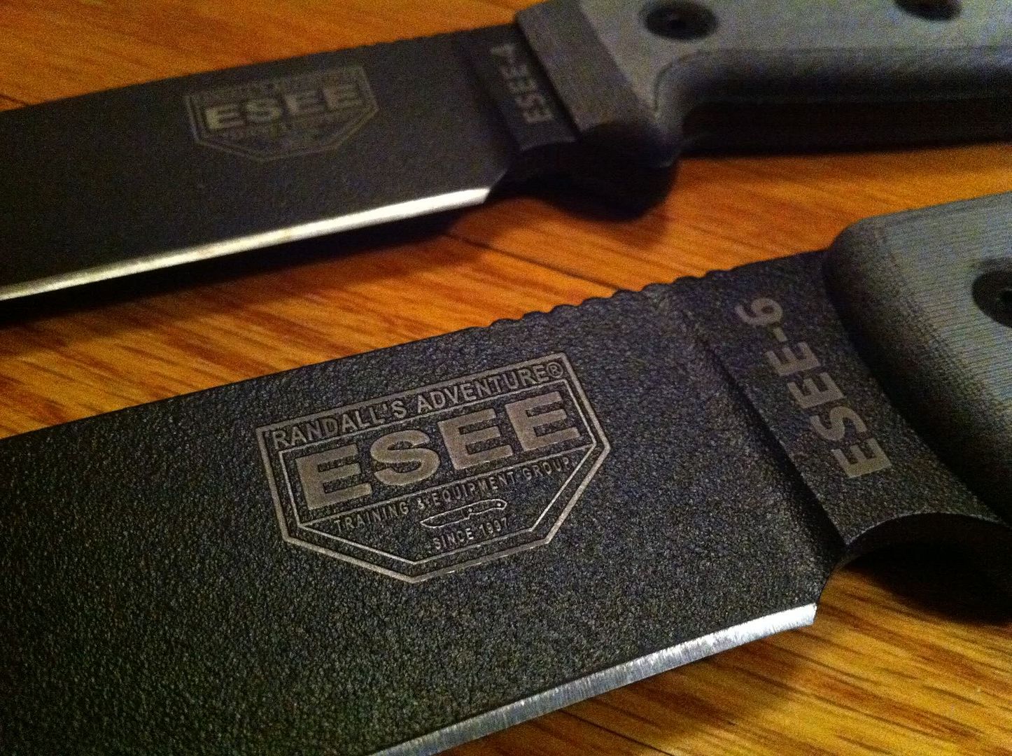

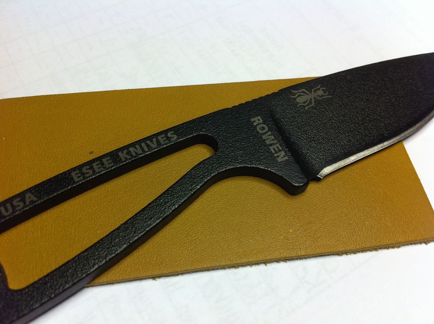

I used lime juice let me upload a pic...
**EDIT**
Here is what I did. I sliced a lime and just wiped the lime over the laser etchings once about every 5 min for an hour, I got a nice dark gray patina.
That looks really nice. I think I'd rather do that than a patina.
I wonder how it would look against OD green though.
Probably pretty good, it just won't have the contrast that it does with the sand color.
Pea-Ta's Gray looks great with the Black and would probably look good with the OD too.
The Blue looks excellent with the Sand though. :)
You guys are some creative thinkers..... :thumbup: ;)
I just got my 6 today and decided to lime the laser etchings along with my 4, this was done like my Izula. Sliced lime in half and wiped etchings about every 5 min for an hour.
