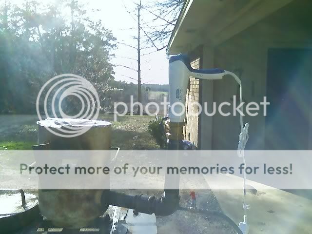

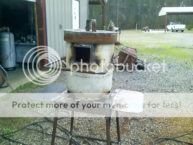

Anyone ever consider using a bathroom exhaust fan for a blower? I won't say who has been using one for several years but there's a fable in these parts about a bald headed, gray bearded oldman thats got one set up and it purrs just like a kitten.
What ever works Right! 2" pipe with 2" gate valve then 2" pvc
Rusty McDonald,
Is that a vertical forge or a crucible furnace?
