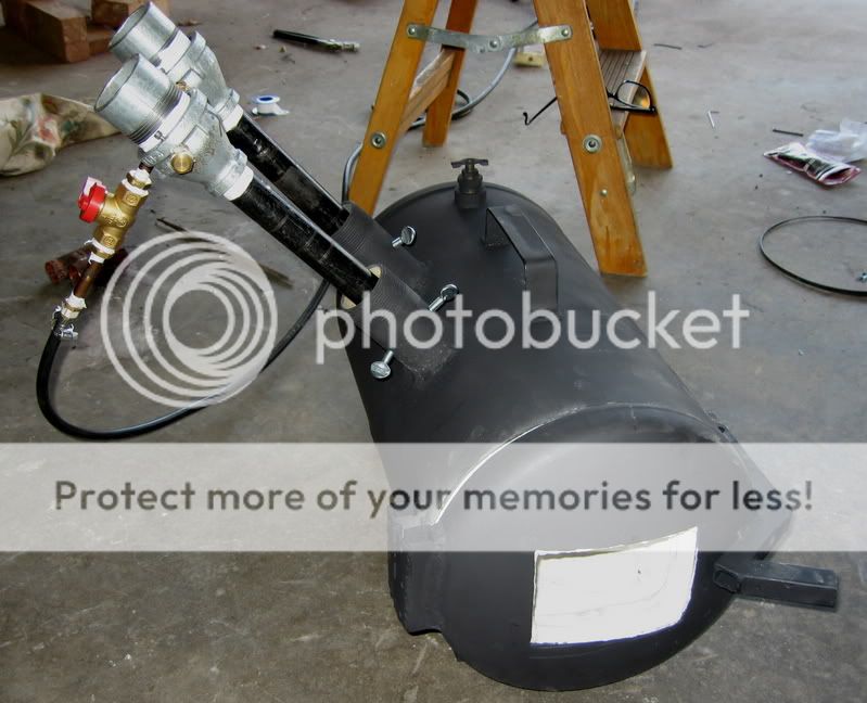

Hey there, I finished my forge today, how do you go about breaking it in? I coated it with Plistix 900 about an hour ago, anything special?

turn it on and adjust the mix so the flame stays just inside the forge so you get a neutral atmosphere. thats if your using a blown burner. otherwise just turn it on. also where are the pics of your forge? we all want to see it.

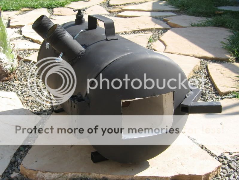

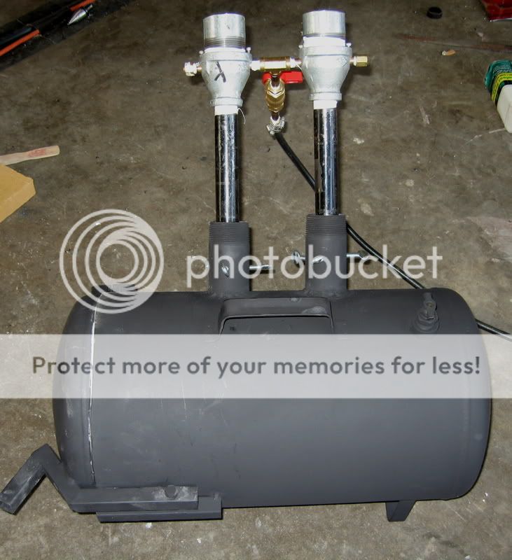

Here it is, I still have to redo the burners with pipe dope instead of teflon tape and yes, the inlets into the tank are galvanized pipe, (too lazy to go back and get other pipe) I did melt and grind it all off inside and out before welding, with my breathing apparatus on. The reason I used this tank is I quit racing motorcycles 20 years ago and didn't need the air tank for the track anymore, just sitting on the shelf in the garage. Burners are thanks to Ron Reils ideas, awesome! Thank you for everyones input and help on this project! I used 1/4" kaowool (got a deal on it, 25' X 24" for $31 rather than 5 sq. feet of 1" for $40.00) wrapped around 8 times so it's 2" thick then coated it with plistix 900, which is supposed to be a cheaper alternative to the ITC 100. The inside is 16" long with a diameter of 6". Thanks for looking.
just fire it up and hope the zinc fumes dont kill you cause they will take forever to burn off. you seriously need to replace them with blackpipe before you kill yourself.
The burner tubes for the venturi burner dont need to be taped at all, just where you're carrying propane under pressure. The rear of the burner is just an inlet for air for the venturi effect of the high pressure gas being shot down the tube in the oposite direction (into the forge), and the pipe you're shooting the propane into does not hold any presurized gas, and thus also doesnt need to be taped. That can save you a bit of time. The location of the galvanized nipples and reducers is just fine, as that area should never be getting to high temperatures anywhere near the point that zinc melts, let alone boils. (that is unless the pipes you've already welded to the tank and have your bolt holes thorugh are zinc, those can certainly get hot enough. It's not good to weld galvanized pipe either for the same reasons)

I am sorry, being new to this blacksmithing hobby I had no idea about Paw Paw, I googled it and am sorry to hear about that unfortunate accident and to all that knew him.:foot: I do wear a p100 at all times and do this outdoors but now find I am holding my breath even with the respirator on! I fired that thing up and nearly melted a leaf spring in less than 5 minutes! Holy smoke!!!!! Then I did a really dumb thing when the flame started surging down low, it started burning back up the burner tube, back to the drawing board! I reached over and grabbed one of the shiny new thumb screws with no glove (DUH!) to adjust the burner Yowie!
if you feel that it is safe and dont wish to change it then by all means go for it. i do see one flaw in your design of your burners tho. you have them pointed directly into the forge and not at an angle to make the heat swirl around and you will get hot spots and uneven heat. you might want to still cut them off and weld them in at an angle to make your forge more efficient. will also lesson the chance of the flame shooting back up into the burner tube.
With venturi burners, you have to maintain enough pressure to prevent the flame from burning back in the tube.
Yeah, darnit! Now you got me thinking, pretty easy to cut 'em off and start again, but what about the shiny new paint!:D
Hi Bulb, You might be able to turn your burners down a bit by putting a 'choke' on the air intakes. It's just a plate on a pivot to close down the opening, then you probably can run a lower pressure and turn the temp down without the backing up (maybe?). Nice forge, try it with just the front burner and see what happens.
