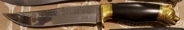

Why?... Well, I have three knives that have a blade finish texture which I have wondered how it was achieved.
I have thought that maybe it was done during forging, with some left behind for this look... But, I have also thought that maybe it was done using some other process that involved no forging at all.
What would you guys say is the case?
(All three knives I speak of have this same finish)...

View attachment 1868075View attachment 1868074
Hard to tell from the photos, but almost looks like it might've been "applied" at some point?
Roselli knives, at least those in Krupp W75 (similar to O1) have some of the scale left on. Good knives, all function.

Forgive my ignorance, but how would it be applied, if/when it is not done by forging? Thanks in advance 👍
I'm just spitballing, but maybe introduced as one would a maker's mark prior to heat treatment. Although you'd think there would be identifiable, repeating patterns. Don't get me wrong, I have a number of knives with minimal brut du forge treatment that I'm very fond of; what little scale remains is a decorative/artistic element that (hopefully) won't compromise the integrity of the blade. Of course a fully dressed out and finished blade can still fail due to HT or abusive use. A blade fully covered in scale, while appealing to some is a bit like having a cloak thrown over the knives.

I'm just spitballing, but maybe introduced as one would a maker's mark prior to heat treatment. Although you'd think there would be identifiable, repeating patterns. Don't get me wrong, I have a number of knives with this treatment that I'm very fond of, and display the remaing scale as a decorative/artistic element that (hopefully) won't compromise the integrity of the blade. Of course a fully dressed out and finished blade can still fail due to HT or abusive use. A blade fully covered in scale, while appealing to some is a bit like having a cloak thrown over the knives.
Thanks for your input 👍
I guess I may never know for sure 🤔
