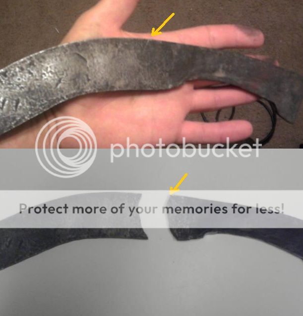

Aldo's 1084- An absolute blessing to forge with, after those pesky leaf-springs! I've forged a few nice blades from Aldo's 5160, but this is my first time with 1084.
Not bad, eh? Normalized 3 times, quenched in water, tempered at 450 for 90 minutes. Dropped it on the ground, aaaaaaaaand....
Dang!!! So closer inspection is called for....
Grain looks fine, but what are these brown spots? Did I overheat it, or forge it too cold?
Edit: I use raw wood in my forge. Eucalyptus, seasoned for a couple years, turned to charcoal in my redneck forge as I forge.
Well, I can't really see much with the fuzzy pics of the cross section, but it's a wonder it didn't shatter during or right after the quench. Water is too too fast for 1084. Especially straight tepid water. Even with appropriate steel, proper water/brine temps, cracks or breaks happen. I'm fairly certain that your poor khuk barely survived the quench to begin with, had a major stress crack, either obvious or internal, and dropping it just saved you some later heart ache if you'd progressed to finishing it further.
1084 is more appropriately quenched in fast or medium oil. Canola will work fine for a start, and can be had inexpensively. I use Parks 50, and usually hit max hardness without trying hard.
Unless you saw sparks popping off it at bright high yellow to white hot, overheating isn't the issue, although you could still have excessive grain growth. I cant ttell from the pics.
Try oil, and your next results should be fine.. Who told you to use water bro?
I just figured it'd work. Sorry for the low-qual pics. There's a huge brown spot in the steel where the blade broke- does that indicate anything?
The brown is rust, water got into the crack when you quenched it and it broke the rest of the way when you dropped it.

Yup the blade cracked from the water quench (the discolored portion of the cross section)...but methinks there is another issue here as well. The knife should not have broke in half when dropped, even with the crack. Perhaps your knife is not hitting the right temp during tempering? If it had hit 450, I doubt it would have broke when hitting the floor. Typically the area behind the crack will have just as much strength as the rest of the knife so something is amiss.
Domestic oven temperatures are notoriously inaccurate, get yourself a stand alone oven thermometer to be sure of the tempering. The brown is where it cracked. If you forged it too cold it may have put some microcracks into the steel which formed a stress riser on quench.
Normal tempering would be at temperature for 2 hours, twice. A test piece of 1084 that I did with an edge quench in water cracked all over the edge, but after two hours twice, smacking it on the anvil has produced no new cracks.

1) An edge quench in water will cause the steel to bend away from the edge (hence the curve on katana) in the case of a kuk the steel will try to force itself apart. Oil would cause it to bend the other way.
2) If you didn't get the tempering regime right, what makes you think your normalising was up to scratch? That kuk had a lot of metal moved about and presumably had a lot of internal stresses built up from forging.
3) Brine, although a faster quench than water, is safer due to less cavitation and better heat transfer.
4) Unless you were going for a clayed hamon there was no need at all to do a water quench.
On the picture there is also a noticeable crack line starting from the edge
