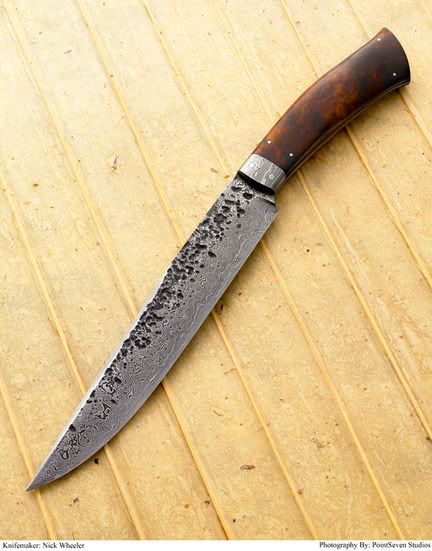

Not AT ALL comparing my work to Don's, but this is an example of forged in texture with a texturing die.
Stippling is another interesting technique for texturing forged.Have a Jerome Anders that the exposed thong hole tang is stippled as well as the ferrule. :thumbup: :cool:

So is a texturing die pretty small and just randomly applied while forging? It seems pretty random and not a die in a rolling press or anything that would repeat a set pattern.
