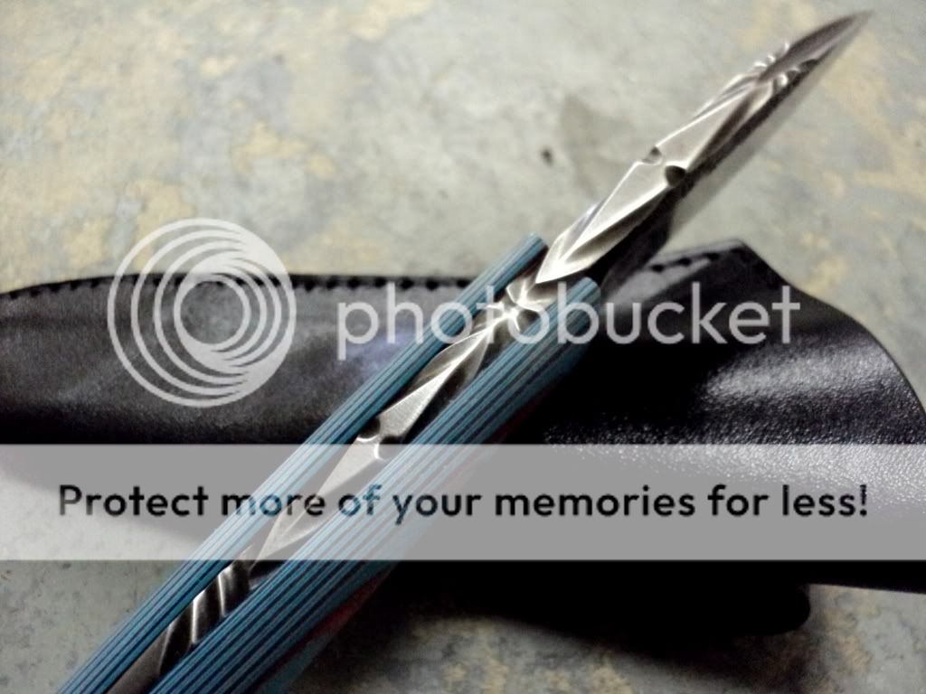

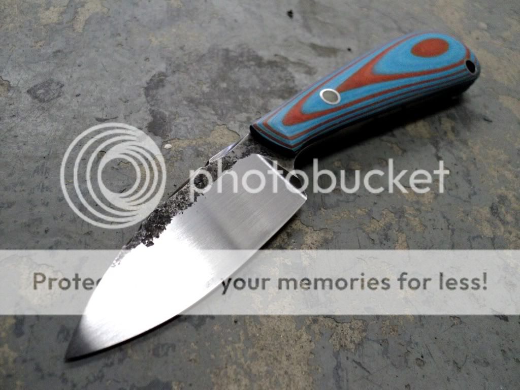

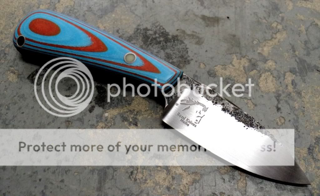

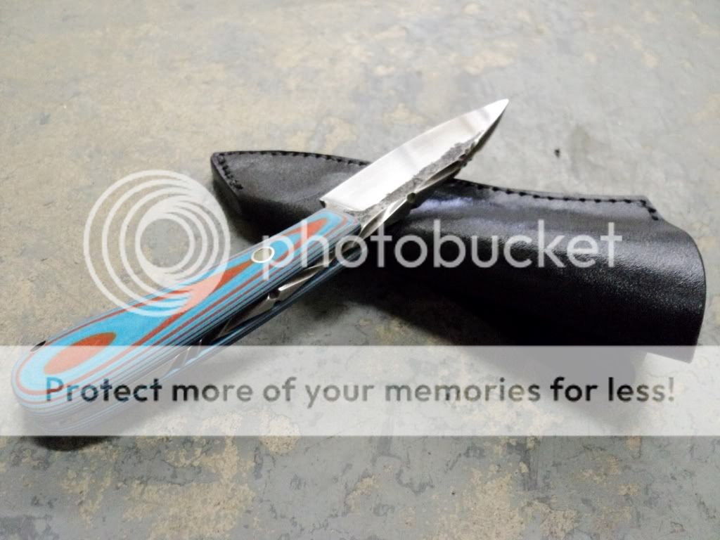

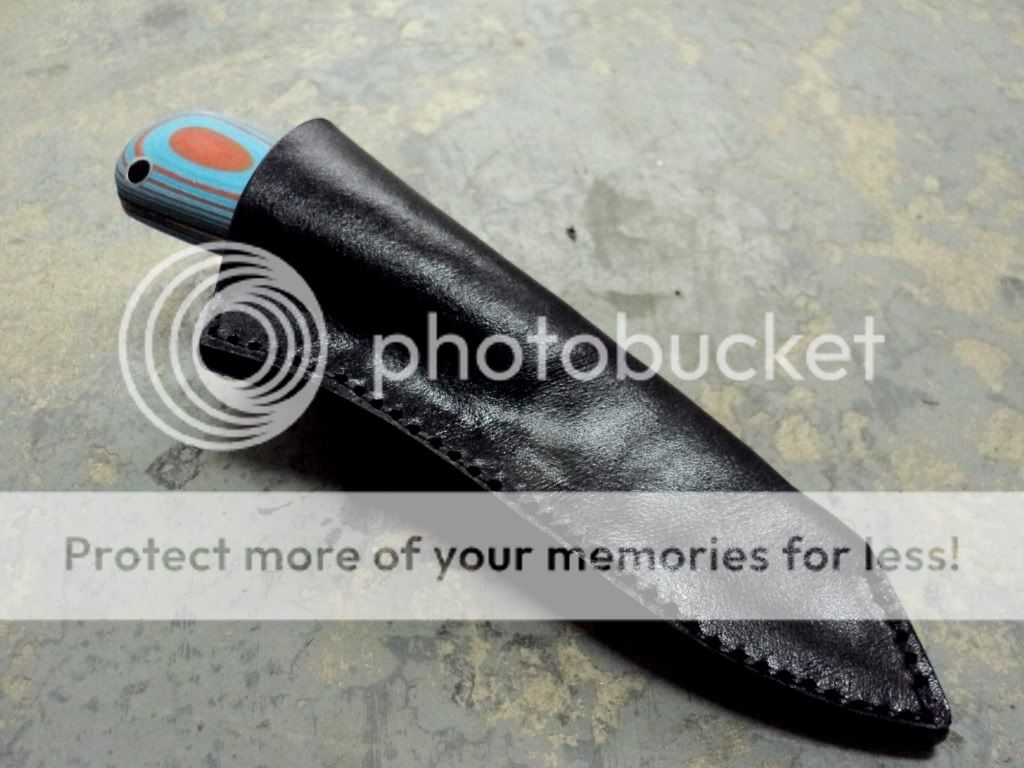

Hey Custom Knife Fans,
This was a piece that I had been chipping away at for a while. I decided to finish her up for the Mystic CT knife show. The steel is forged 1084M, 0.240 at the thickest with full distal tapers. The filework is Fuegen inspired and the "Gulf Porsche" colored laminate is by Ben Sweet. The forward pin is filled with aqua Europium glow powder and in the dark, is nearly the same color as the blue in the handle. The edges of the tang and filework were left with the HT finish.
This is pretty much exactly what I would make myself for an EDC fixed blade.
Thanks for looking!
Nick
