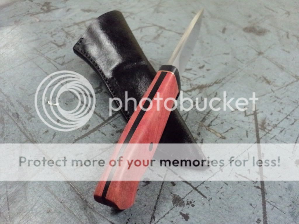

Hey Custom Knife Fans,
This was another project that I have been working on piece by piece for a while. It has a forged 1084M blade with a G10 frame and Pink Ivory slabs. The tang is very beefy. The G10 frame is tapered and held together with 4 SS pins and then attached to the tang with a single Micarta pin. The spacer is copper.
This one will be on display the 27th along with some of my other work at J. Dostie's Jewlery for the Annual Lewiston-Auburn art walk. I was delighted that the orginization was so enthusiastic to have a knifemaker along with the local painters, sculptors and photographers.
Love to hear some comments!
