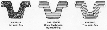

Noooooooooooooooooo. How do we allways come full circle back to forging vs stock removial. Alot of you guys probably know my stance one this. But I will lay it out one more time. Does forging blades to shape make them stronger then blades ground to shape, yes. But is it any amount that we would beable to notice and test for, don’t know. But what I do know is steel has a grain and that grain runs in the direction it was rolled or forged. When you grind a blade to shape your cutting through that grain. When you forge you move the grain inline with the profile. This is the reasion things like hooks and other life saving things are forged. The industry has found that these items when forged to shape are stronger. I had found a paper awhile back that talked about it. Also a test we are all familiar with that tests toughness requires the grain to be running lengthwise through the coupon.
So to just flat out say forging is not any better is false. But on the other hand if you don’t have the skills needed to do it right then it can be worse. Oh and in my search for research I had come across a paper talking about forging and that the high alloy steels like D2 benefit more from forging then the simple carbon steels. I wish I would have saved that paper.

Just gonna leave this hereView attachment 1154206
Nice, you making "U" shaped knives in D2?
That diagram shows how drop forging applies to complex parts like crane hooks but not knives being hand hammered out in D2.
Those lines are called "grain flow" or "grain direction" but it's actually carbide stringers. If a steel has sufficient carbide volume and size especially in a non PM steel those carbides will be elogated with rolling.
The grains themselves can change size with time and heat. The grains are actually being blown up with forging tempertures which need to be reduced after forging and before austenizing and quenching.
While the carbide stringers can be aligned with the shape of the tip if your doing 20-30 heats to do it and not using good temperture control you are most likely just decarbing the steel and adding cracks and blowing up the structure for no reason.
So I'm not sure I'd be bragging about adding strength to D2 with forging. Most likely it's being ruined without attention to detail with little to gain.
There are some dudes that go through the trouble to forge and make excellent knives but it's the sum of all parts not the forging itself.
I'd be more concerned with the protocols and process control than forged vs not forged.
