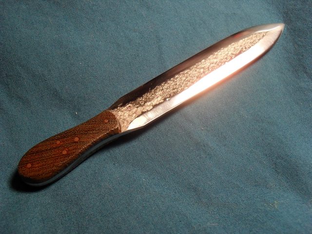

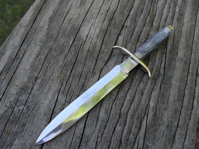

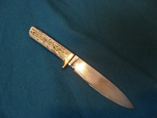

I've forged quite a few of the miniatures I've made over the years. The only real trick is getting it from the heat to the anvil fast enough. One solution was to use a propane torch for the heating, and a and a pair of needle nosed pliers.
Yep, most all of mine are forged. The hawk and belt knife I gave away last year were forged from scrap. Like mentioned, I use a propane or mapp torch next to a small anvil and get a couple good blows in before needing to reheat.
