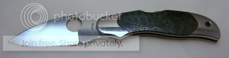

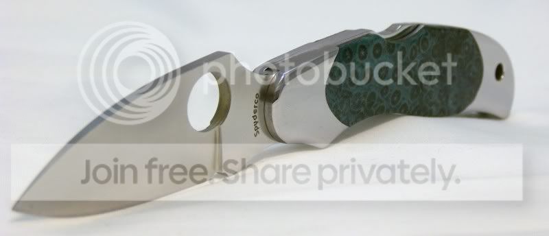

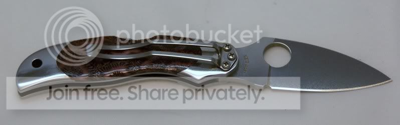

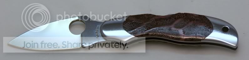

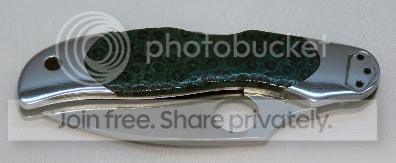

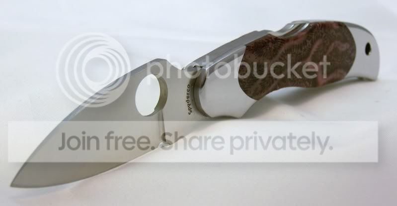

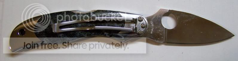

OK guys, this was the hardest one to make. a member on the spyderco forum asked me to do a few kopa conversions back in april IIRC. the materials were blue mammoth tooth and coral. the coral turned out to be to difficult to work with. it would just fall apart when i sanded it and if it didnt there would a ton of voids in the material, it was like pumice. Anyways i contacted him and we agreed on using redwood burl as an alternate material. Well this has been thorn in my side since then and i am very stubborn. i think i figured out how to make it work, it took about 4 times the amount of labor to do it but i am pretty happy with the results. again, not the best pics but my lightbox still hasn't arrived. i offered the kinife to him or to pay what he did for the coral. if he doesnt bite, this one is definitely staying in my collection.
BRAIN CORAL KOPA
thanks and all is well, i just took the summer off to spend more time with the kids.
Glad to hear all is well. Question on the coral you used, was it the one in the images above or the standard red coral? I remember when Iw as in my late teens and early 20s, I dabbled in silversmithing. I made pendants, rings, watch bands out of silver and used turquoise and red coral. I would get batches of turquoise & coral that weren't stabilized properly from time to time and it was impossible to work with. It would literally fall apart on the buffing wheel.
i believe the coral came from fineturnage.com the outer layer was stabilized but it didn't go very deep so i would sand a lil, then epoxy...repeat alot.;)

i dont think it will be too delicate with all the epoxy on it. as far as grip this thing is pretty smooth now. i went up to 600 grit wet sanding it before i polished it on the buffer. i have over 20 custom kopas now, they stay in the drawer for the most part and i take different ones out when a dressier knife is needed. i think i have 2 or 3 more to do before i am done with all the extras that i have, then i will have to move on to a different model.

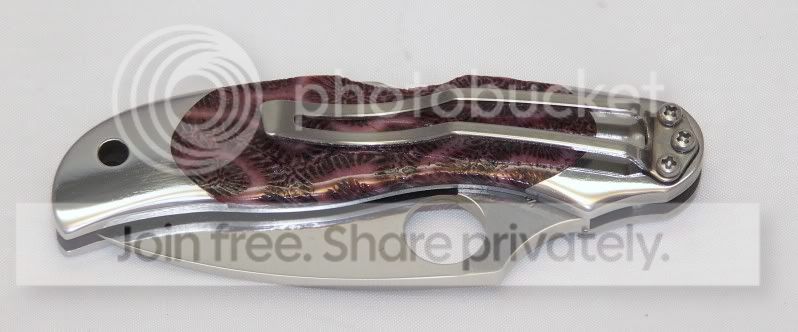

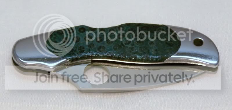

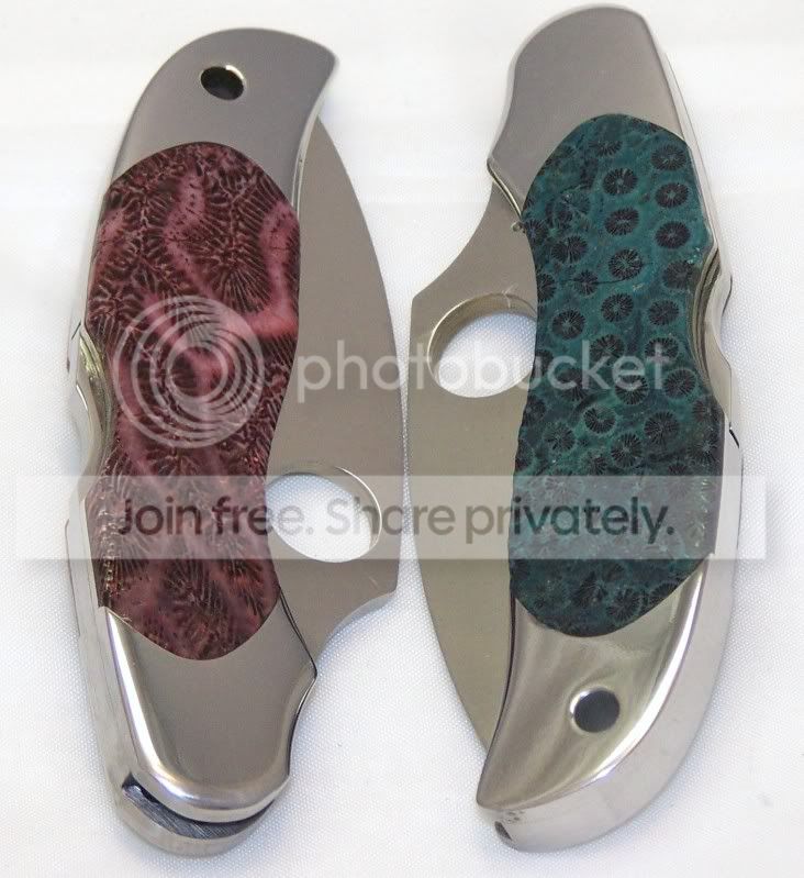

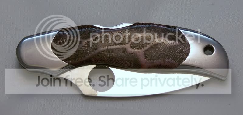

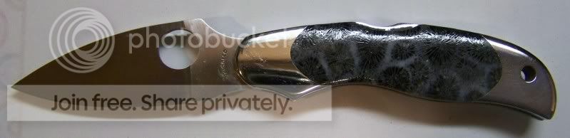

OK, since the last and my first coral kopa got picked up by the original owner i needed to make some for myself. here is the first one. i left the clip off for the pics because i think that side looks better IMO, that always seems to be the case. you can see a small fisure on the non-clip side in certain angles, that is the way it came. the material it is fossilized dyed coral, hope you like it.

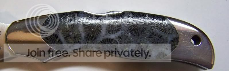

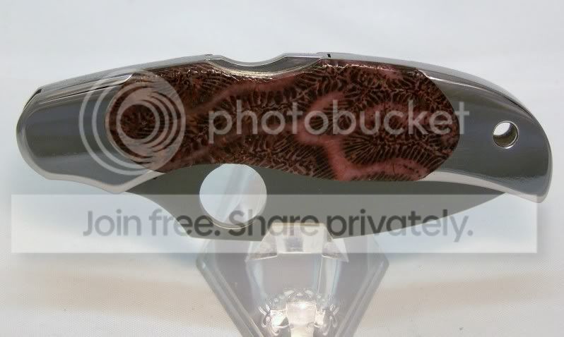

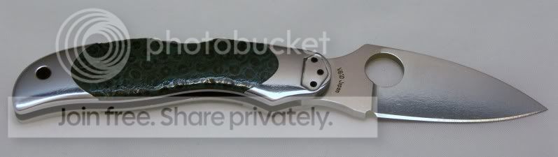

here is one more fossilized corral. i need to work on the lighting because the color in the pictures isn't as vibrant compared to looking at it in person.
EDIT: group pic
