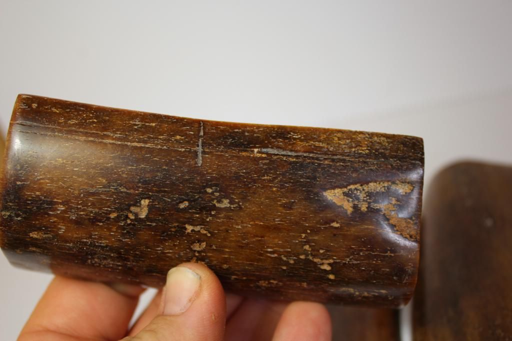

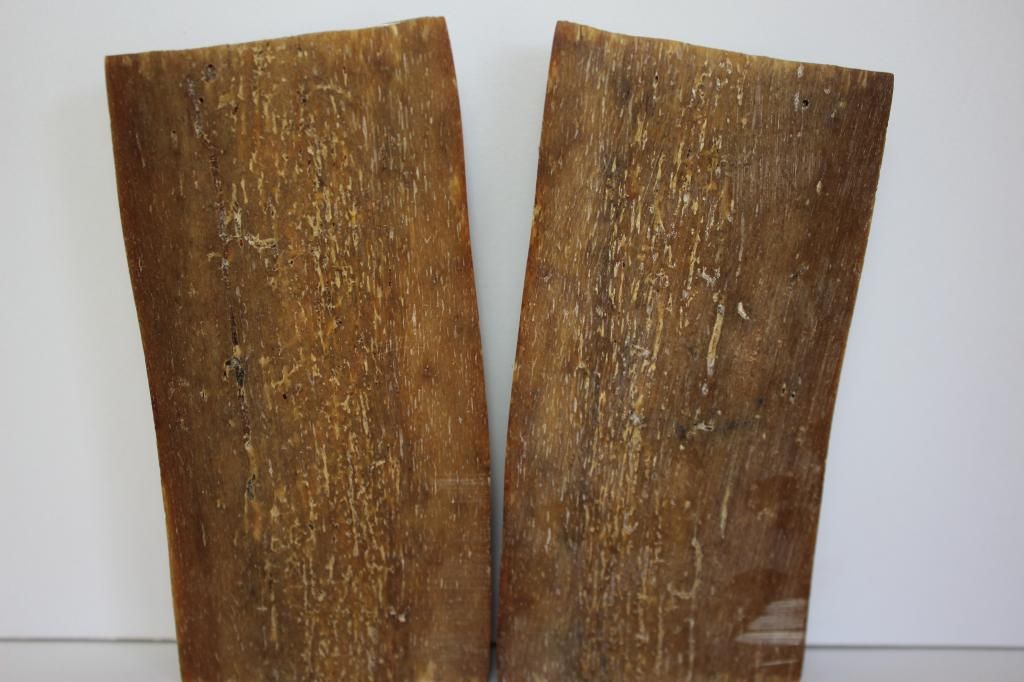

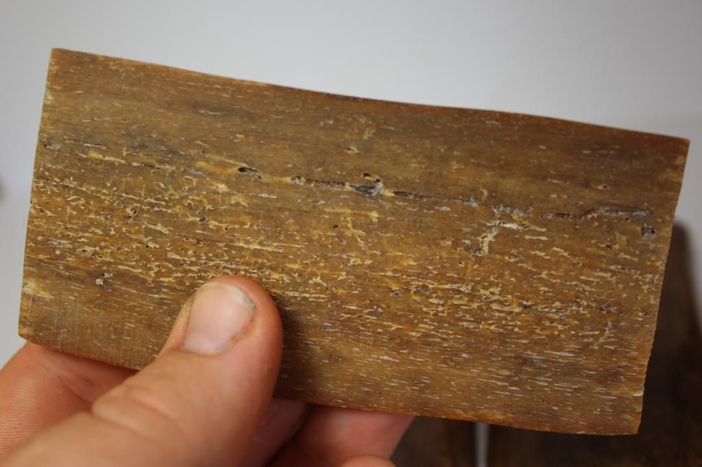

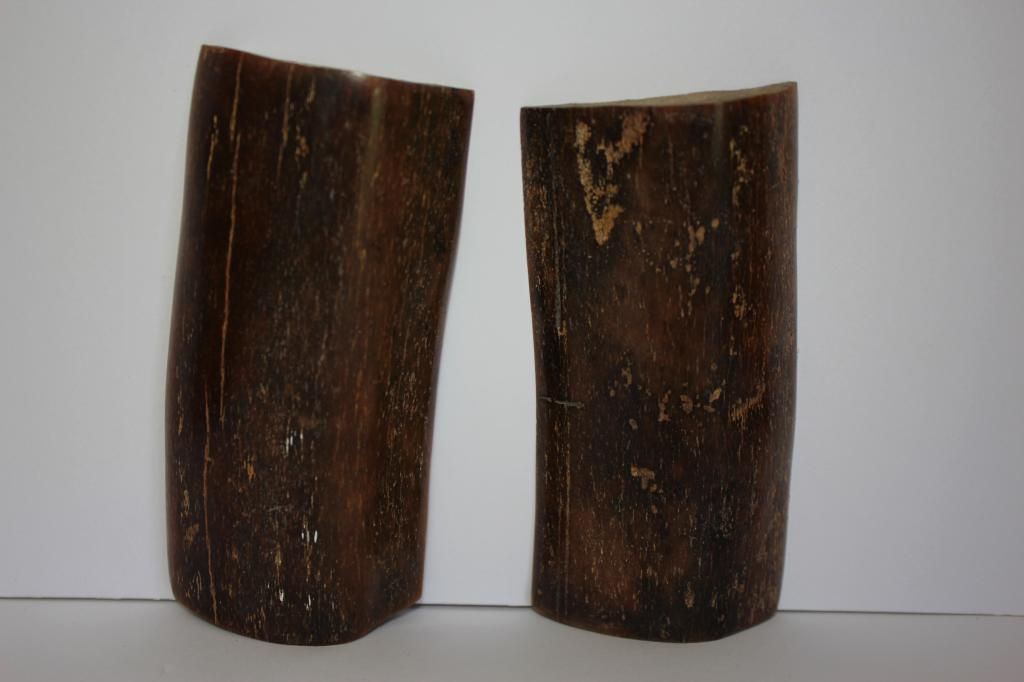

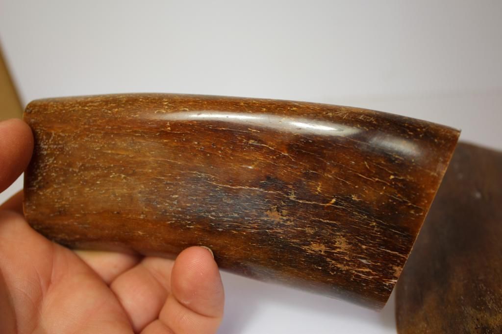

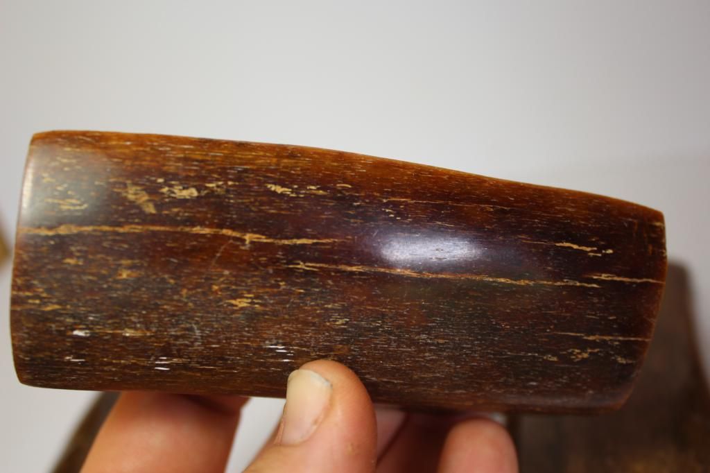

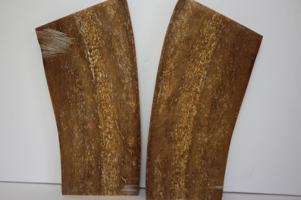

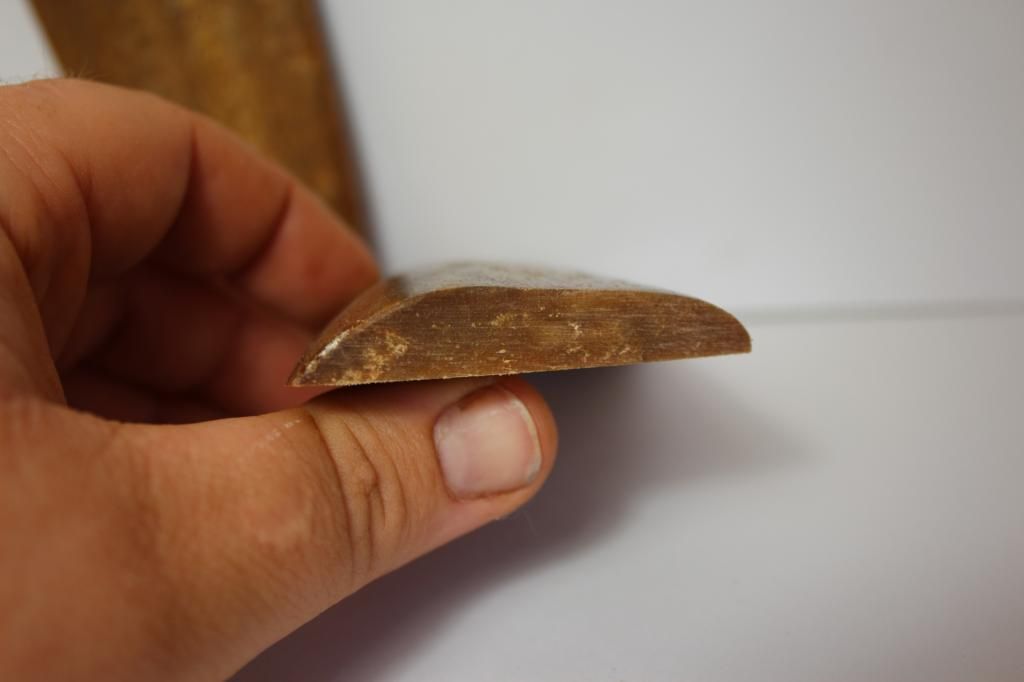

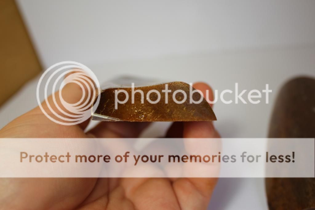

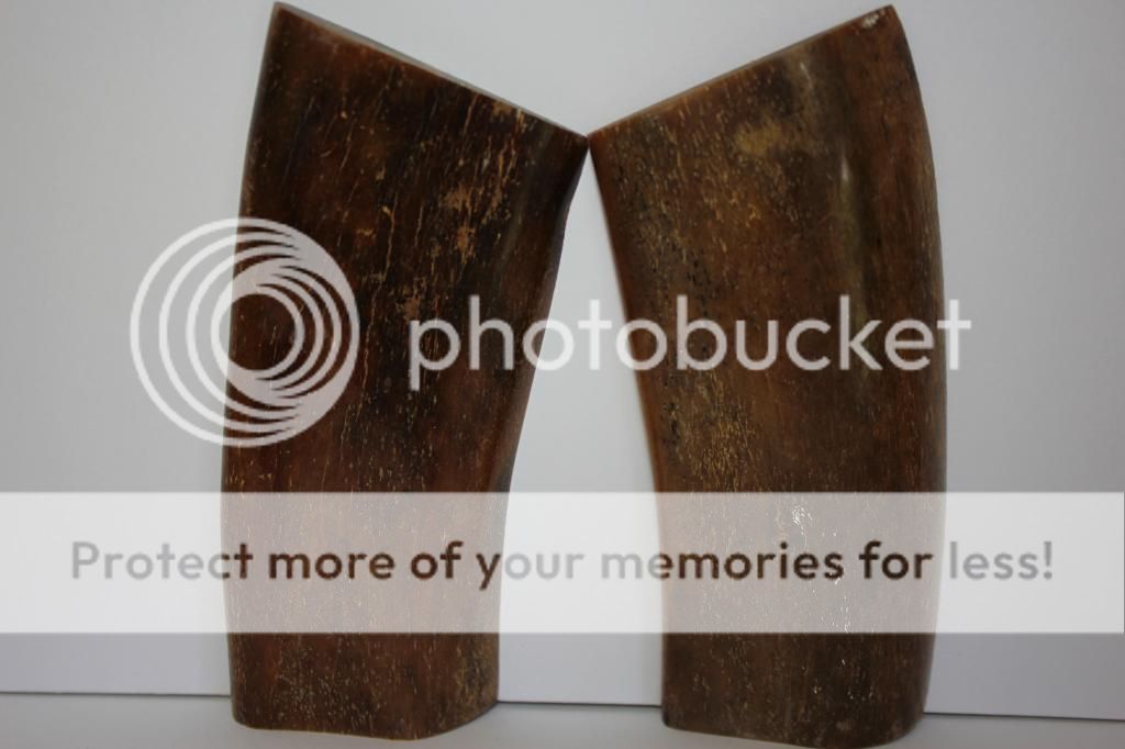

I've been off the forum for a while and just now saw the new reply's,
Mark, the pieces were sold to me as Whale rib Bones, never having worked with whale bone before I just took his word for it. i'll take some pictures of them tomorrow and post them up, I'd love to know what it is for sure if possible.
once again I appreciate everyone sharing their Knowledge and advice!
Yep, those look like ancient whale bone to me, and some very good pieces at that. Those will look great.
The gap between law and justice grows greater every year. Reading through the (largely stupid) sheer number of regulations regarding restricted types of bone and ivory make it readily apparent why the black market is so huge.
Those do look great! Can't wait to see the finished product.
Fossilized and perfectly legal. Nice looking scales. Work it with fresh belts...and go slow.
Anyone know how "Hippo" ivory is classified? Does it fall in the same category?
Hippo is currently a non-regulated ivory, and clearly identifiable from other ivories.
BTW, I meant to comment on the fossil slabs. They could be whale, sea cow, walrus, or even mammoth. Once brown and mineralized it is nearly impossible to tell one from the other without a microscope. I have a bunch of nearly identical mammoth scales that could be twins for that set.
No, I would say that they are whale for these reasons,
Too big for walrus.
Because many of them are perfect book matches and because of the shape and the curvature they can not be mammoth leg bone.
They are too big for mammoth rib bone and the bone wall is too thick to be mammoth rib bone.
They could be Steller Sea Cow but the cross section of sea cow is triangular (that's what I am told by people that study these things) and I have never seen sea cow curve in that direction. These have a flat curve as apposed to a compound curve.
Anyway good stuff and legal to use. The reason I want to make clear the distinction is because interstate commerce of whale bone is not legal, it is legal with all the other things mentioned. I would not want to see another friend of ours get his butt in a jam.
All the best, Mark
