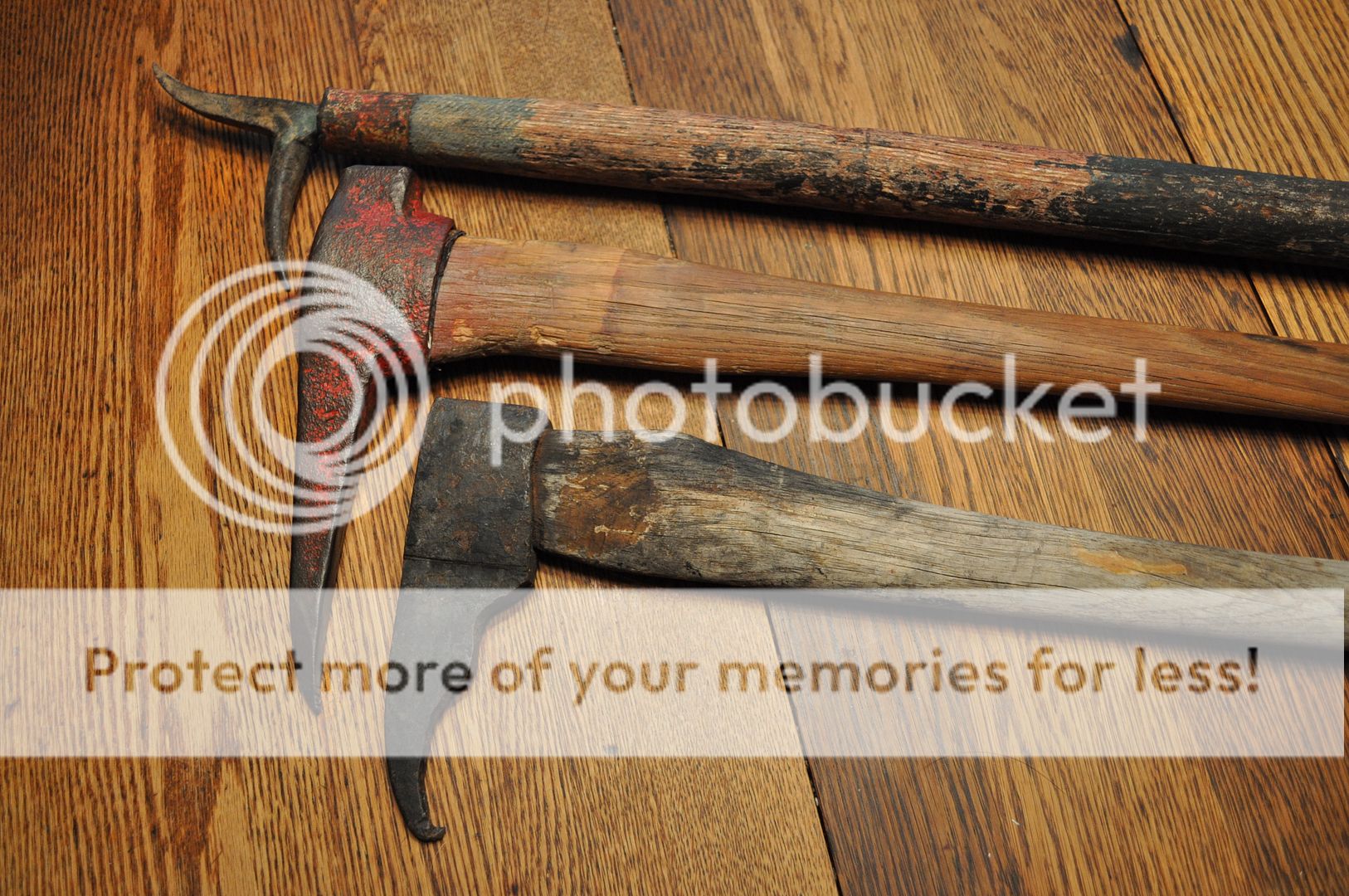

I have one in my collection, a single bit modified to be a pickaroon. It's the one on the upper left side.

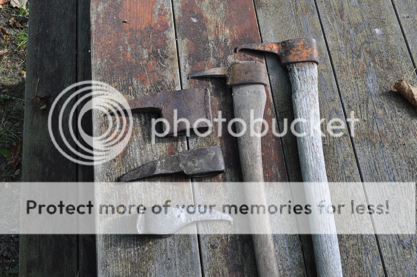

A few other pickaroons
You've got an axaroon!
