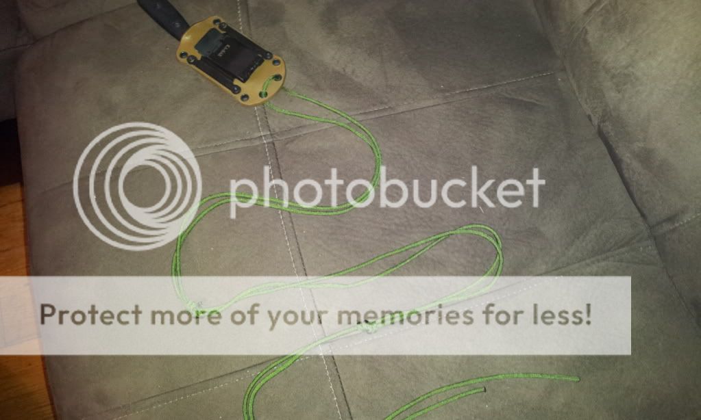

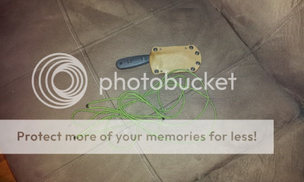

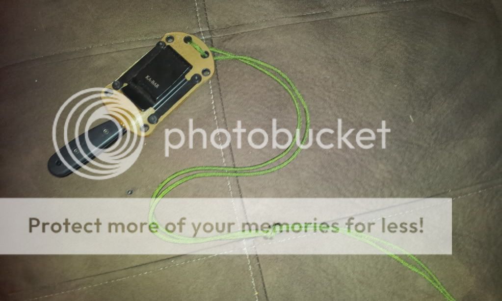

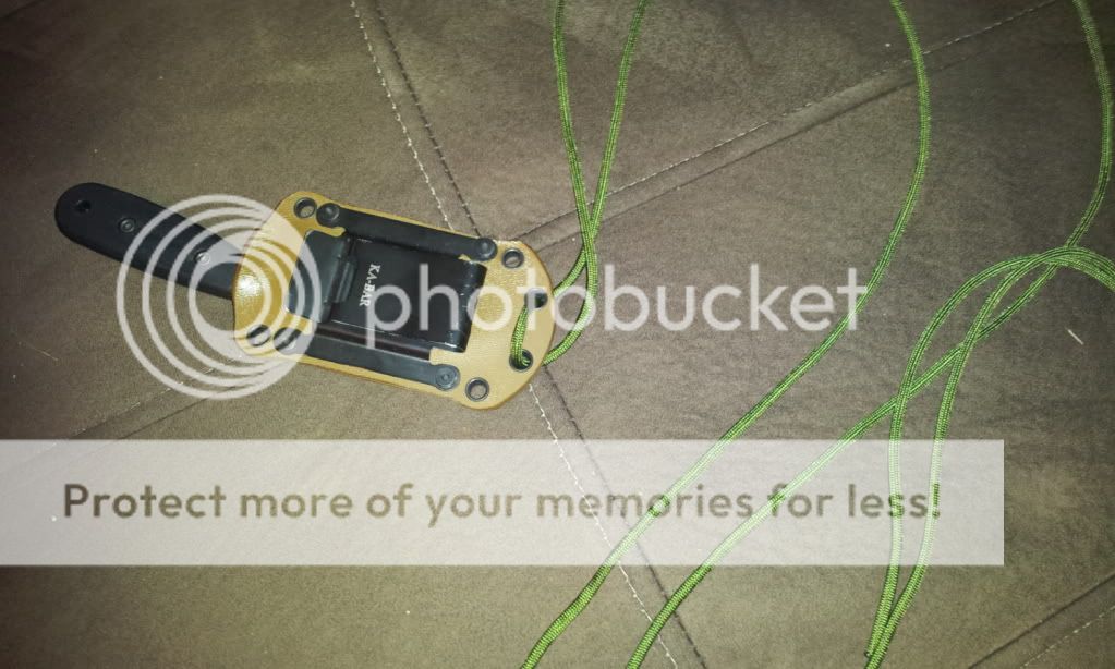

You make a shoulder holster system for it, out of some paracord. If you wear a jacket, then, its gone, but easily retrieved, even when sitting.
I start with 9' of paracord.
Run it through the 2 bottom eyelets in the sheath.
Then, you're gonna want to tie a knot about an elbow length back.
Then, tie another knot another elbow's length, so there is 2 knots.
Slip your arms through the loops you just made, like a jacket, then, tie off the opposite end from the knife, to your belt. You just made a shoulder holster.

I know it's kinda off topic, but Moose, is that a kydex sheath made to look stock?
Ok.
Mwtic
:D
LMAO!!!
Is there anything else, you wanted to know, Nix? Coyote brown, patterned after the original, but the opening was sized to fit the zytel.
I'm not very fond of it, I screwed up on the heat near the top, and shined up the kydex. But, its just a work in progress, I plan on doing another in OD, that's is more to my liking.

I think, from the pictures, you did a pretty nice job on it. How many more are you planning on making?
